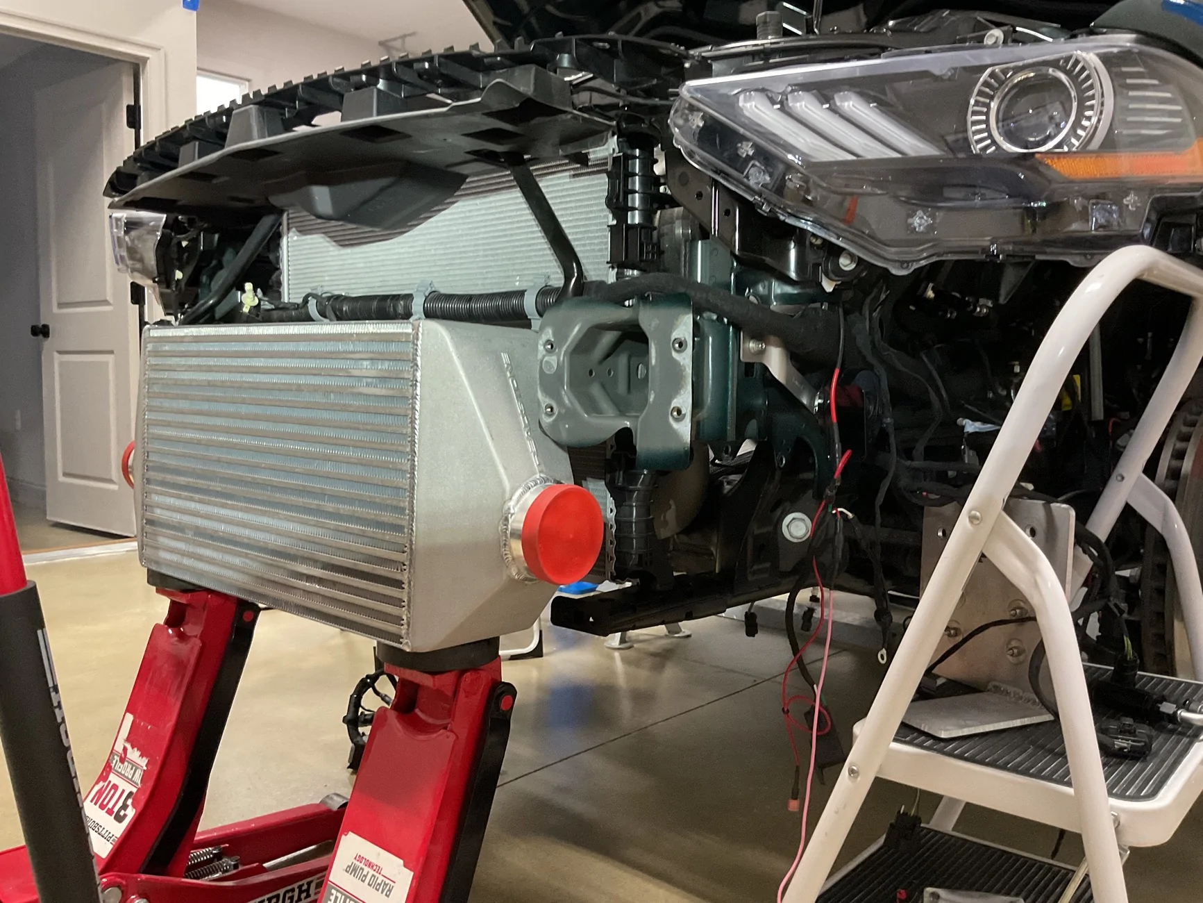

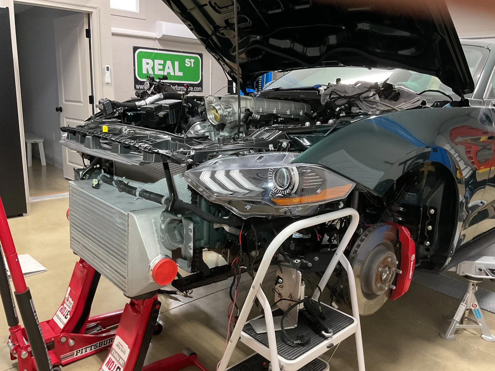

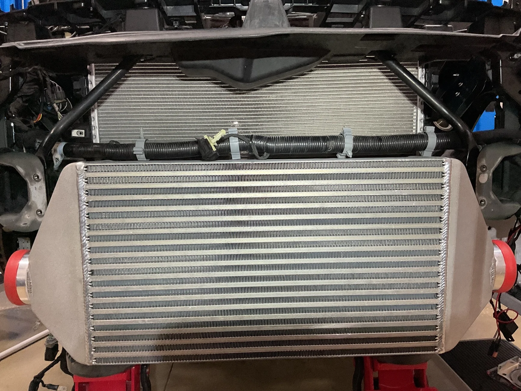

Here is a pic of the front of the car for reference, which will have a 6” thick intercooler on the front.

Yea I was looking at the images you had posted of your front with bumper cover off and thought the Harrop positioning of the oil cooler core would work best (in your situation). With the location of the intercooler you have, there isn’t much room to do a forward facing oil cooler core. You don’t want to block the intercooler and you also don’t want to impede airflow to the oil cooler core either.
The Harrop setup is ideal and even though it looks like it would not benefit from a direct “forward” airflow mount (like your intercooler or say radiator), it does get cooled because of the airflow and forces happening under the nose of the car at speed where air is forced up and into the rad/engine bay cavities.

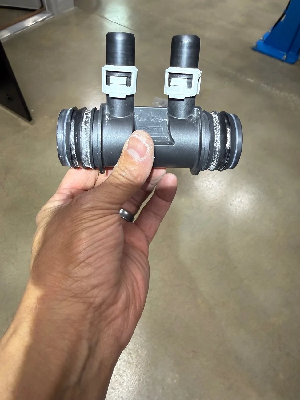

I deleted mine and used the double Venturi tee to cool my turbos with. Never reinstalled anything else. I don’t do any long road track events. Oil isn’t getting super hot 1/4 mile at a time. I’ll watch it when I do roll racing etc, but I don’t anticipate it getting outside of what 5w-50 likes.

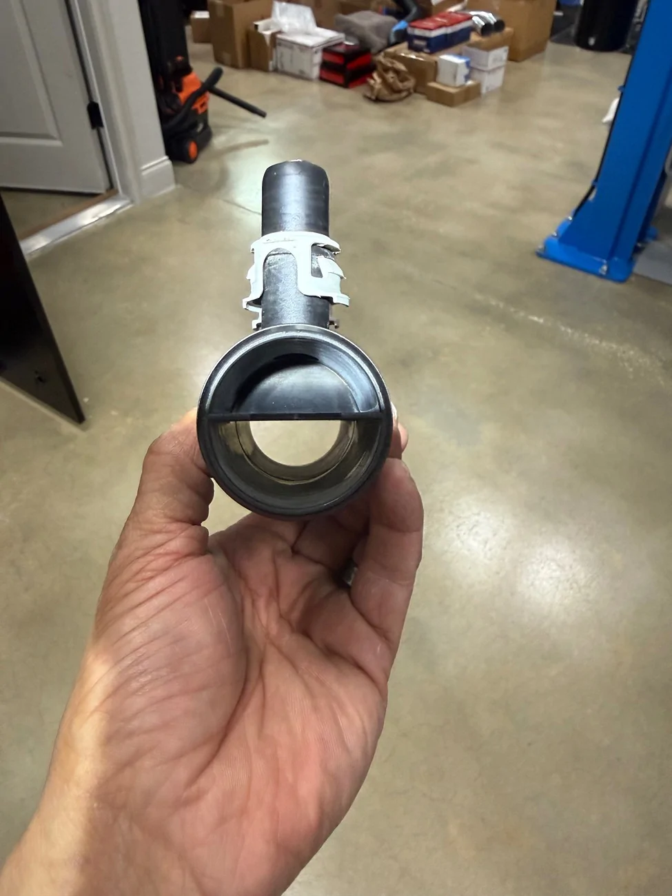

What’s the double Venturi tee look like on your car?
It’s the thing you unhooked these 2 from on your car. Should’ve been part of your lower radiator hose.

I gotcha. I thought you may have been running an aftermarket one. I had been looking at some aluminum versions of them online. I actually very carefully cut mine out of the factory radiator hose using a Dremel, thinking I could still use it, but the factory oil cooler hoses were molded in such a way that new hoses would have been required.
