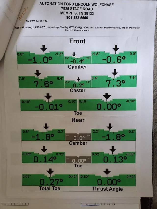

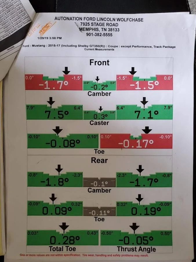

VisceralSyn
Dec 9, 2019
106
83
Memphis, TN
David
2017 Ford Mustang GT
When I put the Ford Performance Street Handling suspension pack on my 17 Mustang GT, I knew she needed an alignment. Took her to the dealership I purchased her at, and when the alignment was complete, they provided me the spec sheet, which has exact measurements, also were in the green. Maybe try a different dealership?
