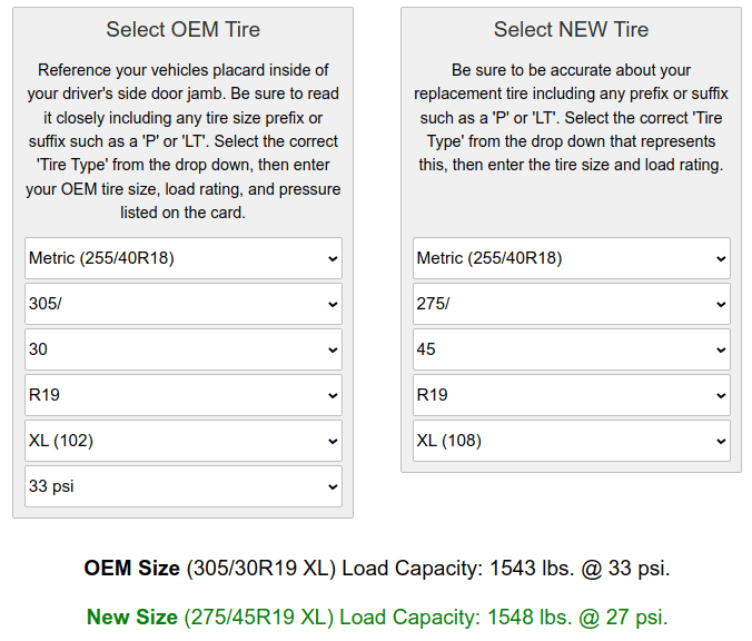

When changing from the 305/30R19 summer tires to 275/45R19 winter tires, what tire pressure should I use and why?
The sticker in the door jamb says to use 33 psi for the 305/30R19 OEM size tires.

FWIW, that tire pressure calculator is solving for load rating, and since your new tire has a higher load rating, it has reduced the tire pressure needed, but IDK if that means it SHOULD be run at a lower pressure, just that it can be? IDK those things are weird and in my experience the wider tires with lower profile sidewalls can be run at lower pressures and grip/handle well.
Anyway, I'd go with Ford's 32 PSI as a good bet, and adjust from there based on tire wear patterns.

Tire size does not change air pressure. Your start point is whatever is in the doorjamb. You can always go up a pound or two. Only lower pressure if you’re going on the beach.

I run 32f 28r cold for my snow tires. Mostly for even rear wear.
