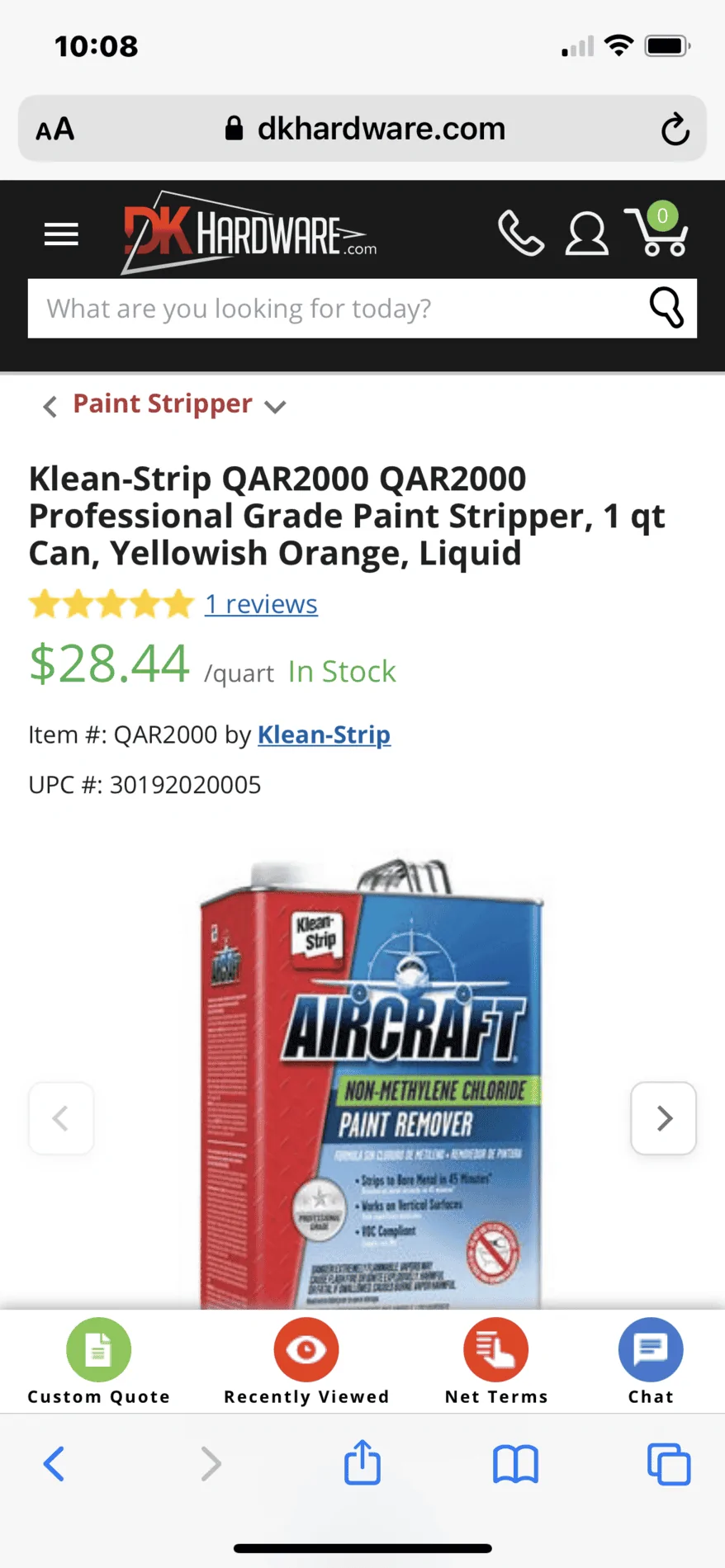

Aircraft paint stripper will remove the paint but may hurt the epoxy as well, I don’t know.

Whatever you do, do not under any circumstances use any type of chemical stripper on your wheels. It will destroy the epoxy resin and could render your wheels potentially unsafe. Aircraft paint stripper (at least for commercial aircraft) is an acid. Painters have to wear respirators and dress head to toe in protective gear, it causes polyurethane paint to bubble up and run off, imagine the effect it could have on your wheels.

Been using this for years. Outdoors only and it really doesn’t work that well any more (I’m in California) due to regulations. Barley removes paint and primer with several applications.
Maybe buy a destroyed/not repairable CF wheel and practice different methods.

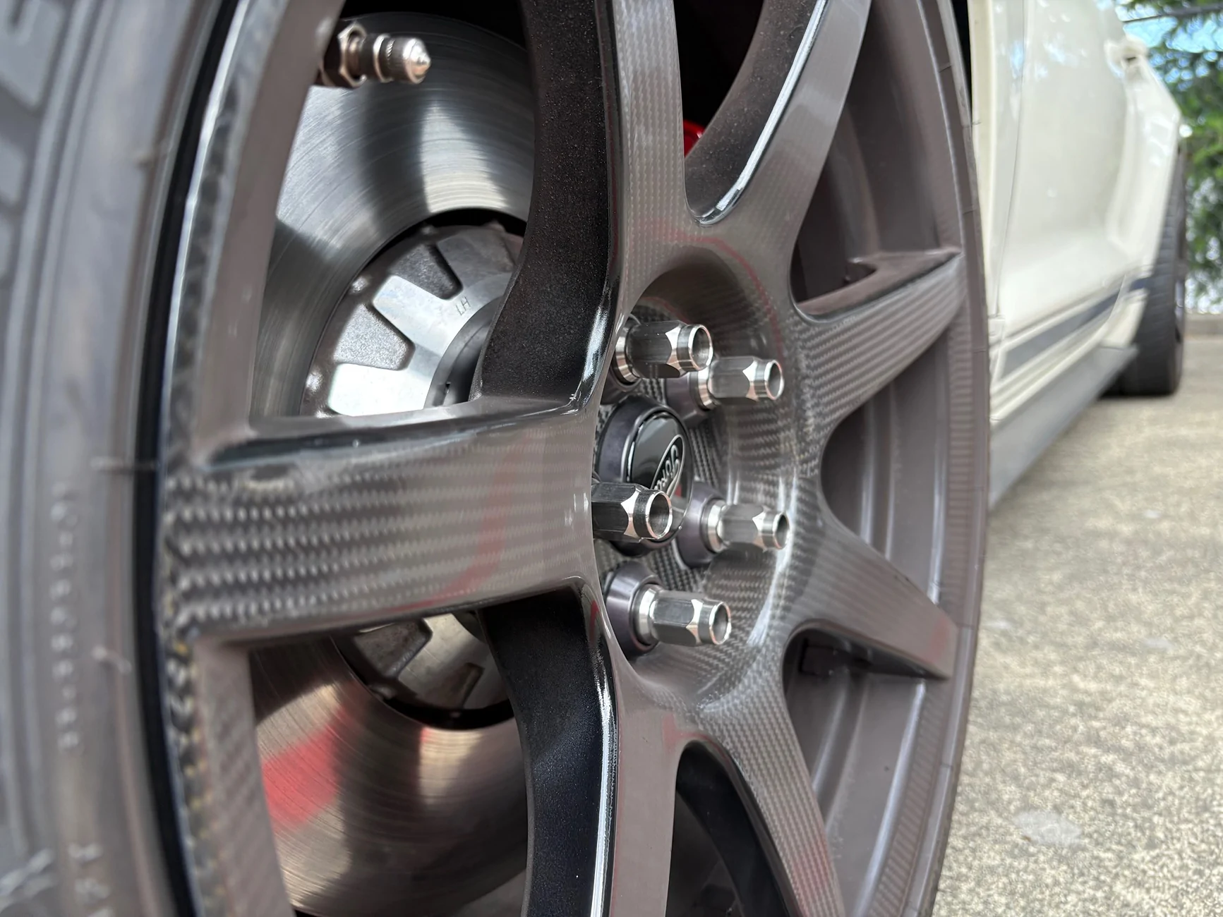

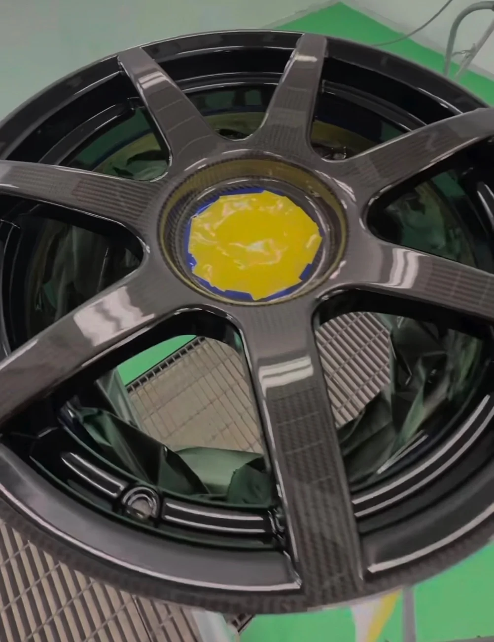

I’m having this process done by Platinum Automotive in Charleston SC. Wanted this info to be posted somewhere as there is very limited research I can find online. Wet sanded by hand. Two coats of clear!

I have personally seen two sets done. The weave and patterns from an appearance perspective is completely fine. The sets I've seen look great and I wouldn' t hesitate to do it, assuming it's done right. I'm pretty certain at least one of the two sets has been posted on the forums here, but don't recall the details for a successful search.
OMG! That looks AMAZING!

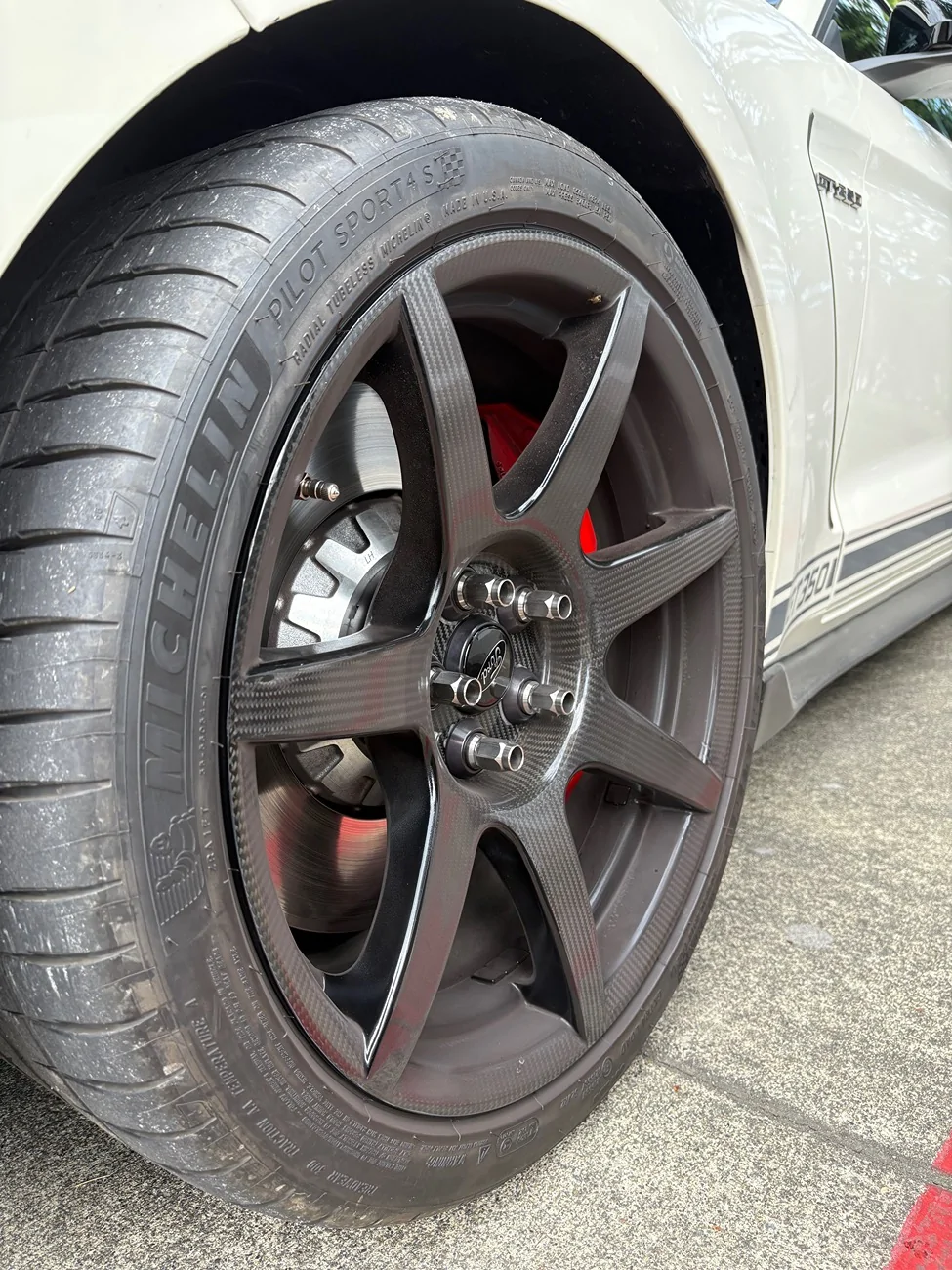

I saw a HEP R with exposed carbon rims this weekend. The carbon looks incredible by itself… but I must say that I actually prefer the looks of the black accents on the car, and I think it all looks best matching as black.
I do love the carbon track pack on the GT500s, but the black looks best on the 350R…
That’s funny because this is exactly how it is done. Use stripper to remove the paint then wet sand it then clear coat it
