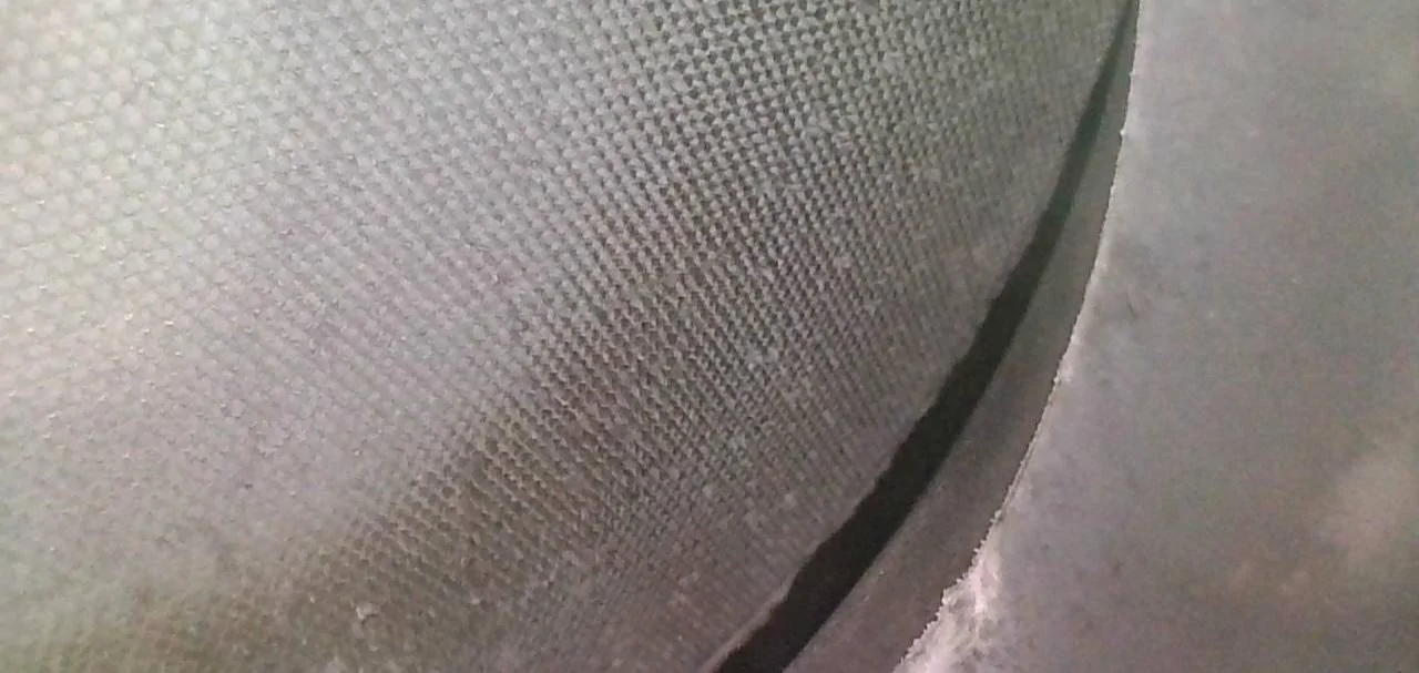

Pulled the o2 sensor and took a look as best I could. It's intact at least, but is that a blockage in the center?
*Edit* looks like a crack?

Looks ok for now, what about the other side?
That was drivers side, I had to wait on amazon to deliver my O2 socket. What an absolute nightmare it is under there to do anything.
