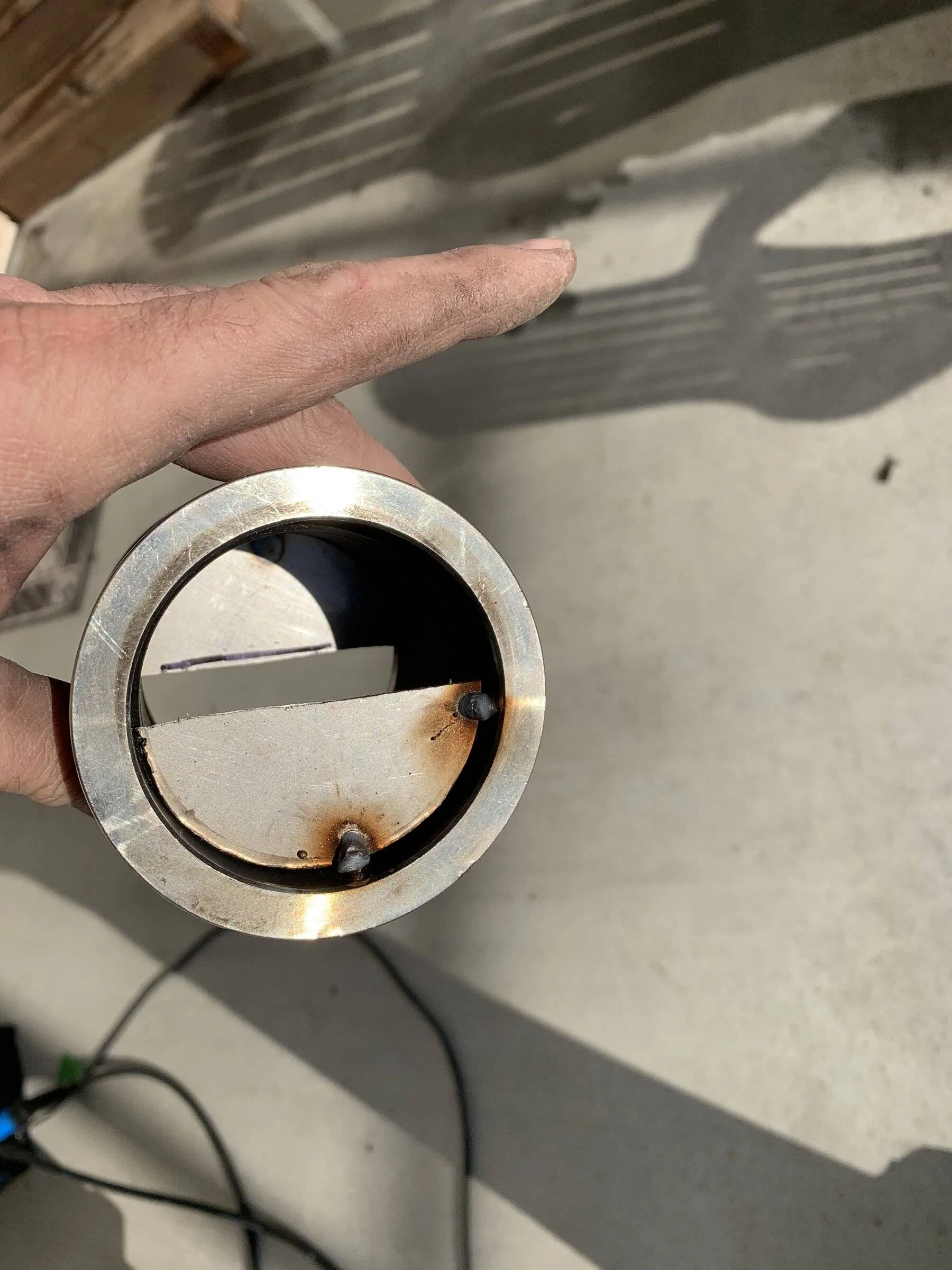

By the way, I made the magnaflow spool piece (where the exhaust valves go) into hemholtz quarter wave reflectors. This did a lot to bring down noise levels in the 1500-2500 rpm range.
