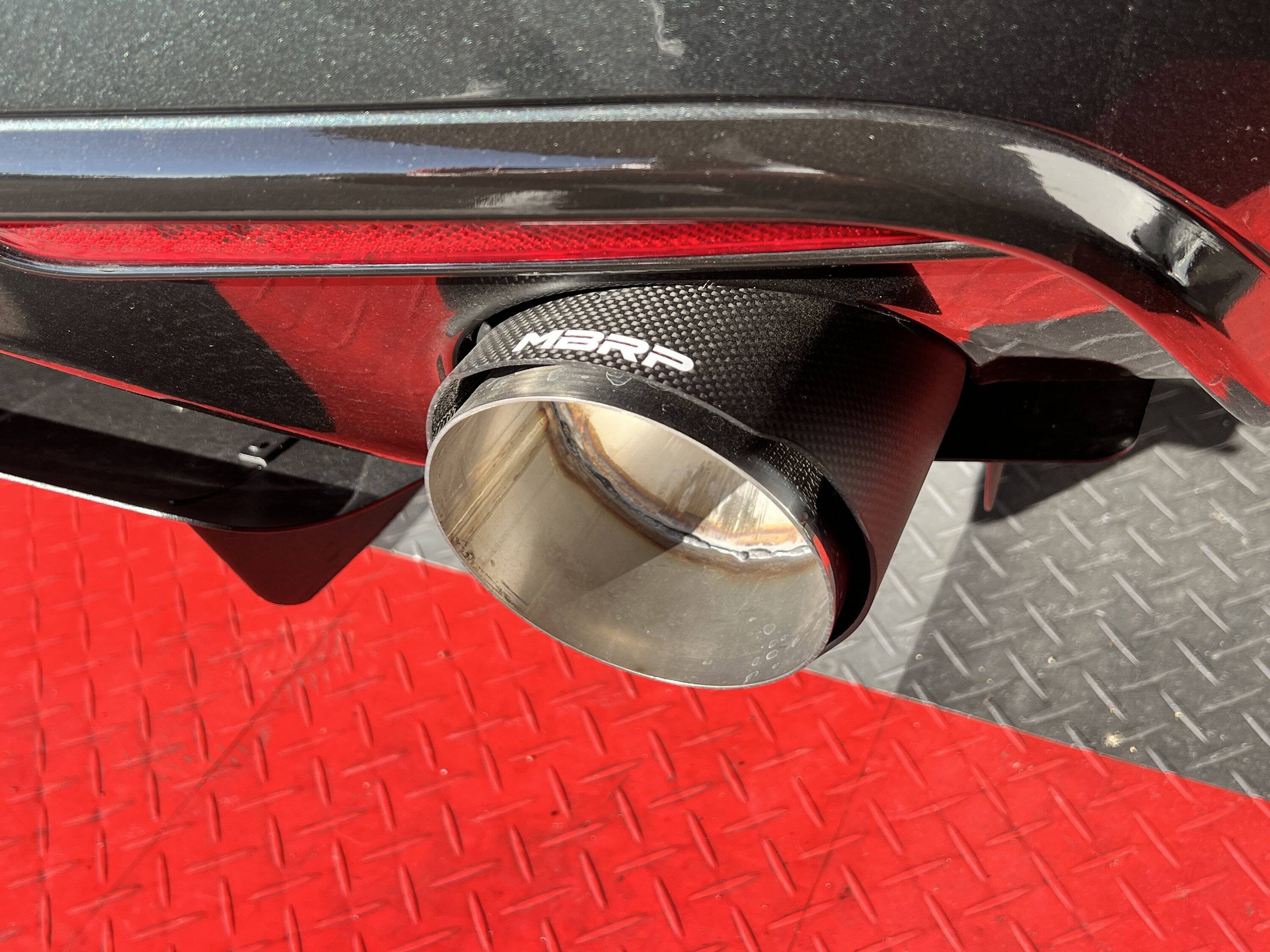

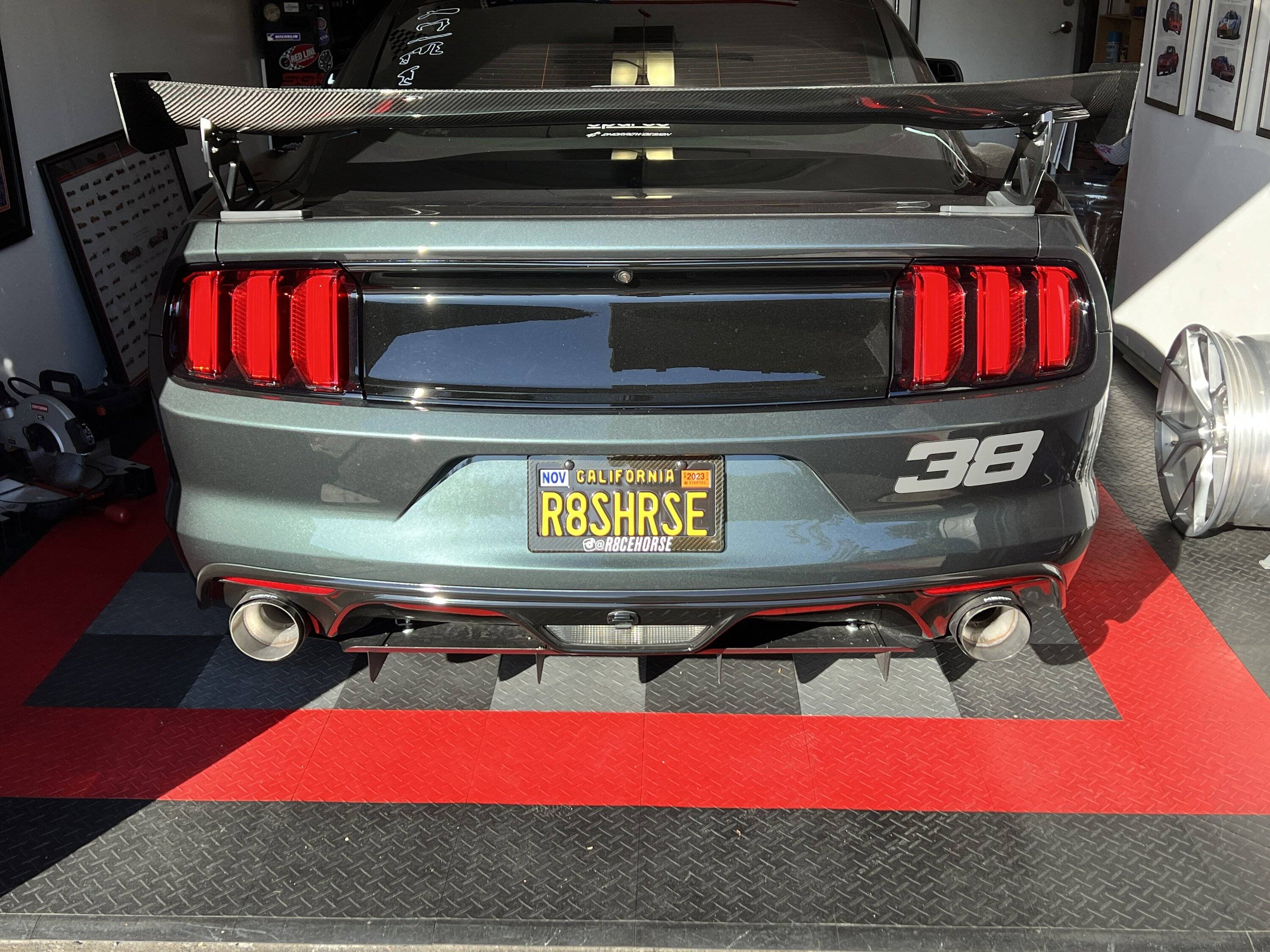

I was in the same boat and originally I went with a MBRP street with a H-pipe.
After a while I broke the muffler part so I swapped it out for a magnaflow straight through design with 12” resonators. It’s now a true dual exhaust, it doesn’t sound like every other mustang out there and I get compliments on it all the time.
I actually went through several variations of this formula before landing on this (cuz Sonoma raceway always be breaking my exhaust). If your local I have a Magnaflow Y pipe that I’ll offload for next to nothing.
Can’t forget the tips!
Hope that helps OP!
