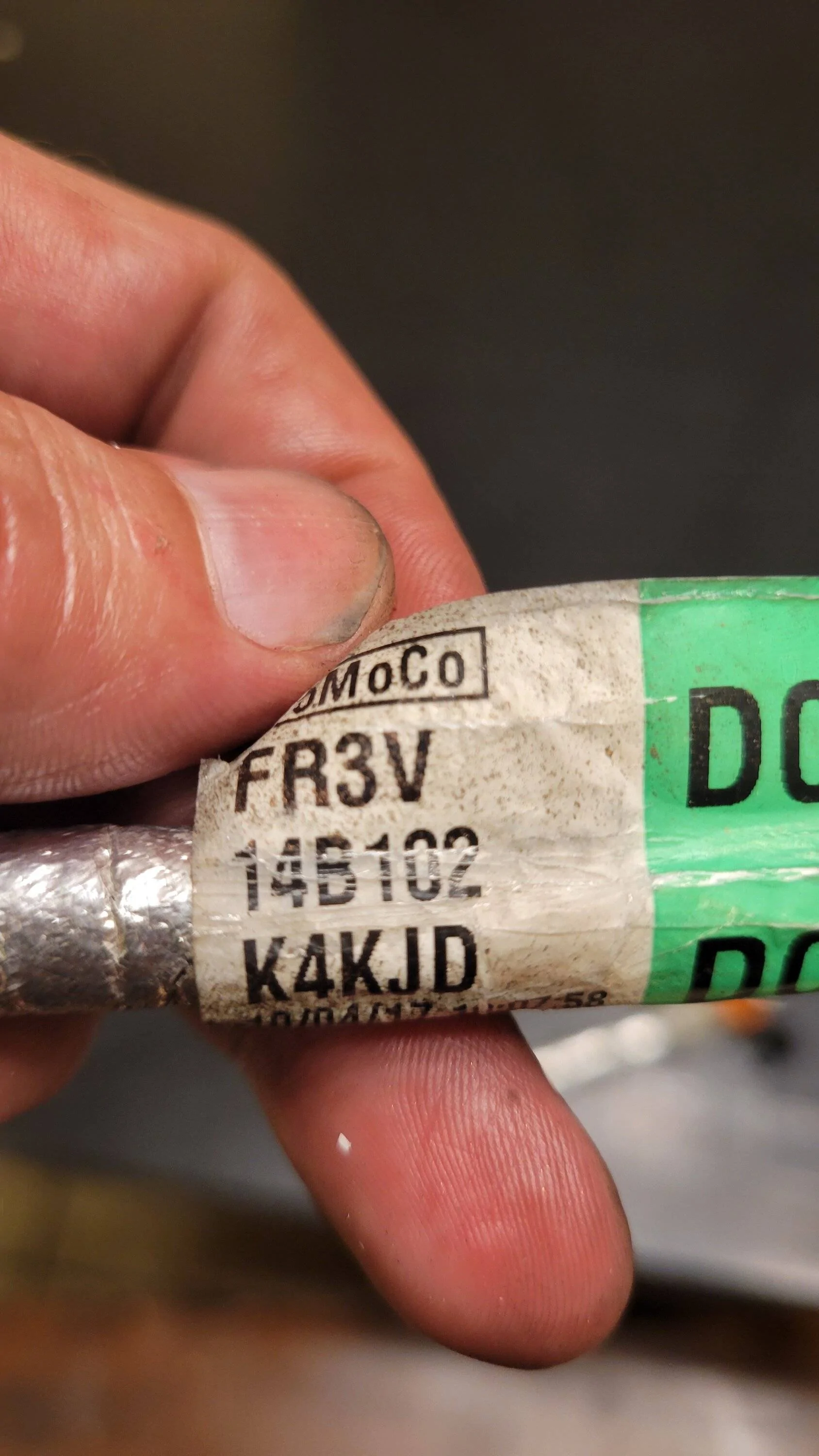

The red retaining clip on my drivers-side active exhaust is brittle and broke off.
I can't seem to find the replacement part anywhere and even Google had limited or no results. Here is a photo... anyone know where I can find/purchase a replacement harness online?

Took some hunting but I believe these are the GT350 specific parts, which have the C clip in the middle:
Left harness: FR3Z14A417H
https://parts.ford.com/shop/en/us/wire-assy-6539401-1
Right harness: FR3Z14A411J
https://parts.ford.com/shop/en/us/wire-assy-6582847-1
Source: https://www.mustang6g.com/forums/threads/active-exhaust-install.182267/
interesting the AE on the shelby is only a 3 wire, while the AE i just replaced on my ecoboost is a 4 wire. But to answer your initial question ; i don't think you'll be able to find just a new locking clip. i don't believe that connector is publicly available
