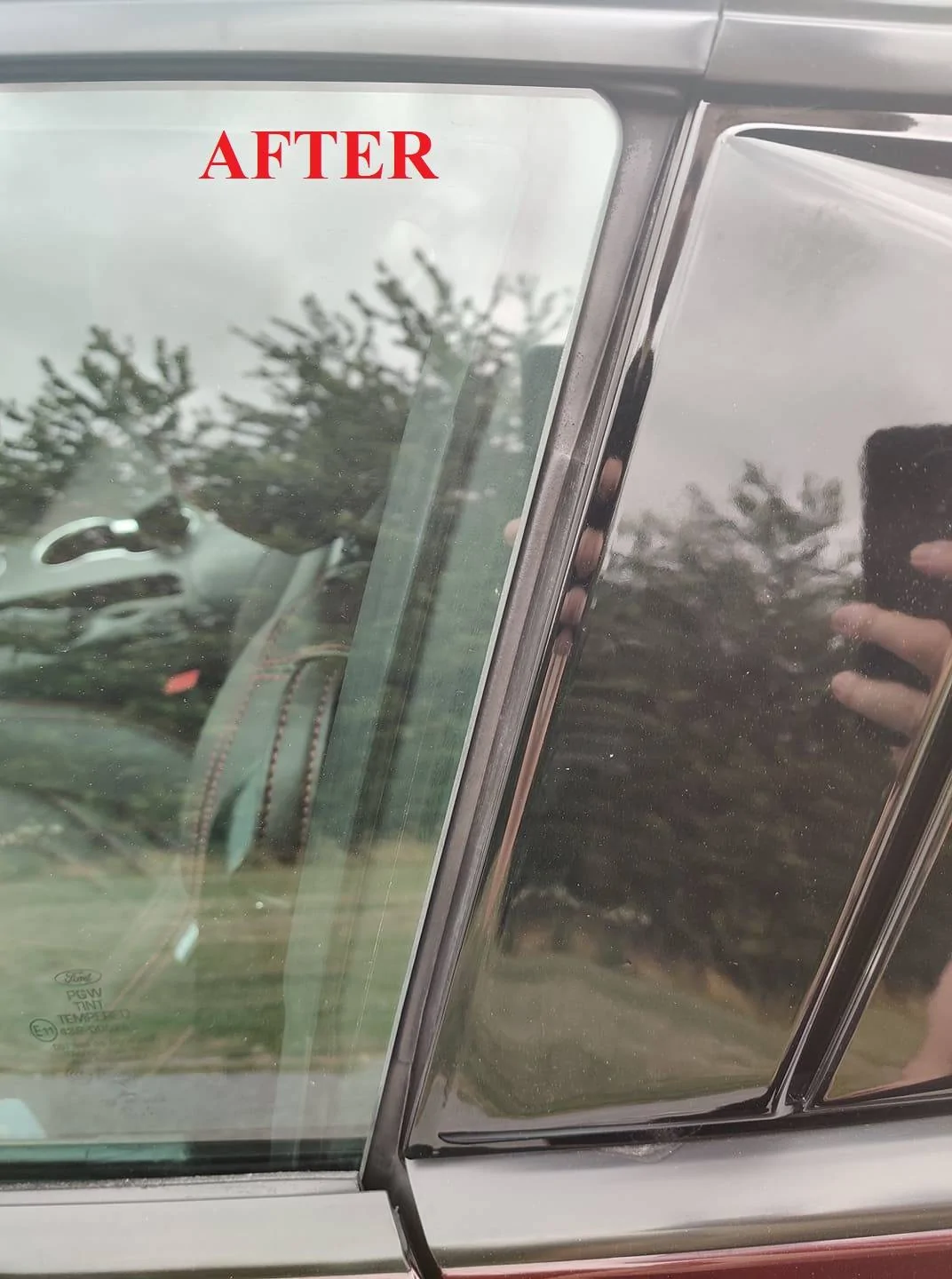

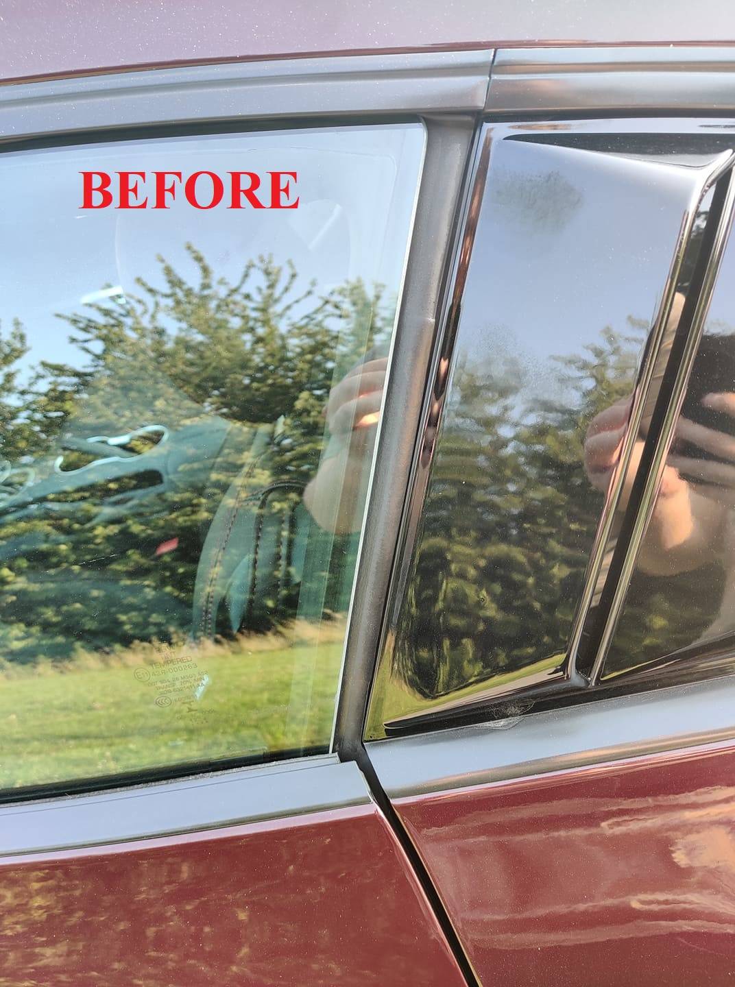

Hey guys sorry for the late reply, I've been busy as of late. I've now taken the door panel off 3 times and adjusted the window countless of times to no avail. Heres a before and after pic of the adjustment, the sound has just changed from actual wind noise to howling/whistling noise. Im starting to suspect its not the window thats the problem but the weatherstrip that needs to be replaced.

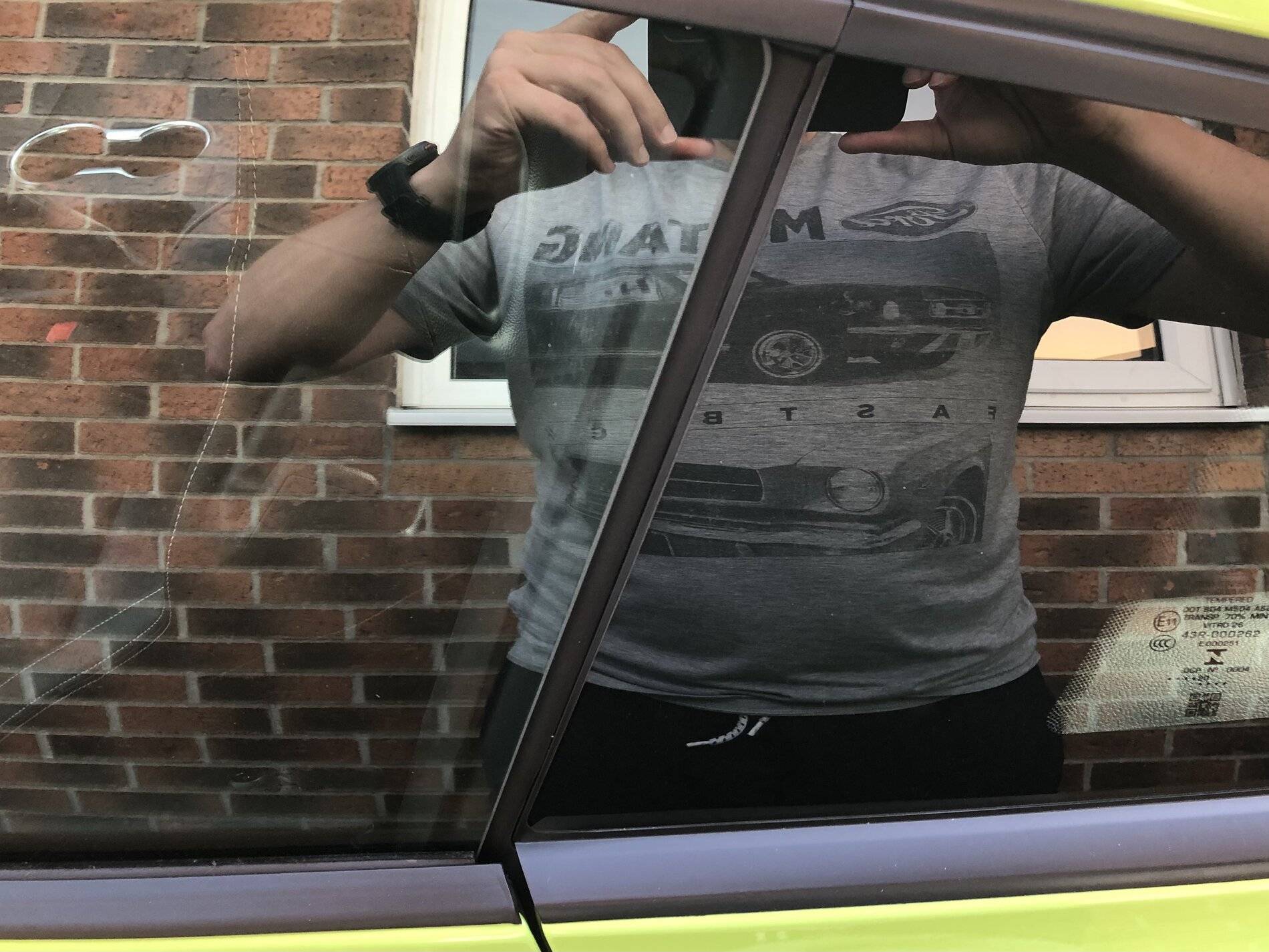

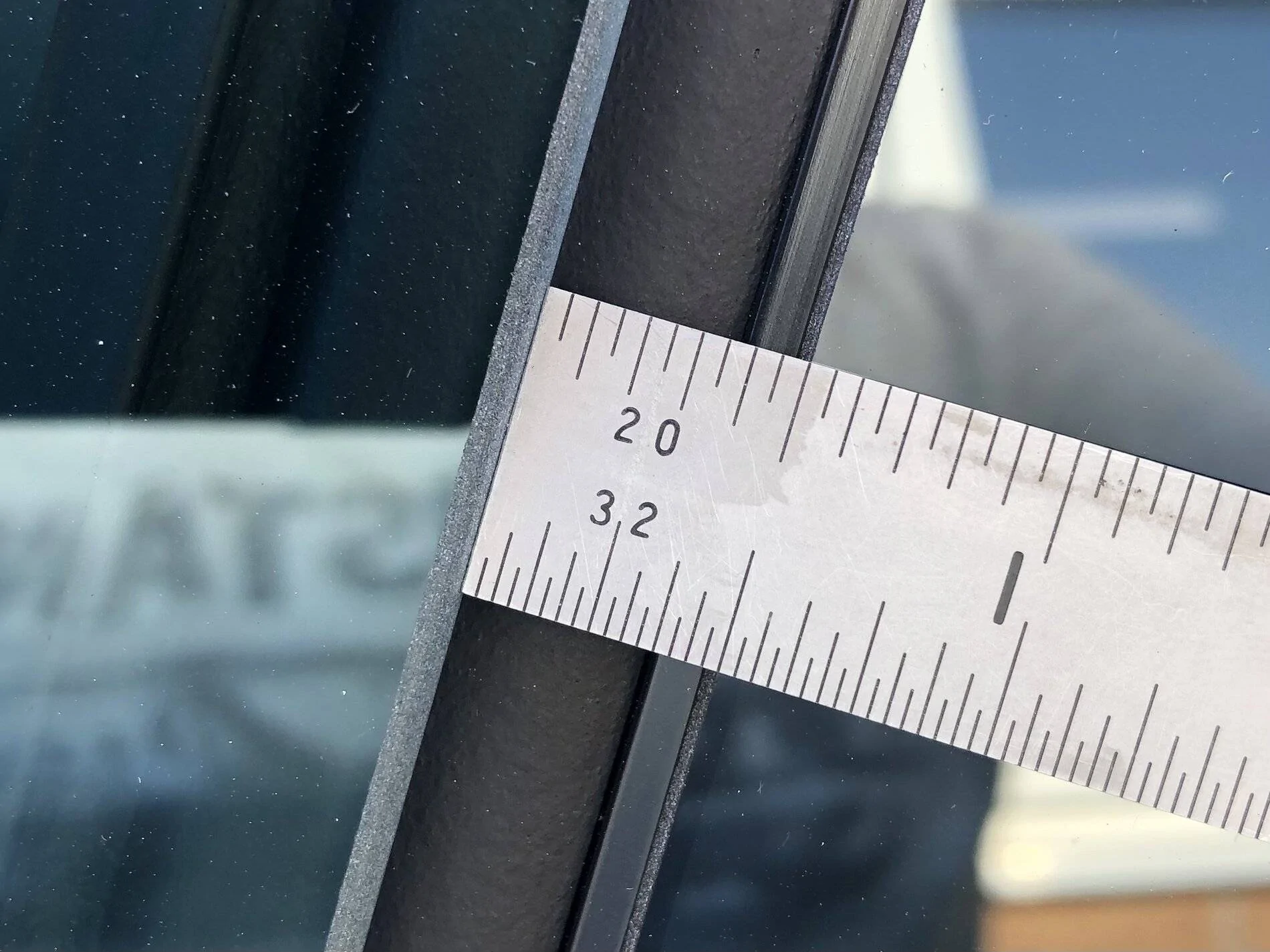

First thing I notice is that the gap between the door glass and the B pillar is A) huge and B) not parallel.
I don’t know who’s is closer to spec, but here’s mine for comparison :
It measures approx 10mm and there is less than 1mm of runout from top to bottom.
I’m not sure what this side of the ruler is for ( :giggle: ) but maybe this helps :

The after pic is looking a lot better but it still isn’t right.
I’ve been through this exact issue. There’s room for more adjustment judging by the photo.

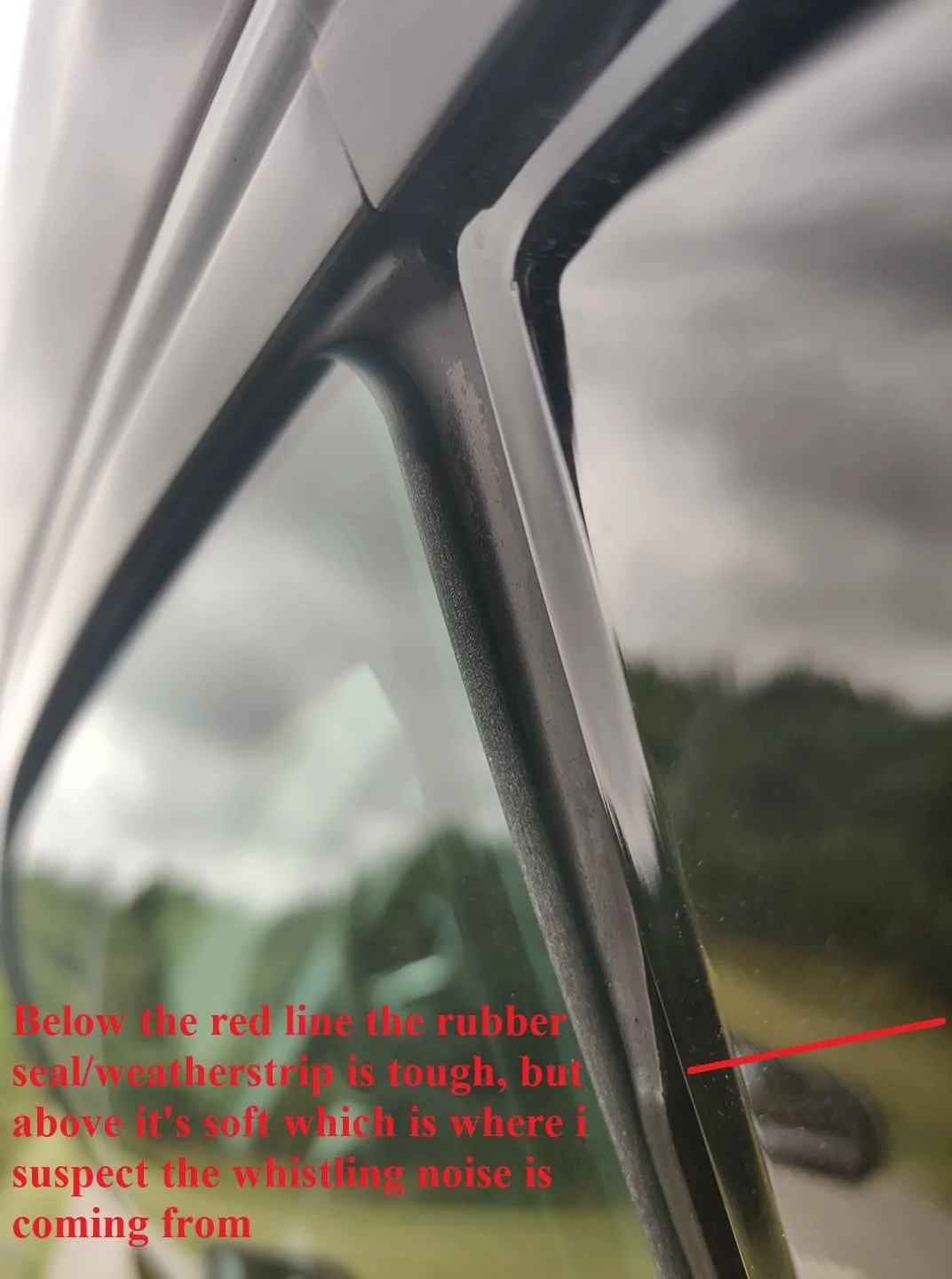

Greg you are 100% right, however as I suspected the problem in my specific case, is not the window but the rubber seal. I went ahead and pulled out the corner of the rubber seal and added 10$ 3M weatherstrips in between the rubber seal and B-pillar to push out the rubber seal against the glass, and as expected the corner of the rubber seal is now making full contact with the glass (which it doesnt do on pic 3) and the wind noise has gone away. This is a temporary fix as I'll most likely go ahead and order a new upper weatherstrip/rubber seal in the near future. Thanks for all your input.

Man, looking at your rubber seal made me even more adamant in the fact that I need to purchase a new rubber seal lol. Yours is looking solid, mines all messed up and soft.
