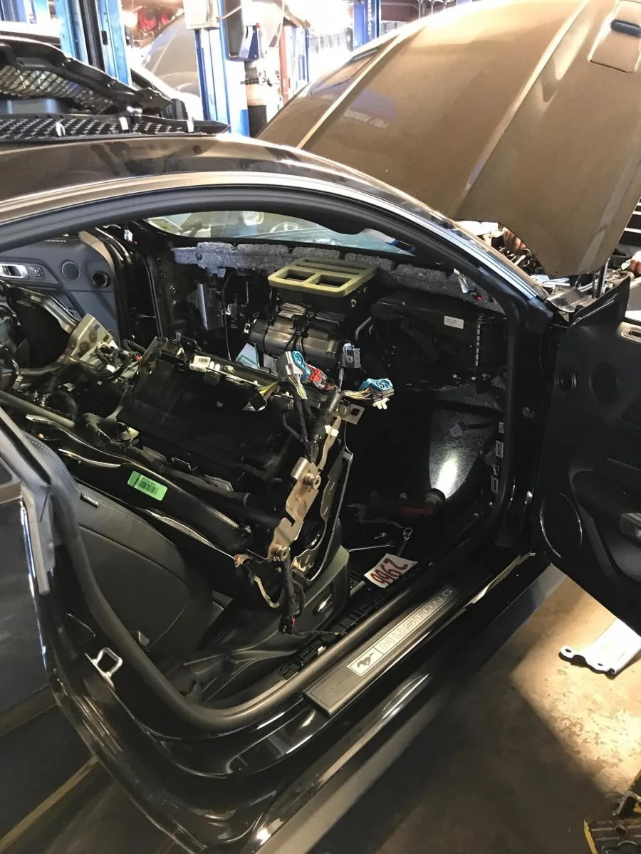

7k miles on my 2016 GT350.... Now they're telling me the evaporator core is leaking and to get to it they have to remove the dash and the seats? Does anyone know any links to instructions, schematics or videos that show the disassembly/reassembly steps involved? I just know that once the dealer does this job it will never be right again....
You definitely don't want to do this job yourself. The entire dash comes out. Not easy and you have a greater chance of breaking something without the proper tools. Strongly recommend you find a dealer who has done these before. And, at this failure rate, almost every dealer has. Most people on here report that the dealers did an excellent job with no post repair rattles or scratches. Good luck! :cheers:

Frankly I'm not sure they take the entire dash out. I bet they just release it then prop it up. My Scanner antenna wire looked untouched and it would have fallen behind the dash if they had removed it completely. The seats are cake to remove. You can't eff that part of the job up much.
I wish it were so, but, see the attached photo.
