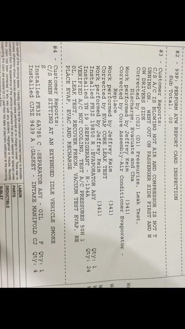

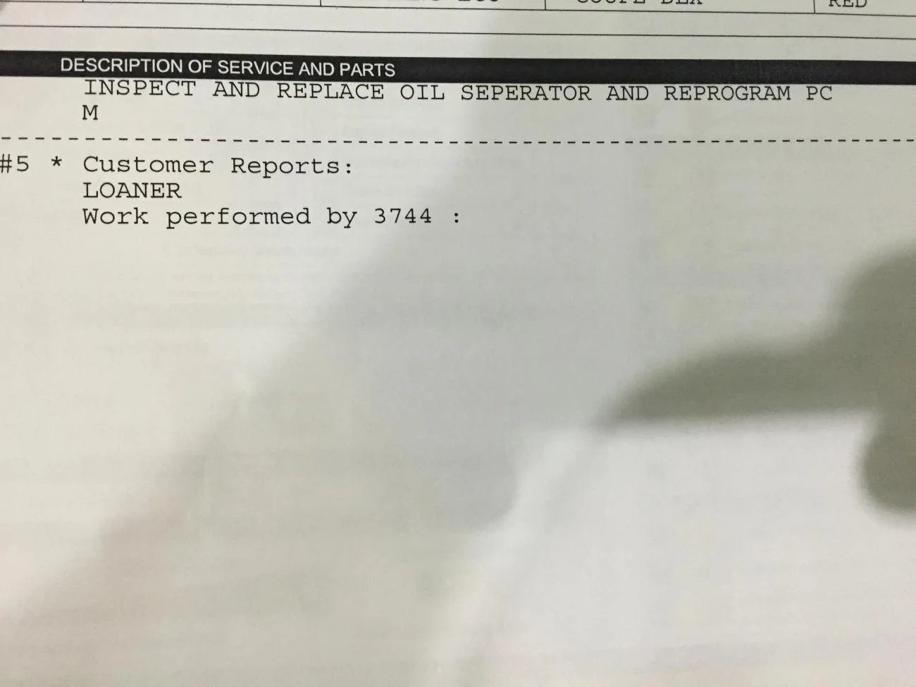

just take it to the dealer, its still under warranty, there are numerous invoices posted in this thread showing what needed to get replaced, print it out and bring it with you. as for no faith, thats the chance you are going to have to take unfortunately..
10 000km (approx 6000miles) on my 2016 Ecoboost premium and half side of the aircon blows hot, other half blows cold. (Coldest at the left vents to hottest at the right vents).
Phone the dealer and they claim no Mustangs have this issue, its just mine. I do a quick search and find 100s of people on forums and youtube complaining about the A/C dieing on the S550s.
Not sure what to do, and I also have little faith in the dealership here being able to remove the dash in this car without damaging it.
