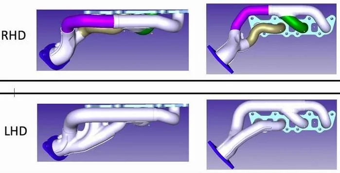

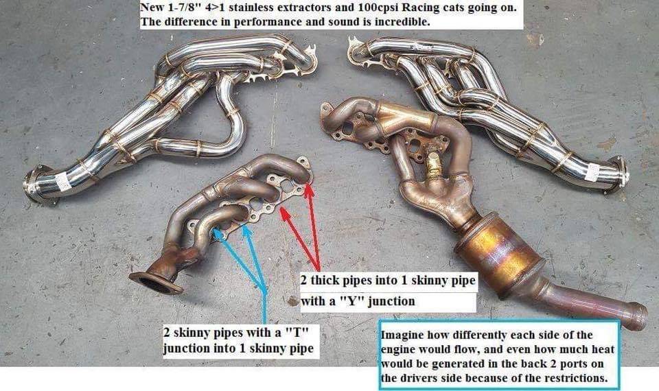

The RHD cars have a modified exhaust manifold that restricts flow. This is the reason for the reduced power output.
I forget their name but there is a header manufacturer in AUS that makes equal length headers for the RHD cars. This will get you your power back and more.
