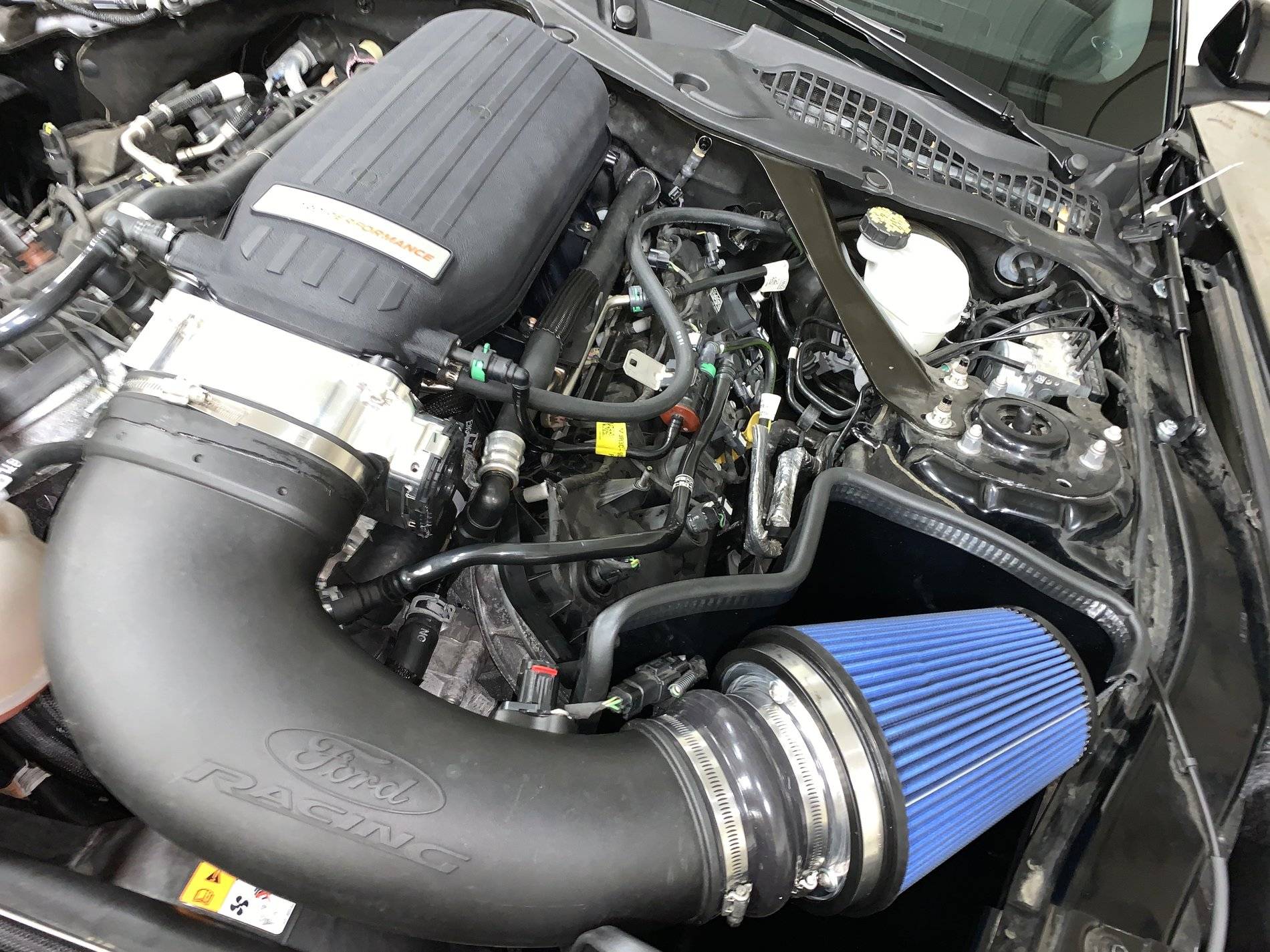

Haha I hope your problem stays away. I have a cobra jet intake vmp twin 69 and ford racing cold air along with full exhaust headers back and am running e85. It’ll run fine for a period of time but then the service advance track light will come on along with maf codes. My maf sensor voltage jumps to 0 when it flashes. I don’t have a cut or broken wires, no vacuum leaks, clean filter clean maf, I think it’s tune related, I’m going to throw it on the scanner tomorrow.

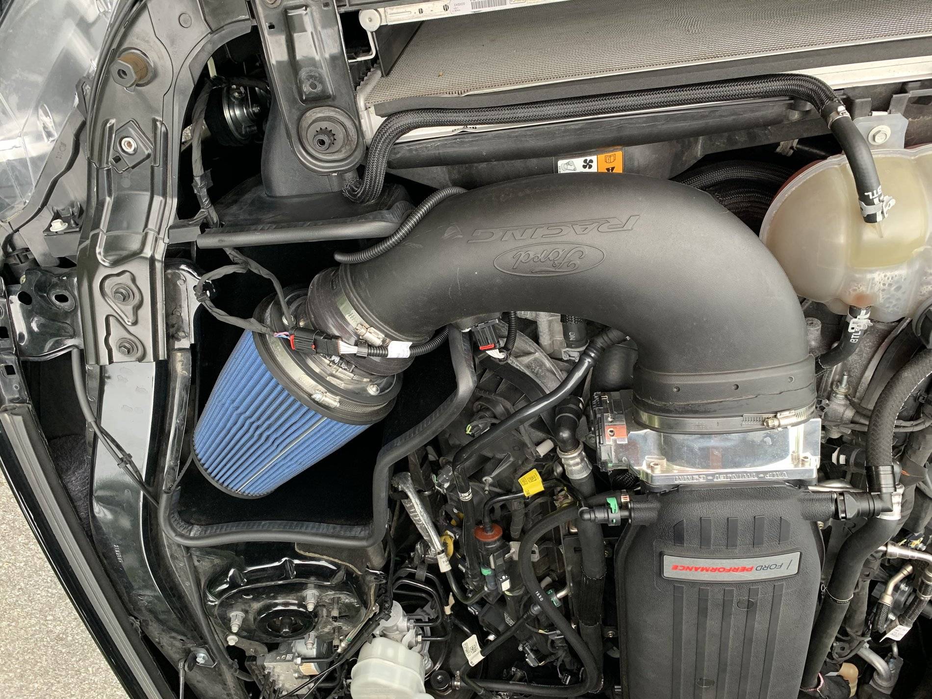

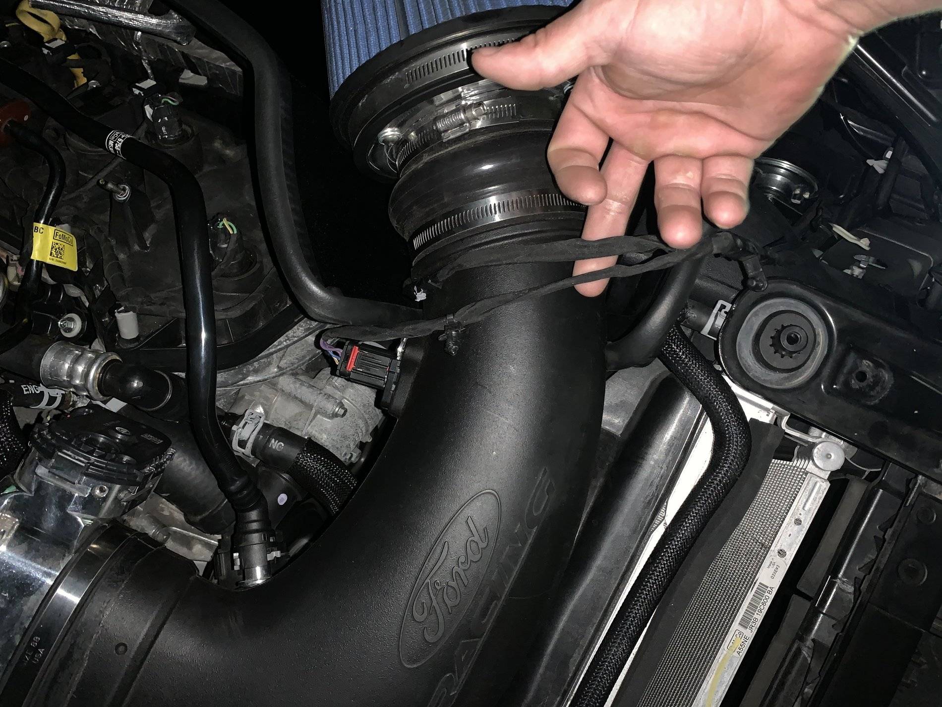

After a long pain staking process I found my issue and fixed it. After I installed everything the way I ran my maf sensor plug was very tight and after awhile of engine movement and heat yadayada the wire had a lot of tension a pulled out slightly. I open the connector and pushed the wires back in so they were making full contact(not intermittent) and the problem was gone. I ordered a jms harness extender bc no matter which way I routed the harness it was tight. The jms extension allows for plenty of slack.

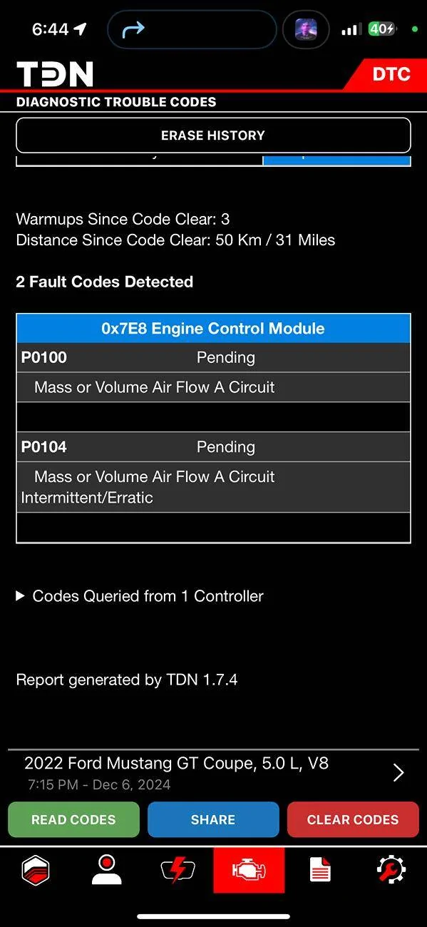

Did one of yall ever solve this problem have the exact same problem but with these codes

Is that the stock vaccum line cause mine has a kink in it with the ford performance high ram did u buy a shortened one or just moved it around
