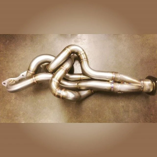

Does anyone make equal length headers like this for the GT?

equal length means the primaries are the same length for each cylinder. not equal to the stock headers and definitely not shorties (which don't do anything).

It's about exhaust pulse phasing. When you have equal length, the exhaust pulse travel equal distance instead of some arrive first some arrive later. It gives you a better exhaust note.

Gotcha! Duh, seems so obvious now in regards to "equal length." My mistake, thanks for the info!

Has anybody actually measured each tube on their longtubes? They have to be pretty close I would think.

I believe most LT's are, or are at least somewhat close to being equal length. This can be seen when looking at the primaries that are closer to the collector having extra contortions (length) instead of taking a direct path down to the collectors like the forward most primary tubes. Remember available space also dictates this.
