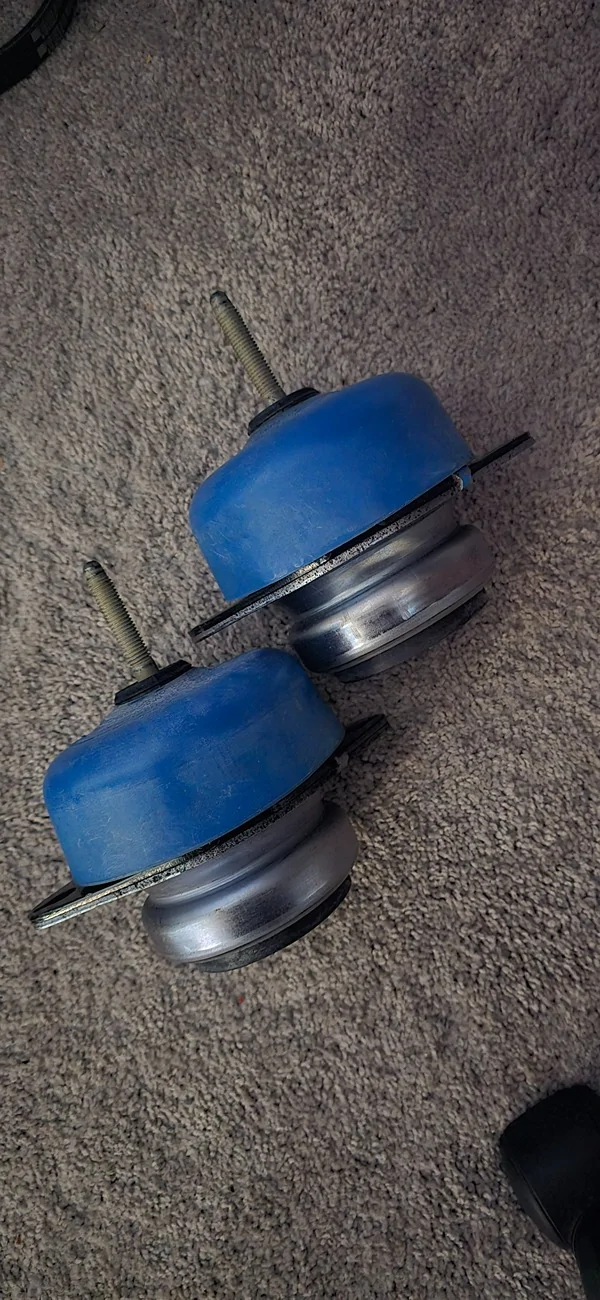

I have ordered new motor mounts, my question is, I saw in the service manual I am supposed to raise the engine with a motor support system that attaches in the fenders, has anyone use the harbor freight one? Or should I spend a couple hundred in a different brand?
Thanks again!
I used this one from Amazon. Already had it for my BMWs... but it will fit pretty much any vehicle. If you are in Colorado, you are more than welcome to borrow it.

My 2016 350R is on the lift in the garage, so I went out and checked. Both left and right have a blue cover on them. The cover is a rather flimsy rubber-ish cover. Not seeing any heat rejection material in there at all. The mount underneath the blue cover is black.
I'm going to guess that when they R&R'd the motor, they probably damaged the blue cover and didn't replace it (not sure why they would).
As for the rocking, it is quite possible that one (or both) of the mounts are loose. Getting a socket on the top nut is pretty easy from above. Getting on the lower one, without the car in the air, looks like it might be a challenge.
