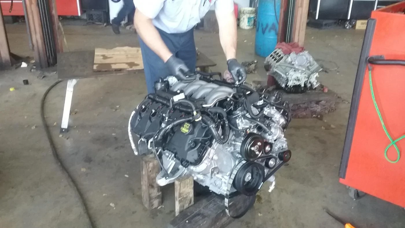

These 5.0s are noisy but great engines, our 15 GT had a slight knocking noise under normal driving or parked at 1200 to 2000 RPM.With 2K on the car went to Ford and they were VERY GOOD trying to fix it. Turned out to be wrist pin to loose on #3-6&7:doh: This may not be your problem but the dealer wanted to put in a complete engine but Ford would only OK a short block. Well it`s a long story but after 4 months and many attempts to fix it Ford RAV dept took very good care of us and put us in a new 17 GT :clap2:. Hope this is not your noise..Good Luck!

In FLA our car had to be 15 days out of service with 3 attempts to fix the same problem. Again our Dealership`s service dept was great and in the end Ford RAV stepped up to take GOOD care of us:clap2:Not a good pic but everything dropped down for repair 3 times..Engine-Trans-and everything with K member
