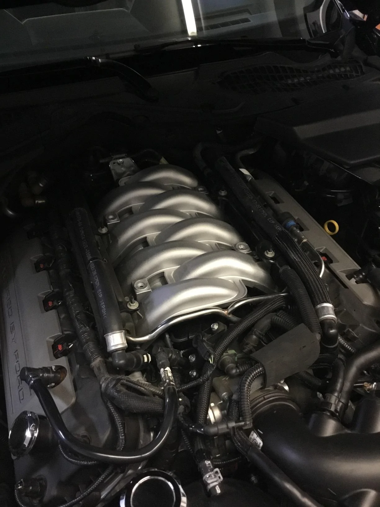

Mine is off, it serves no purpose...

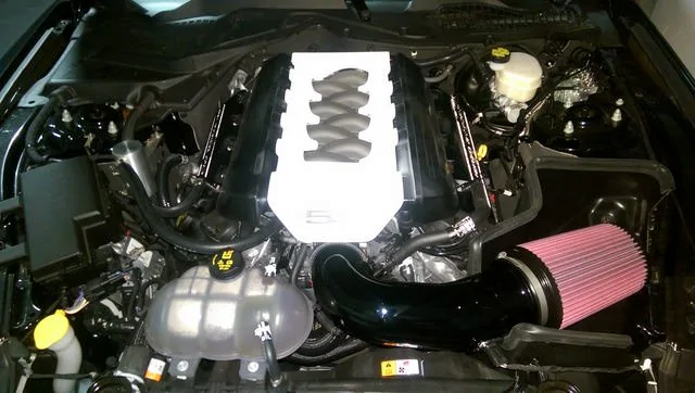

Here's mine, no cover...but Aluminum!!... Bahahahah... finished it off with a 2014 cover!!!

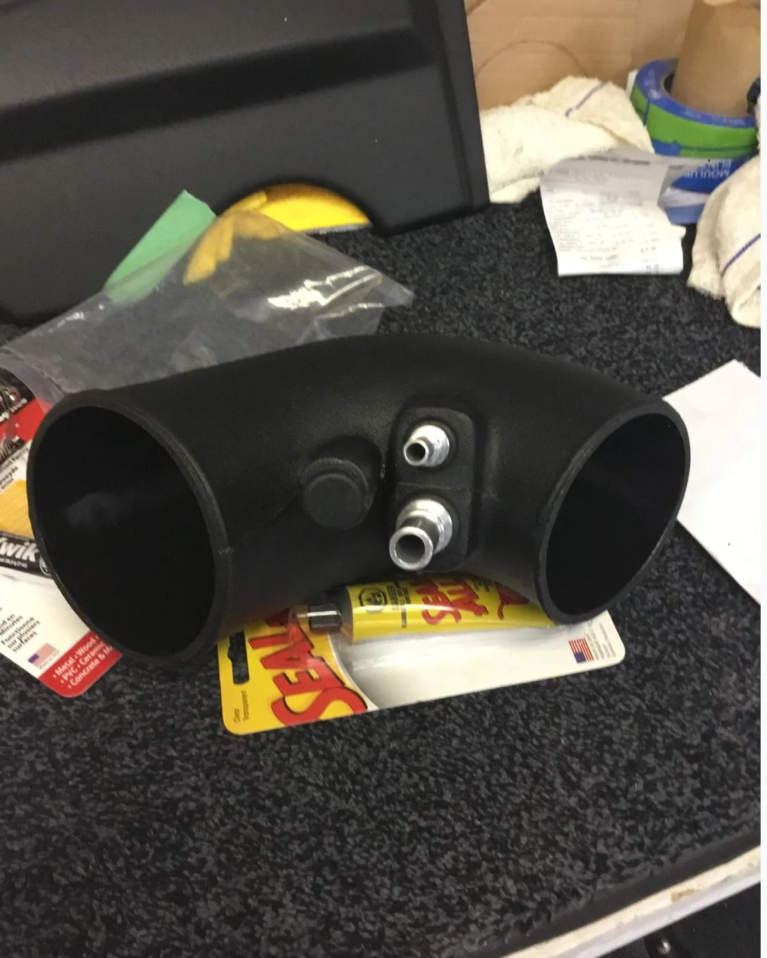

Very cool! Do you have pics of the 2014 cover? How did you get that to fit?

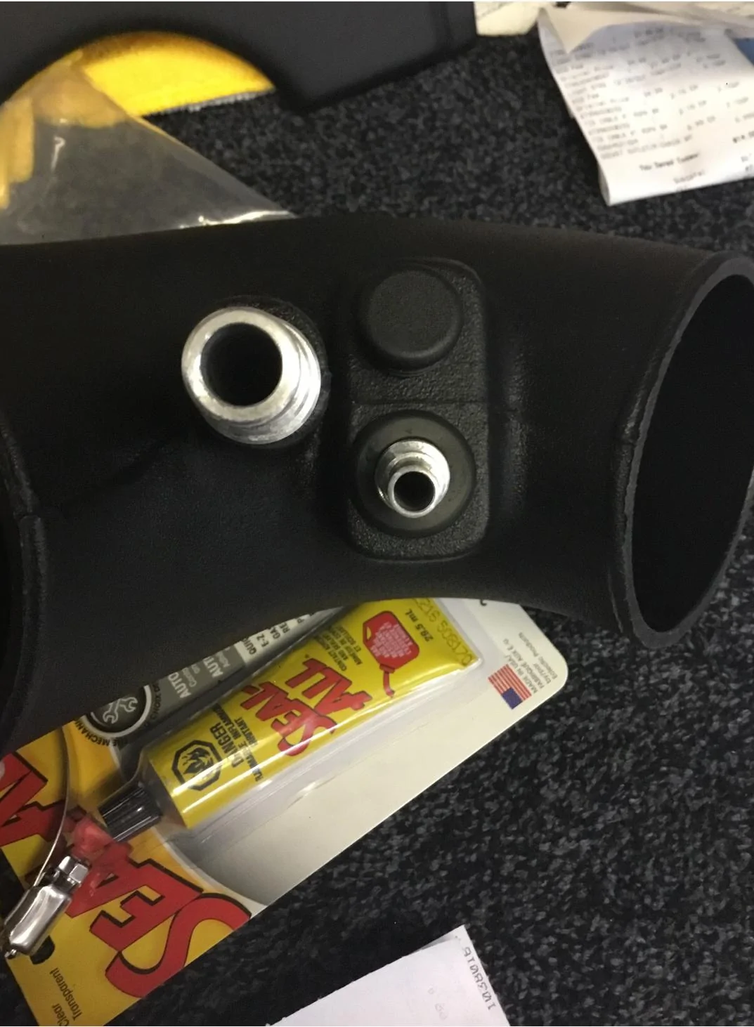

Driver side rear...relieve it by cutting out a small area so it will sit down. The hoses up front I moved around and relocated them in my Steeda CAI elbow. Th pins on the cover fit exactly on the intake!! Easy, easy. Use a dremmel and a small cutoff disc for the rear..just do a little at a time as it’s easy to do and does not even show when done!! Good Luck
Top pic is stock location of tubes....I relocated the upper tube to the bottom location...the bottom tube went over to the sound tube location! This allows the cover to fit flush...like it was factory!
