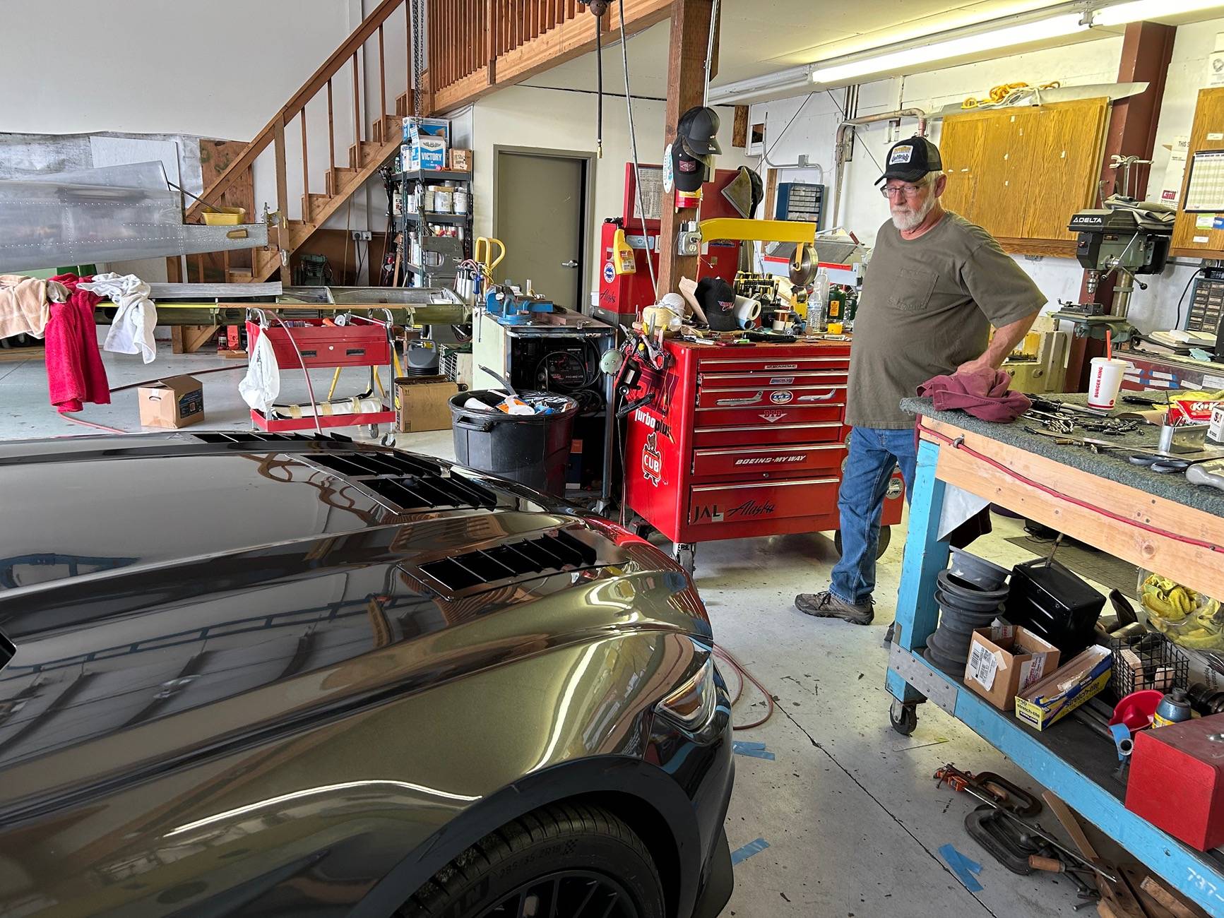

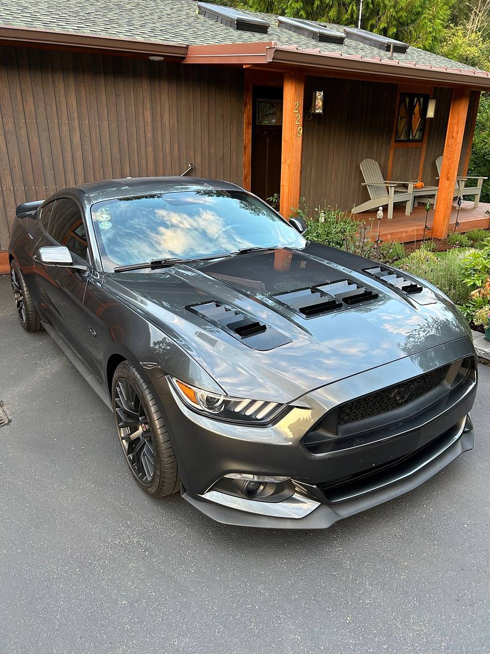

Just installed Race Louvers. Problem solved. Car runs cooler under all conditions and cools faster when stopped and shut off.
thanks for the info
do you have a picture of the setup/ louvers?

Here is a pic.
