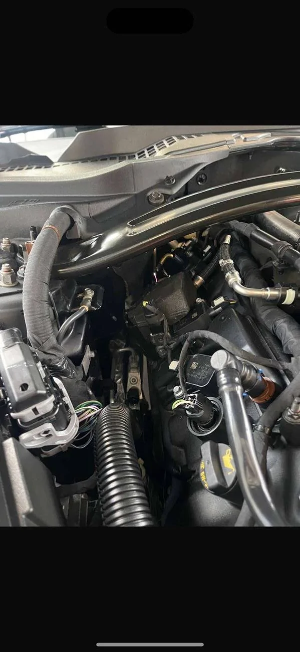

Trying to help someone out here. I'm not near the car but he sent a video/picture and explained there is a spark/electricity under the hood. Car runs fine with no codes but has this electricity.
To me it looks like maybe ignition coil? But it's hard to tell from the angle of the video. Will try to look at it tomorrow but wanted to see what yalls thoughts were.

I don't think so..but it's hard for me to tell from the video and they aren't near the car currently either. Just trying to brainstorm ideas of what it could be before I look at it tomorrow

That looks like the ignition coil is arcing to one of the hard lines on the DI pump. I wouldn't run that car like that at all. That's a major issue getting ready to happen.

Def an ignition coil. Thats the only thing under the hood that works with voltages high enough to arc like that.
That's what I'm thinking too, and it looks to be coming from that one in the back corner. Hopefully see tomorrow

Think it just needs a new coil then? Or something else?

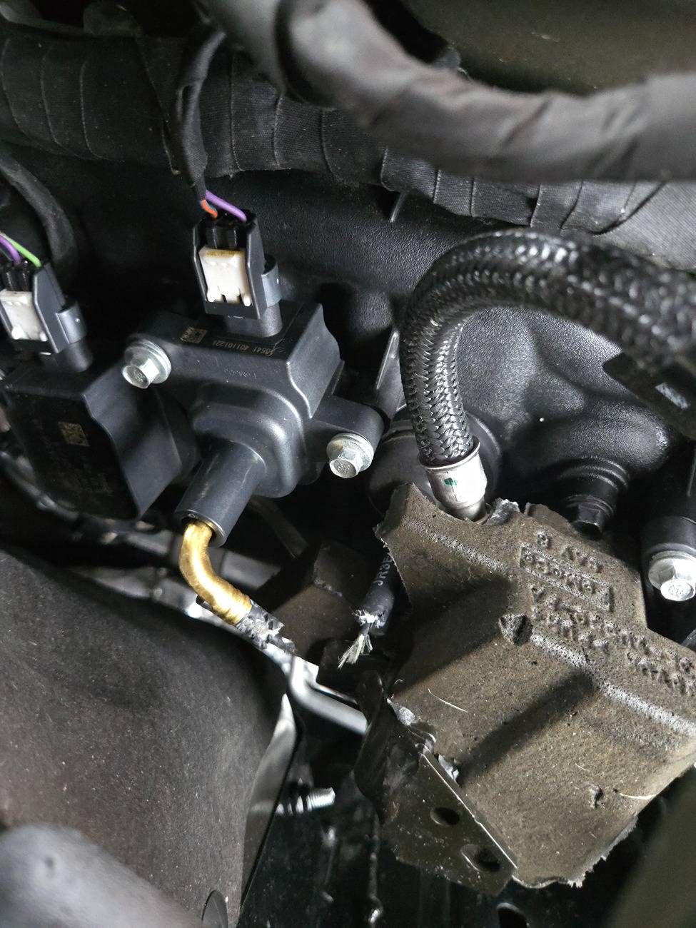

I would think that there must be a break in the insulation or the epoxy at the top of the pack. I would start by replacing that one and see if it fixes the issue. I can't think of what else would do that.

Change that #4 coil with the #1 position. If the arcing stops, or follows to the number 1 position, you know its the coil
You most definitely do not want arcing happening right by the DI pump.

Critters... you can see where it nibbled the corner of that foam cover too. I had a feeling that's what it would be when I watched that video yesterday.

What a shame that the wire wasn't energized when the evil deed occurred. Apparently the critter has lived to see another day and chew another wire.
Agreed. But glad it's an easy fix and nothing worse happened. Bright side.
