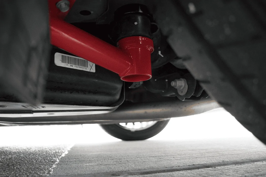

I will also add that a cradle lockout of some kind either BMR or Steeda makes a huge difference in how the rear tracks and handles. I went with BMR CB005 and I am truly impressed, Kelly is cutting 1.2 60 ft's with this cradle lockout and other IRS mods!
+1
BMR CB005 Cradle Lockout Kit will center your subframe, minimize deflection, and support it. Also make a good jack point!

Can you use a bmr cradle lockout along with the steeda subframe braces? Would it be overkill at that point?
The BMR kit replaces the middle OEM sheer plate mounting point for the Steeda brace with a short "cradle brace" piece that mounts to the frame.
They are basically competing products. Although the BMR product effects all 4 mount points, whereas the Steeda two.
More can be found in this thread here:
http://www.mustang6g.com/forums/showthread.php?t=23215&highlight=BMR+CB005
