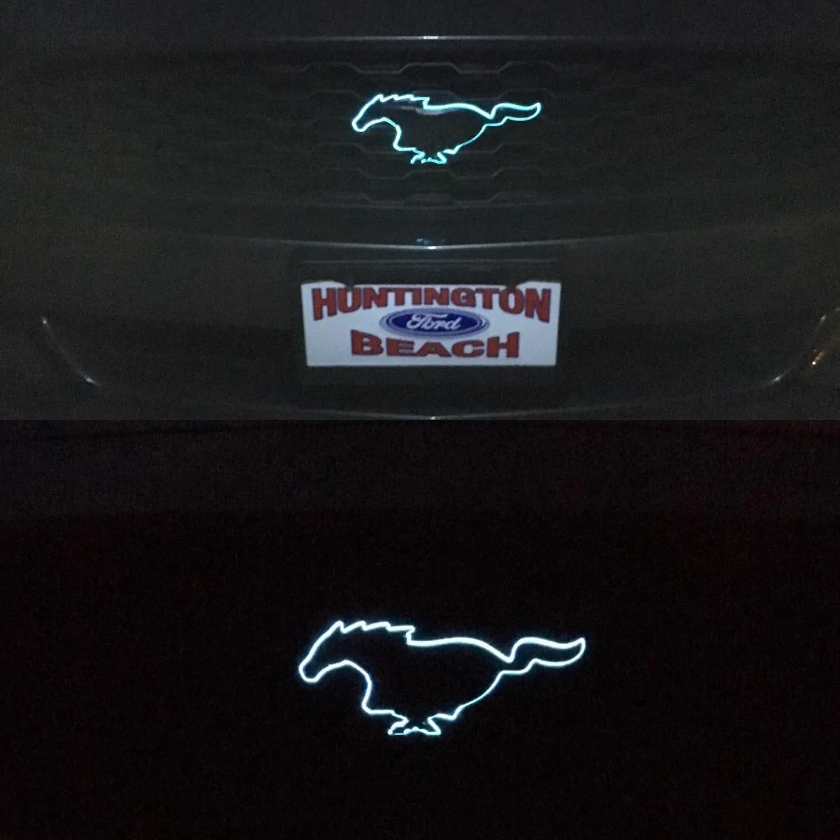

Hmm. 2mm wire. Wonder if you can stuff this around the circumference of the mustang in the grill? Would need wire without the fin, and some good, clear glue...
I got some EL wire on Amazon, stripped off the top coating, and just shoved it in the grill pony. Looks pretty sweet if you ask me
I was thinking about that but was not sure how it would look around the legs - you did a good job!
What does the wiring look like behind the grill from the horse when hood is open? Which route did you go to run it and how did you secure it or tap it in for power?
How didja glue it? (Or what glue)
Looks OK in daylight?
I like it, looks good. Nice Job
