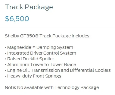

There is literally no difference in the speed at which the base and track pack cars can go. The only difference is that the track pack car can go for longer because of the coolers. Yeah it has MagneRide but the main benefit is for ride quality. Anyway, the difference in speed would probably be negated by the 40 lbs the TP car has vs the base.
I would not say just longer sessions, but longevity of the car and fluid change intervals as well. It specifically says in the supplemental manual to add coolers to a tech pack car for moderate track use, so I think that says something.
And the magneride does offer better street manners, but in the track mode obviously it will have much more aggressive damping characteristics. Im guessing the base dampers are not going to be adjustable at all (so far zero mention of them, on purpose I imagine), so likely more geared towards street use. A properly damped car will likely be faster all else being the same, even with an extra 40lbs. 40lbs on a 3750lb+ car is really not a lot.
You would probably need a solid set of double adjustable dampers to do an apples to apples comparison, at which the value proposition shifts quite a bit
