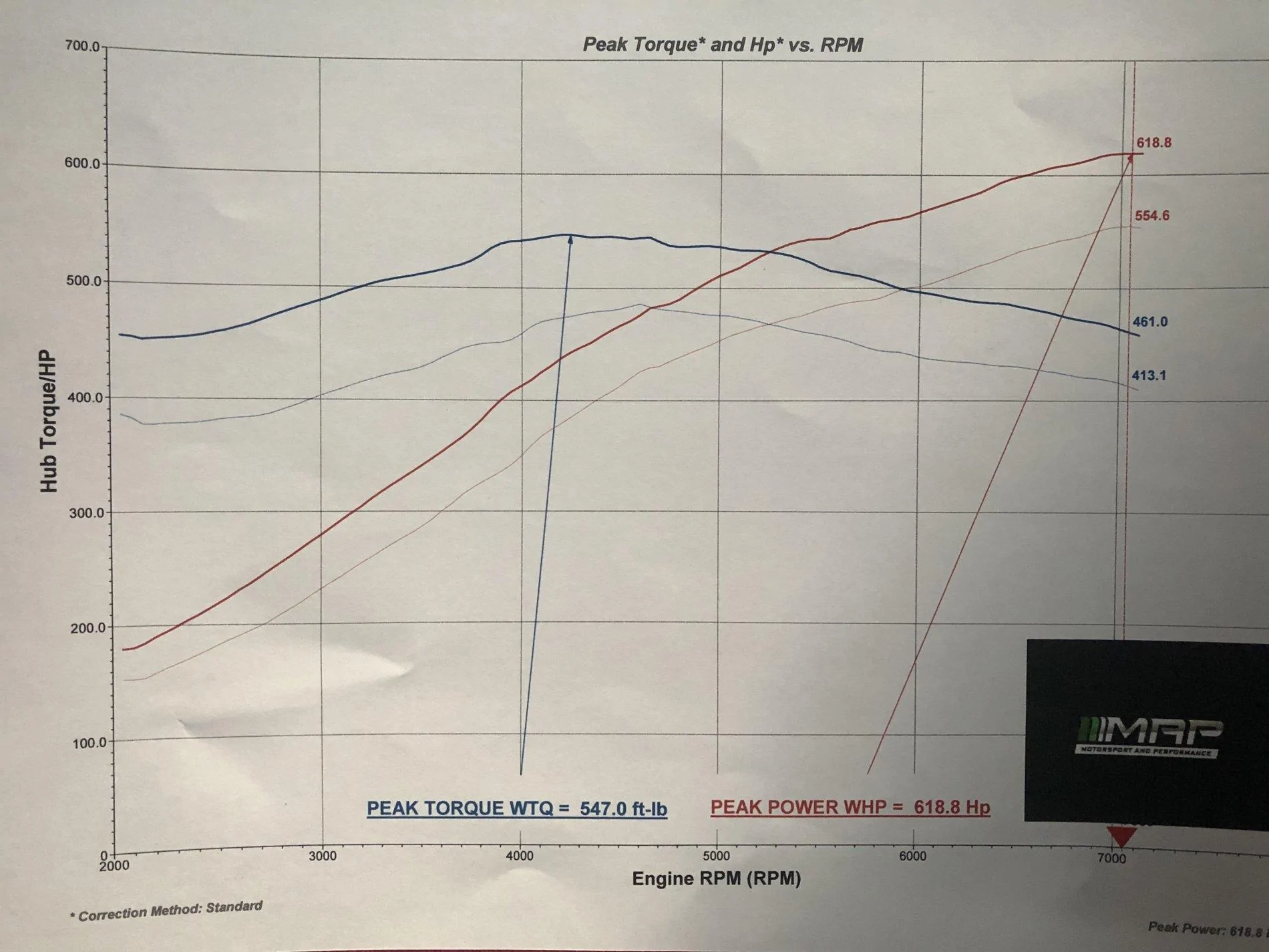

I’m at 620WHP with custom tune. No other mods.
With bigger injectors, CAI, boost a pump and larger throttle body it will see 700whp

Did you Dyno it on the supplied tune? Who tuned it now?
What injectors do you have now? No boost-a-pump I’m assuming?

Every thing is in the kit including injectors etc. Nothing else to buy.
It ran 554whp on the Edelbrock tune.
It does need a custom tune. The Edelbrock tune really is crap but is designed to pass emissions so to be expected.
