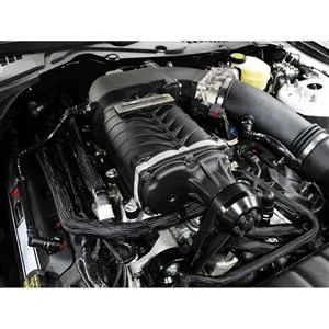

have a roush phase one anyone have a idea of what size the pulley to the left of the s/c pulley is ( i assume thats a guide or idler pulley ) mines looking a bit beat. vmp has different sizes.. i just need the stock size the kit came with .
and belt wise i was told k060806 is the correct size with the stock pulley.
any vendors can help me out id appreciate it.. i dont want to order the wrong stuff and be messed up after i take it all apart ..

ill have to call roush and get one .. the pulley is fine bearing is good i just dont like how it starting to groove from the belt is all . i pmed dave from cj and they dont know the size either .. pulley that is

The pulley is a 85mm and belts is a gates K060806 I have a roush phase 1 also insyalledbit myself know it well

ty. so the one right off to the left looking at the s/c from the front is 85mm ? i know the s/c pulley itself is 85mm ..
im looking for that guide pulley on the passenger side.. not a great pic but its the guide pulley right there next to the s/c

Oh not sure on what guide pulley size is . If the paint or pulley has grooves it does not hurt the belt that is the back side of belt it touches but it is easy to swap out. Just take it off and go to the auto parts store I'm sure they can match it up

The stock Idler pulley on the roush kit is a 75mm, i got the 90mm idler pulley from vmp just to help with belt slipping which i highly recommand if you are at the point of swapping it out and just go with a 90mm, there was no additional modification dont just unscrew, untention the belt, and screw the 90 on.

thanks man the belt i got from my the parts company we deal with .. and i can use the 90mm with the stock belt .. sweet
just ordered the 90mm thanks

Did u actually get any belt slip with the stock 75mm idler pulley? And with the 90 mm installed can you tell a difference under hard acceleration
