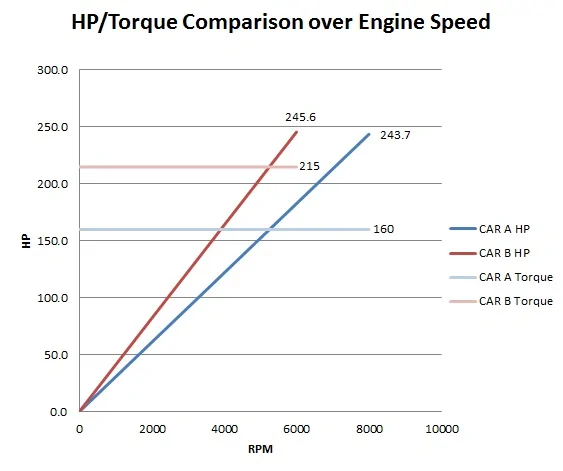

Well, he's talking about perception, and according to him humans are more sensitive to jerk (the rate of change of acceleration) than we are to acceleration itself. He is also saying that for portions of each gear, you actually do have more "torque at the wheels" and therefore more acceleration in the Scat Pack than you do in the Hellcat. So, couple that momentary burst of higher acceleration in each gear, with more frequent gear changes, and one can understand where he is coming from.
Regarding HP, your "net torque" example is actually talking about HP. So in a way you are agreeing that HP wins races (of course it is really the full HP curve, not peak HP, which is why this gets confusing).
The reason your example seems to show that CAR A is faster than CAR B is because your math is wrong. They don't actually have the same speed at the top of first gear. The reason CAR A seems to have a torque advantage in your example is because it actually has shorter gearing. With corrected gearing, CAR B is actually faster (it makes more power and because of that, more torque at the wheels). And this is always the case: Assuming two cars have equal gearing (this means gearing that makes them run equivalent speeds at the top of each gear), then the car making more power at a given MPH will also be making more torque at the wheels. In the example with constant torque, this is easy to see. In reality, it is actually the integral of the power over the RPM range (hence why people talk about the "area under the curve"), so things aren't so simple, since a car making a higher peak power may not be the one with the higher total power.
If you use correct numbers in your example, here is how it looks:
CAR A = Peak HP of 243.7 (160 * 8000 / 5252 )
CAR B = Peak HP of 245.6 (215 * 6000 / 5252 )
CAR B is making 0.78% more HP
Since both cars are making constant torque, the HP "curve" is just a straight line from 0 to those values when plotted against engine speed.
In order for both cars to have equal speed at the top of first gear the actual gear ratios are:
CAR A = 3.7, 4.1
CAR B = 3.3, 3.4477...
With those ratios, the torque output is:
CAR A = 2427.2
CAR B = 2446.2
CAR B is making 0.78% more torque at the wheels (the same as its HP advantage).
Incidentally, if CAR A had a torque output of 161.2, everything would be essentially equal between the two. Same peak engine power, and same torque to the wheels over the RPM range.

Wow. You took the example a little far. Net torque still isnt hp. I completely disagree. it doesnt need "corrected gearing". i chose that because it was simpler for most people to understand. Im not going to have some drawn out math class here. You feel youre right. I feel im right. Have a good night.

The entire reason people calculate HP is because it is a value that shows how much torque you can make through gearing. HP actually does win races, if the car is geared correctly to take advantage of it, and it has sufficient traction, etc.
The real answer to a lot of this is, it's complicated enough that it exceeds most peoples' attention spans.
