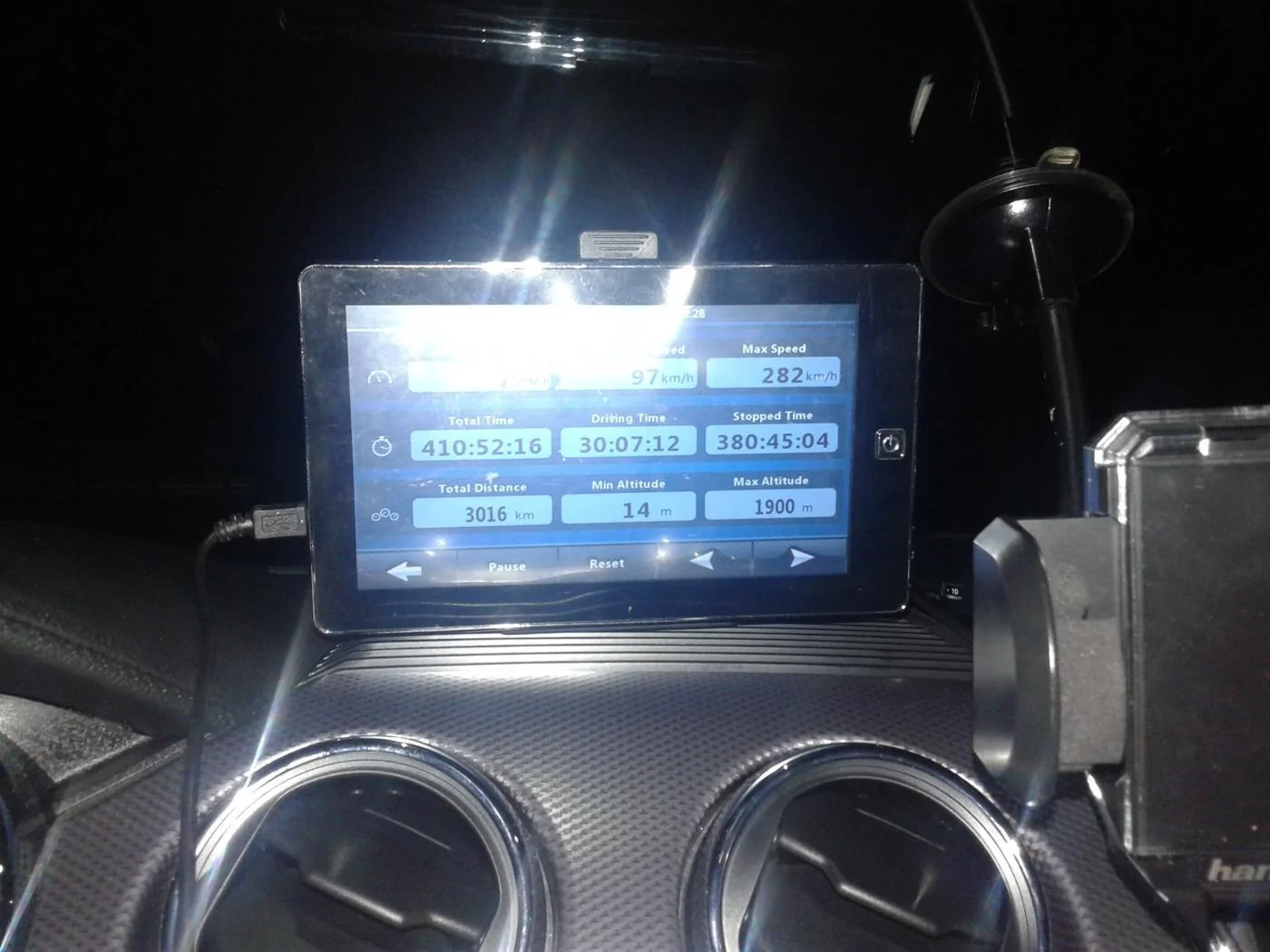

I can respect what you are saying, however there are no roads in the US where someone can travel at those types of sustained speeds. Even in Florida, there are an abundance of police state, county and local. Not to mention all of the wildlife that you could..."meet". If we were talking about a race application I would definitely agree with you. For a road car that is not as lucky to have your roads like you.
I agree that the speeds I do on a daily basis are impossibly dangerous in the U.S. but even sitting in traffic I find the oil temp consistently in top 3rd of the gauge while water temp remains solidly in the middle. I do agree with you that on the track with the stock radiator it would be a close race to see what over heated first, oil or water, but I'd be willing to bet that the oil temp would red line far more often than water. I plan on getting the Mishimoto coolers for both after I go big turbo.
