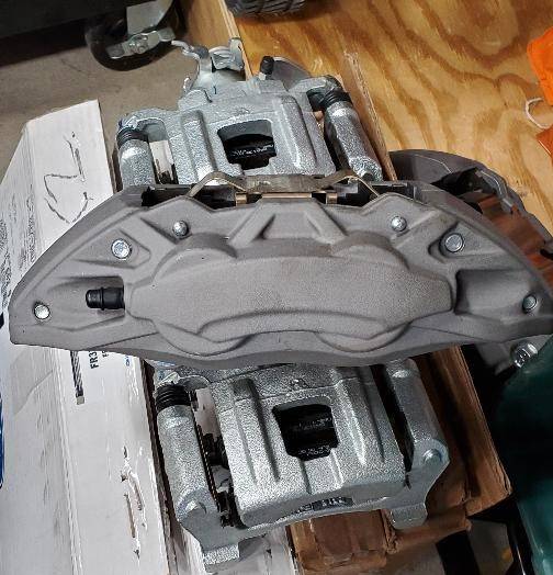

I have 17 eb premium, non pp. I have a lead on cheap base gt 4 pistons off front brakes / calipers with low miles on caliper/pad.
What else do I need? New rotors etc? Do I need a new master cylinder?
is it pretty much direct swap or is there more to this than you’d recommend doing?

Calipers and rotors.
MC is not required.
direct bolt on.you will need the PP brake lines with the calipers if the new calipers are bare.

The rear brakes are the same as yours, so no need.
If the take offs come with brake lines you are good.
You cannot re use your non PP EB lines since they are different.
EB PP and base GT use the same brakes.
If you want to upgrade the upgrade, get stainless brake lines. They are $200 for a full set.
But OEM works just fine.

I did the same swap on my '17 V6 car. The rears are the same except the GT rear rotors are vented. I did the rear swap on my '17 just because I got the new take off setup really really cheap and it allowed me to have time to paint the rear calipers without down time....
Just order new GT front brakes hoses. I used Raybestos parts from Amazon / Rock Auto.
The braking difference between the base GT 4 pots and the stock V6 / EB 2 pots are RIDICULOUS if you get decent pads.
If you have an air compressor hit up Harbor freight and get a pressure brake bleeder setup for cheap. Works great. I've used it a ton and it's much less work than the MityVac I used for years.

Thanks everyone! He has the front brake lines and dust shields included, so that means I could probably forgo needing lines completely

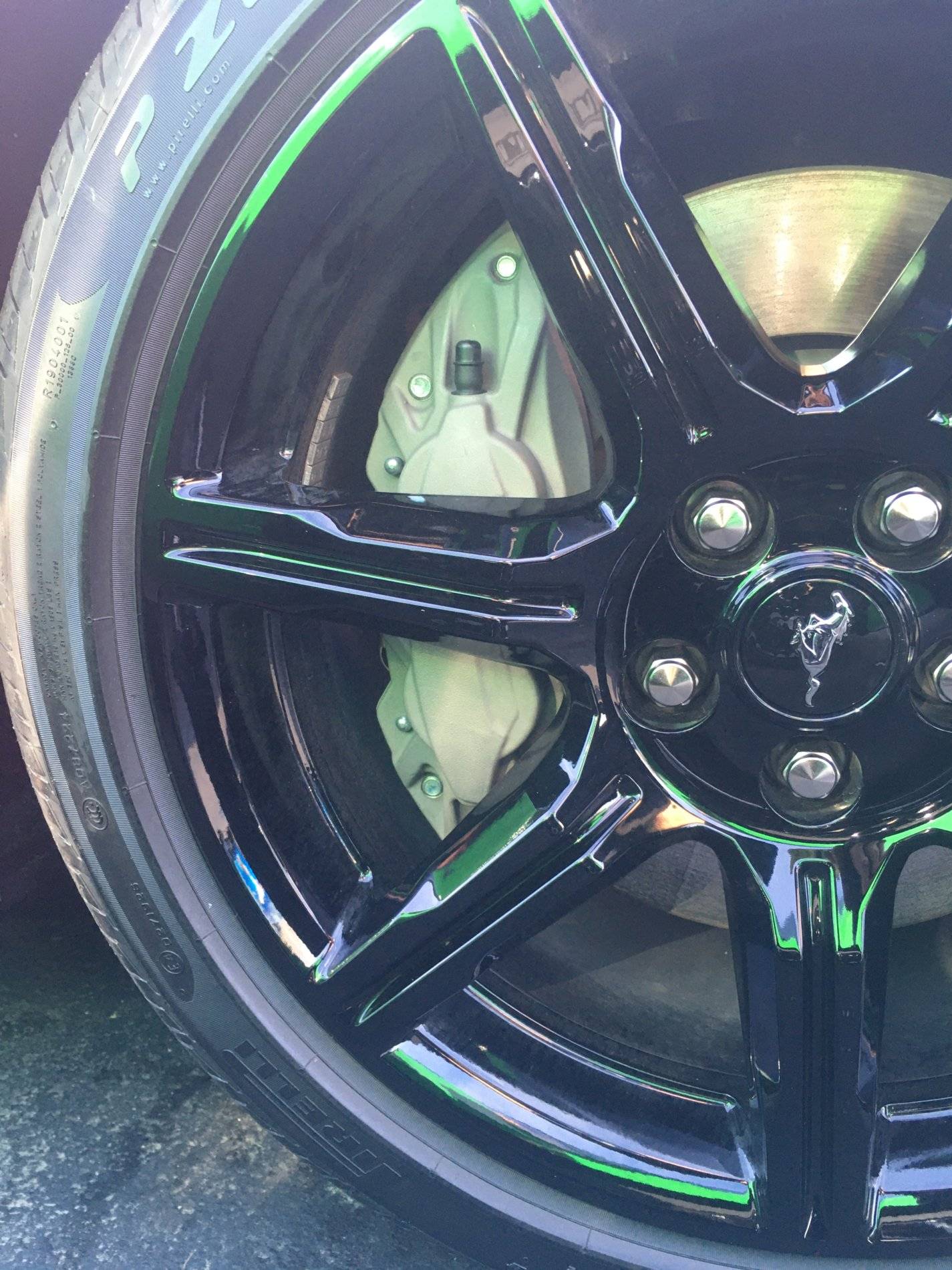

I went to dealership, why are some of the 4 piston caliper cars silver in front, and others are like dark grey or black (not talking about Brembo)
two examples. Same car, same generation. I’ve seen several cars w darker brakes and some silver
