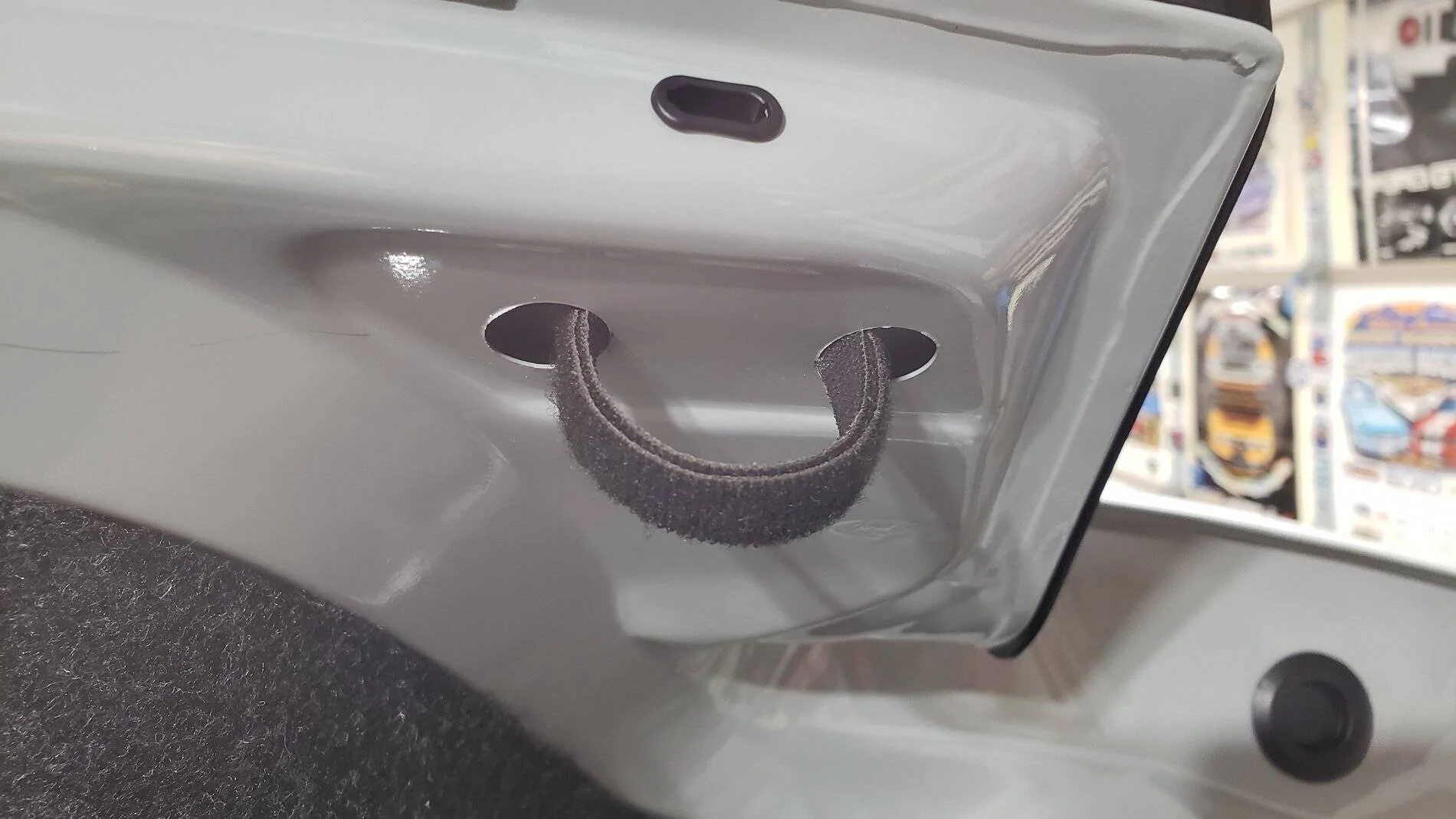

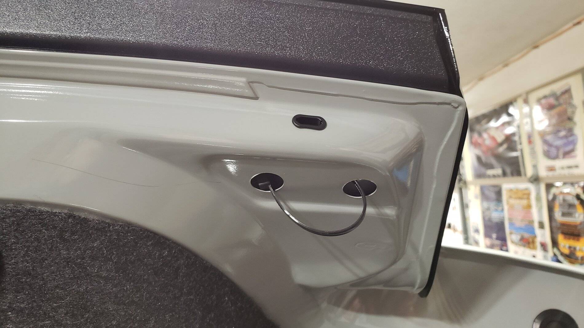

Easy trunk handle. Just use a zip tie. The rear panel is even softer than on my 2018.

that zip tie is going to wear the paint away wherever it rubs every time you pull down on it.
If it does you cant see it from out side but you can see the marks on the rear panel. You could use a soft Velcro loop like for wires.

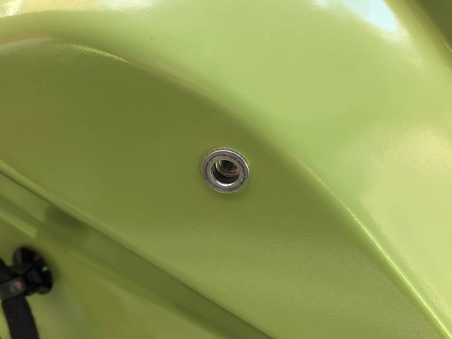

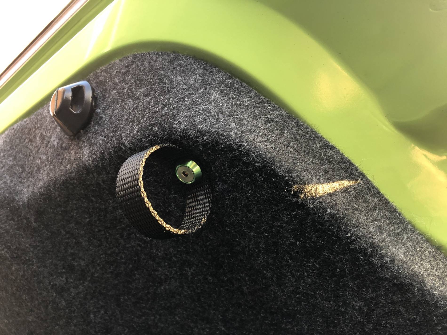

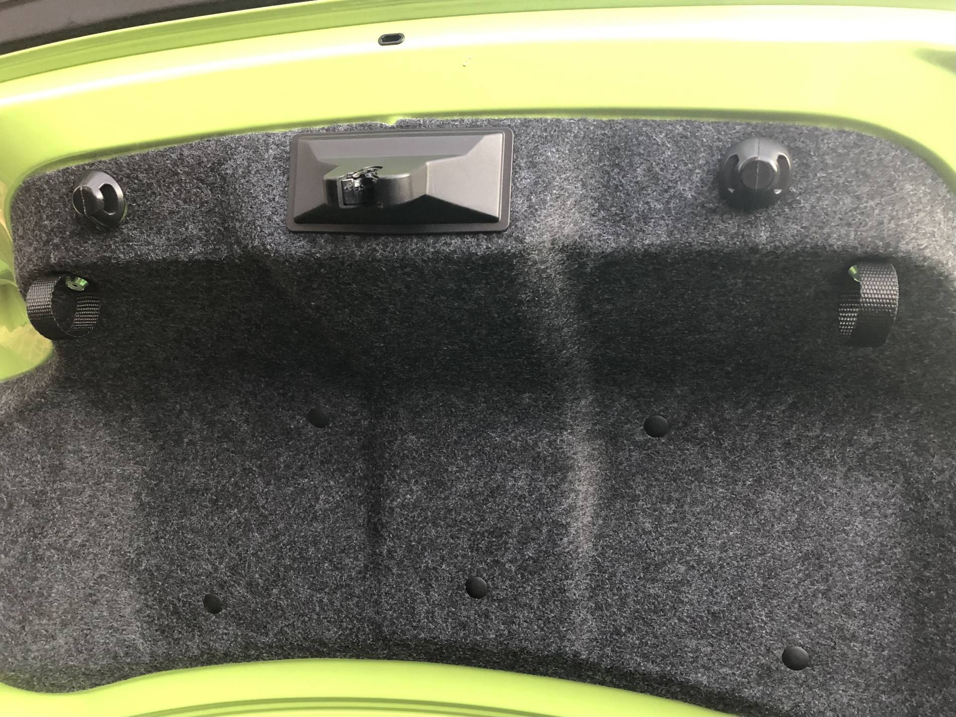

Here’s another option for you - replace the push pin with a M5 rivnut. Colour code the washers to suit your car :

WD has a better idea. Nice did you put in the nutserts?

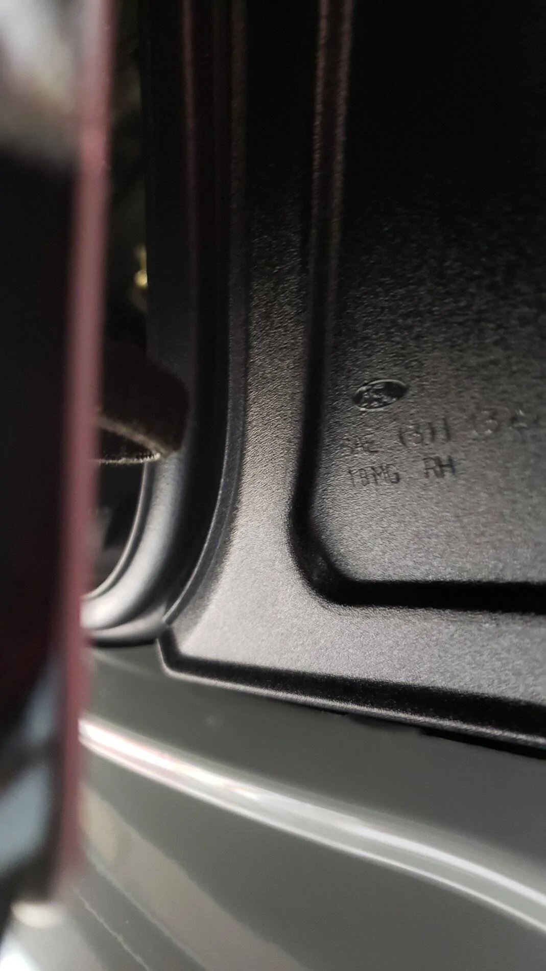

FYI this is the area it will rub on.

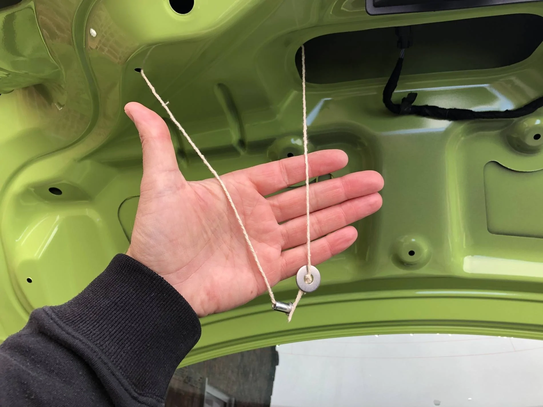

I did, an M5 insert fits the push pin holes perfectly and I put a penny washer on the back to spread the load - the washer took a bit of fiddling to get in place :

If you pull the trunk down and touch the black rear panel it scratches.
