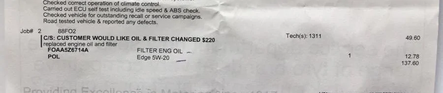

Also, I just found out (From my invoice) that the Ford dealership filled her with "Edge 5W-20" when I asked them to change the oil at the complimentary service. That was on January 2017, a good few months after the Ford manual I have in the car was printed, and clearly says 5W-30.
Yes, I can really see their commitment to me
"Feel at ease knowing that your car is being serviced by factory trained technicians using specialised diagnostic equipment. After all, nobody knows your Ford better than we do!"

Yep definitely - Here's the relevant part from the invoice.
Plus, $137 for oil is VERY rich. I wish I knew then what I know now...
I think the tech price and oil filter price are really good value tho

At my 3,000 km inspection and oil change, the dealer put Edge 5W-20 in it according to the invoice. I'm not going to stress over it, I don't race the thing and its still the recommended oil by Ford US. At the end of the day, the dealer put it that oil into the engine, its on them if it causes damage.
