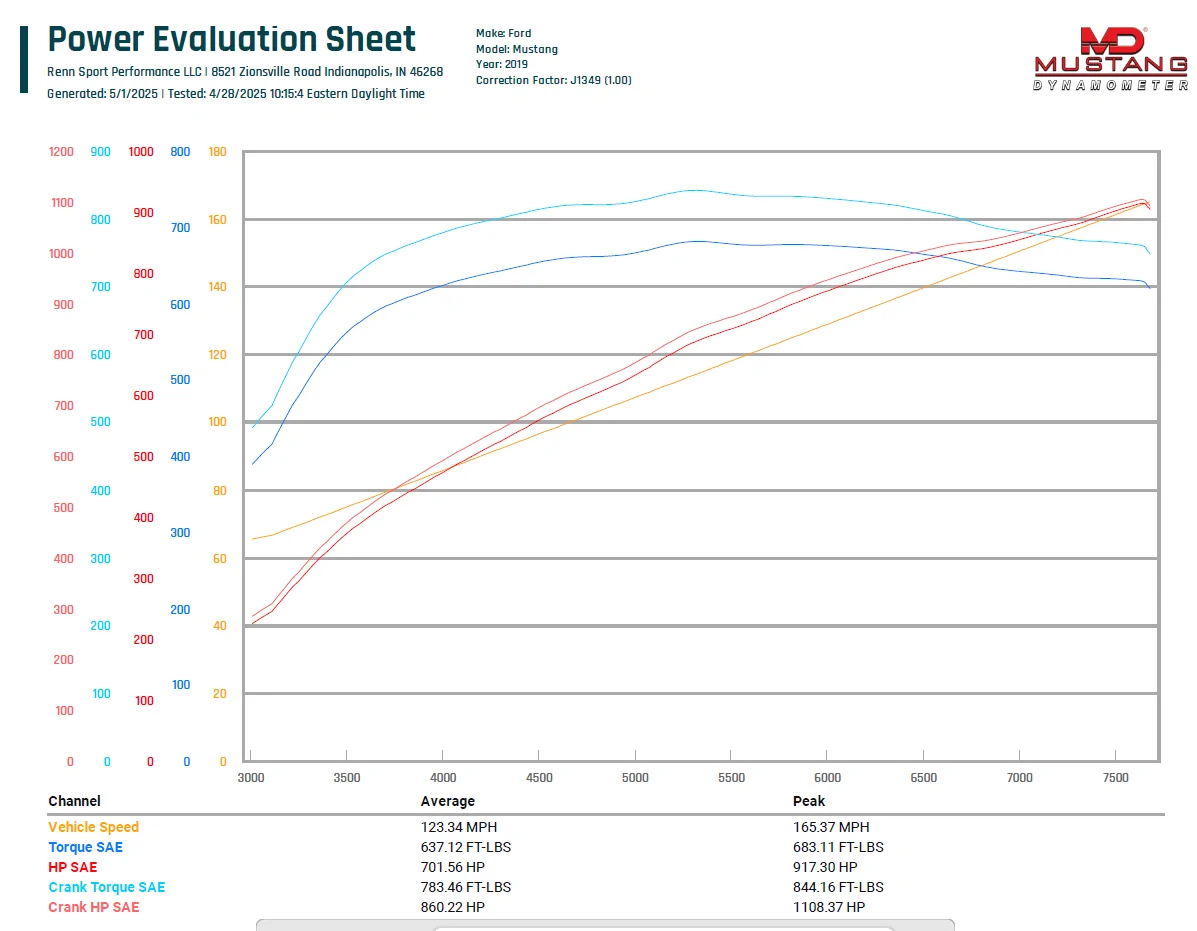

What was your RWHP? Also what injectors are you using?

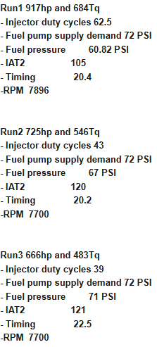

My RWHP was 917, 683 TQ, Crank HP was 1108 HP, 844 TQ. NOTE: My limitations to my KPM 1500 with PCM is Engine Crank HP, Not Rear Wheel HP.
- My injectors are ID1050X.
- 1st pull was with Smoothboost at 100% Max setting
- 2nd Pull was Smoothboost set to 50%
- 3rd pull was smoothboost set to Minimum
