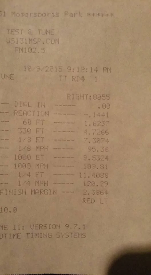

Here's my example of running E85, from last night in a 3,860 lb S550.
[ame]
