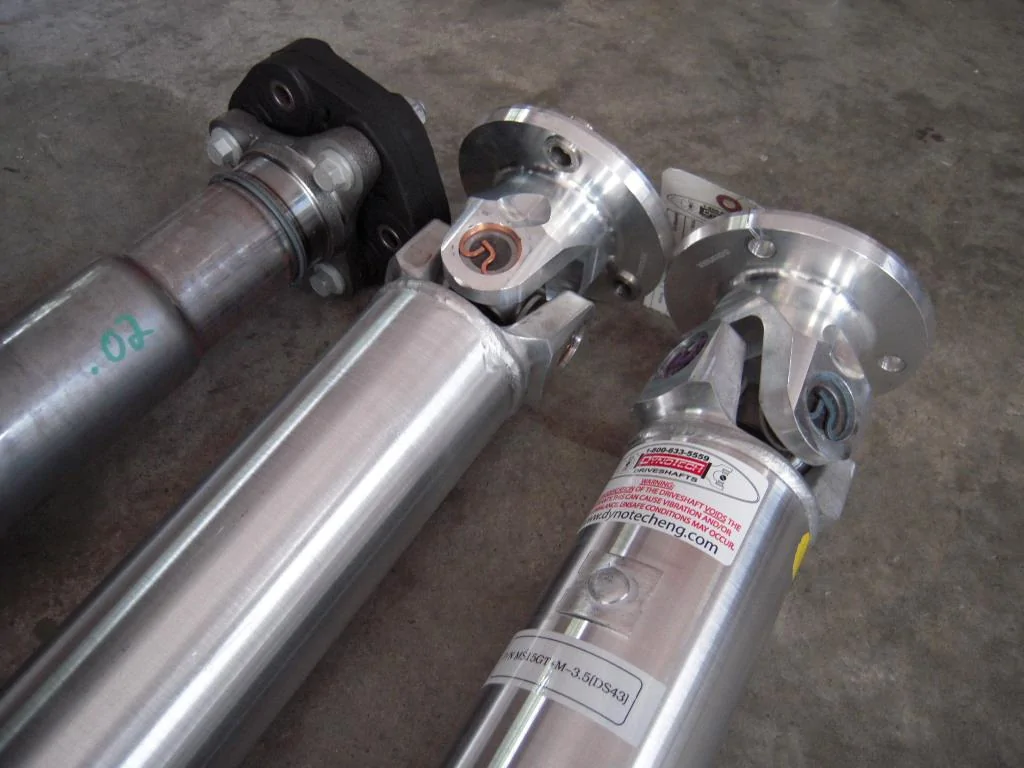

Dusting off this old thread... replaced my shaftmasters with a dynotech today. The shaftmaster just did not want to run smoothly.

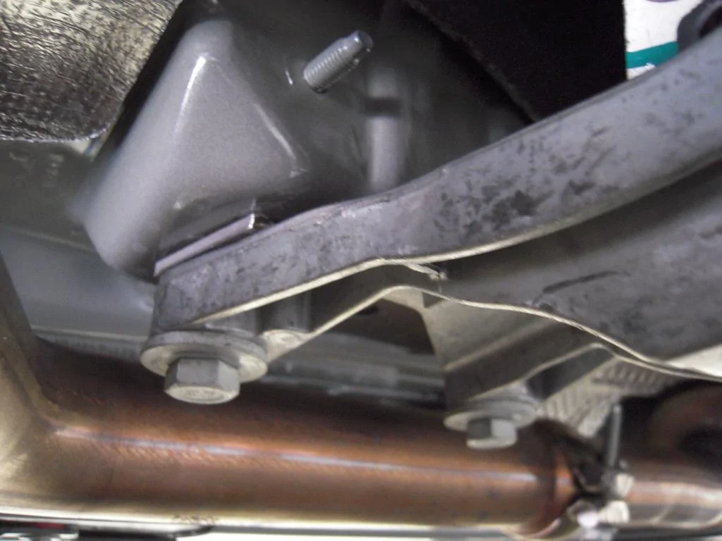

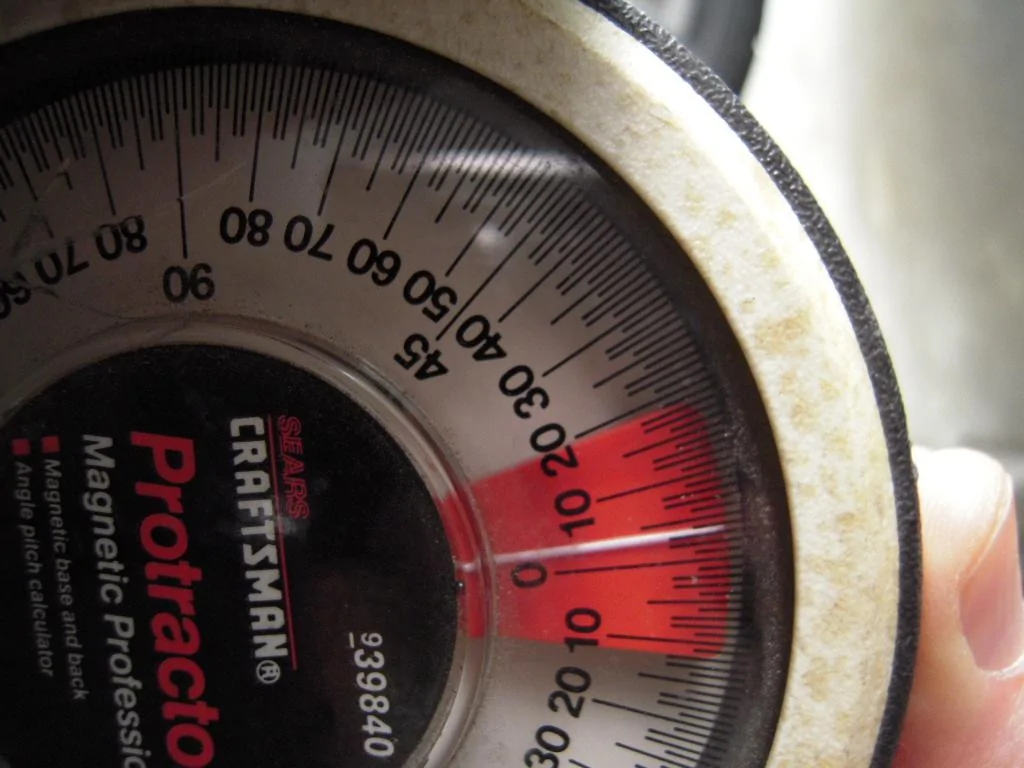

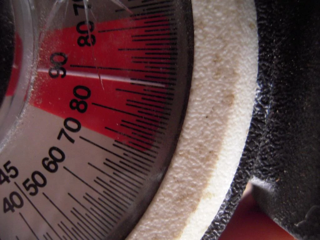

Motivated by the vibration thread and the recommendation of BMR and others, while I had the shaft out I took some angle measurements - the stock pinion angle was +3.5 degrees while the transmission output was only -1.5 degrees. By adding 1/4" shims to the transmission mount I was able to get another degree down. Ideally they would match, but I wasn't comfortable adding even more shim, and didn't want to shim the subframe (at this time.)

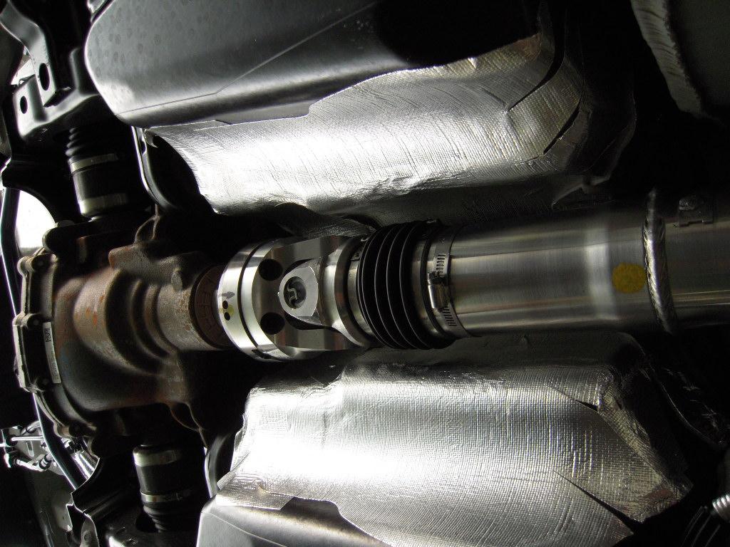

The dynotech has yellow paint splats to mark the heavy side, so I lined it up with the yellow splat on the pinion yoke where the factory weight has been removed. Immediately it was 200% better than the shaftmasters shaft. I monkeyed around with a hose clamp trying to get it glass "perfect" but couldn't beat having no clamp added at all.
As far as differences between the shafts:
stock 34lbs, dynotech and shaftmasters were both 18. (all +- .5lbs)

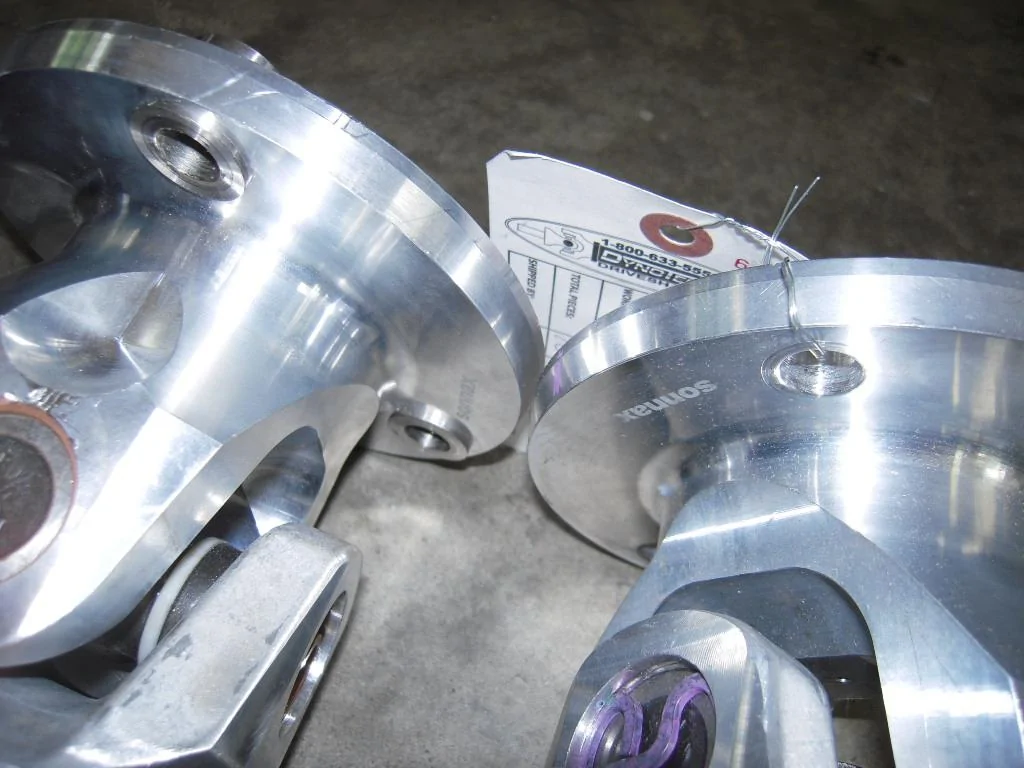

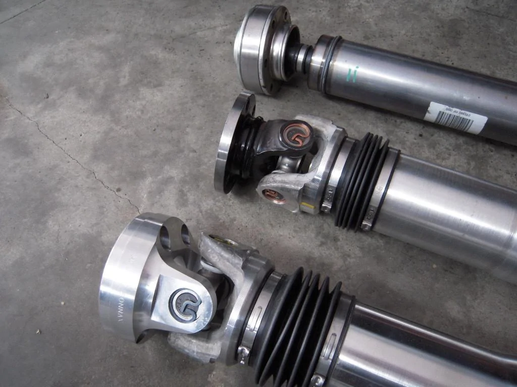

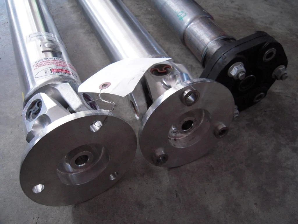

The shaftmasters uses a steel pinion yoke mount, while the dynotech uses a billet mount. The front mount on the shaftmasters uses 3 locating pilot bolt nubs where the dynotech is simply flat on the front face. Both mount snugly on the pilot from the output shaft.
The shaftmasters shaft came with 12pt 10mm bolts, a tap and a useless 10mm socket. The dynotech uses female hex head hardware which is much easier to work with, but does use two pilot bolts to locate the rear mount, making it the more difficult of the two to try clocking (if needed.) Someone recommended 8mm and 10mm long reach ball head allen/hex sockets - those worked great.
Both shafts are nice pieces with great craftsmanship. Is the dynotech really worth a couple hundred over the shaftmasters? Ehhhhh... not so sure.

Just installed the Dynotech. I didn't realize how easy it would be to just shim the trans mount, and I also didn't want to just shim the mount without taking angle measurements first. If I had to do it over again, I would have just tried shimming before taking out the shaftmasters. You don't need to drop the exhaust or anything- probably a 20 minute job to try it.
You do need to note that the trans mount has a metric ton of left-right adjustment to it, maybe even .5", so keep an eye on that if you loosen it up to install shims.
