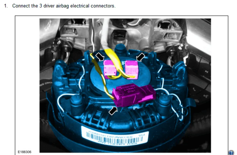

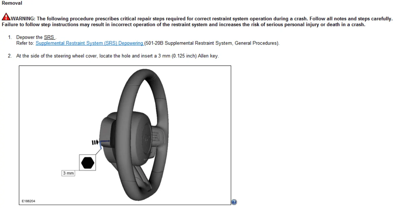

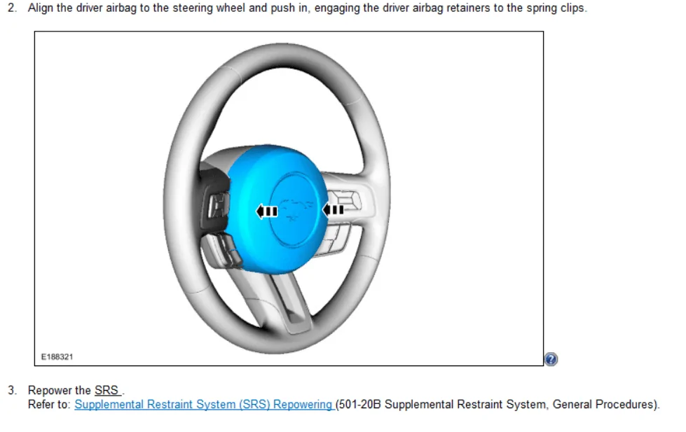

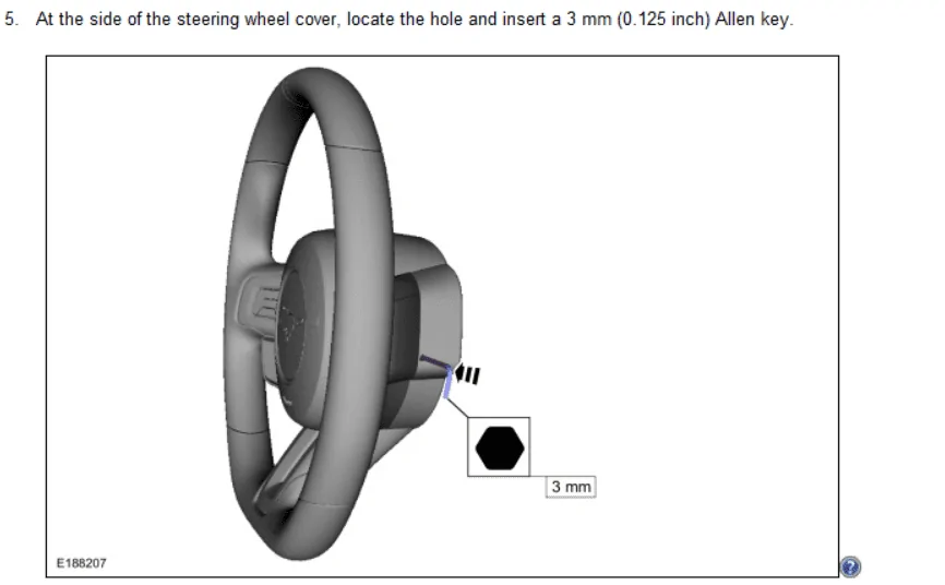

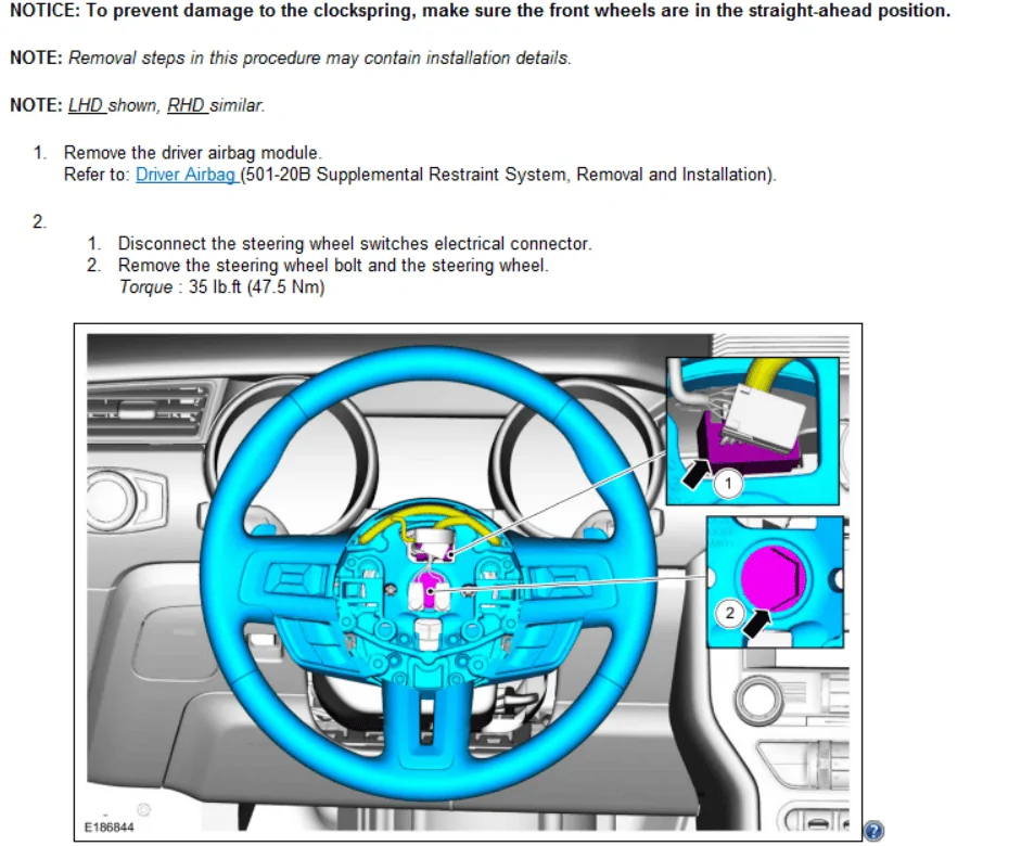

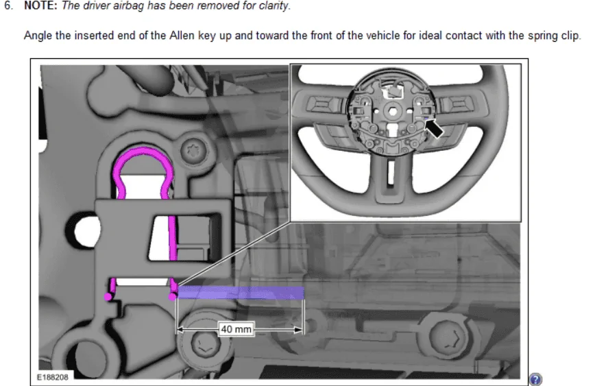

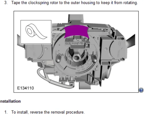

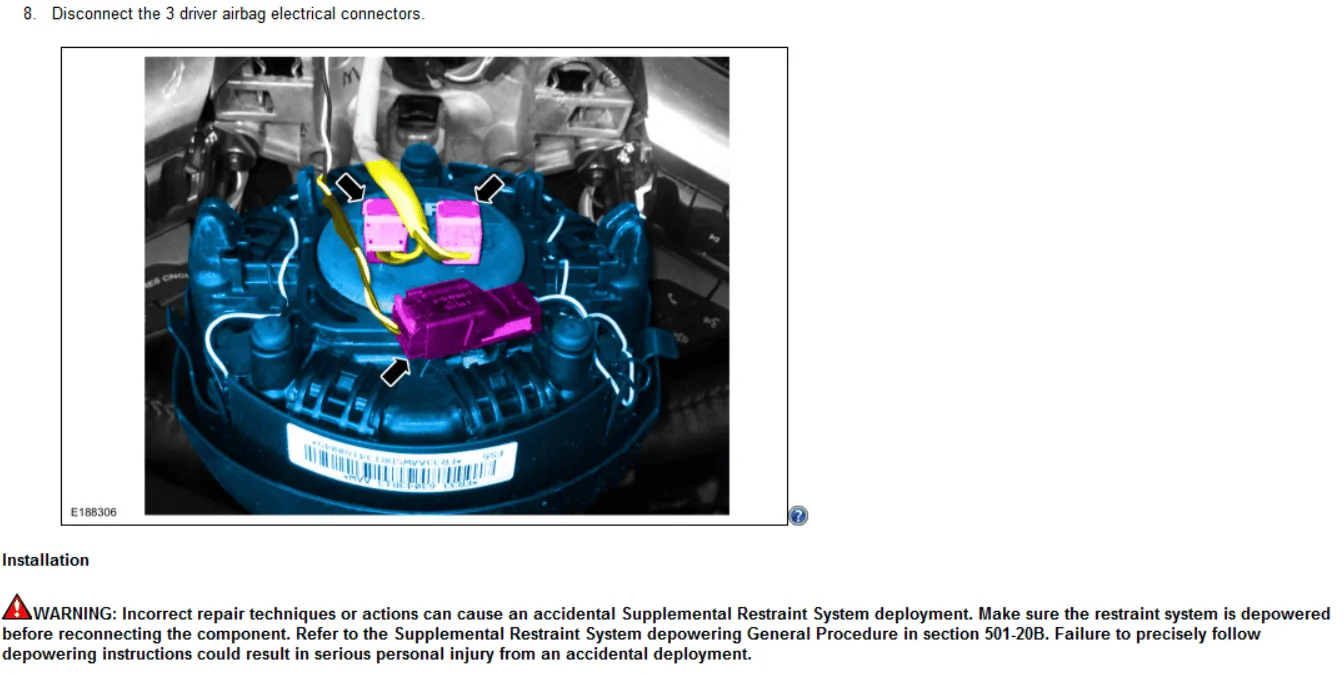

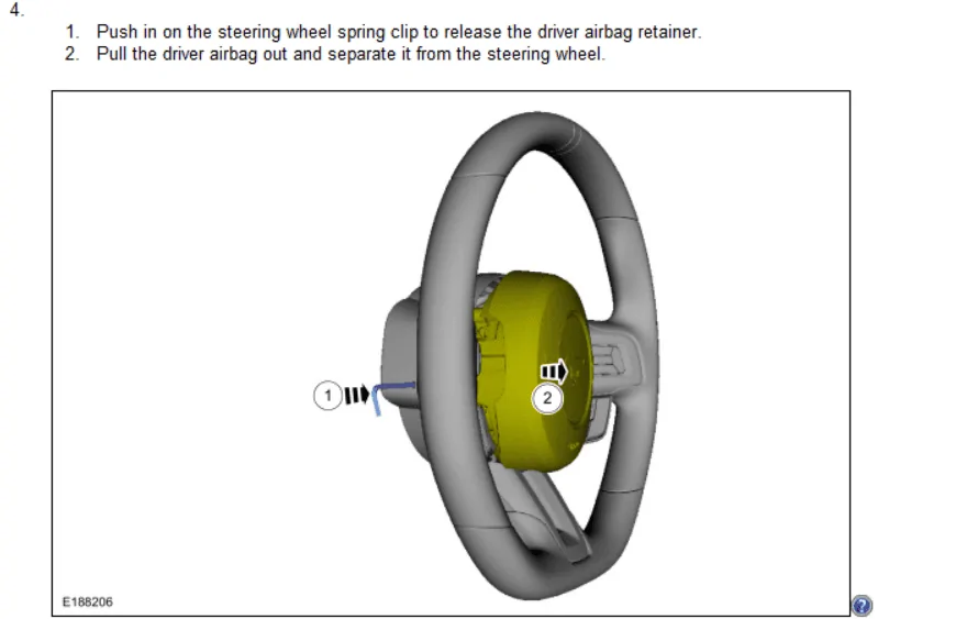

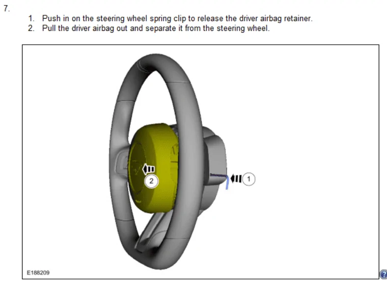

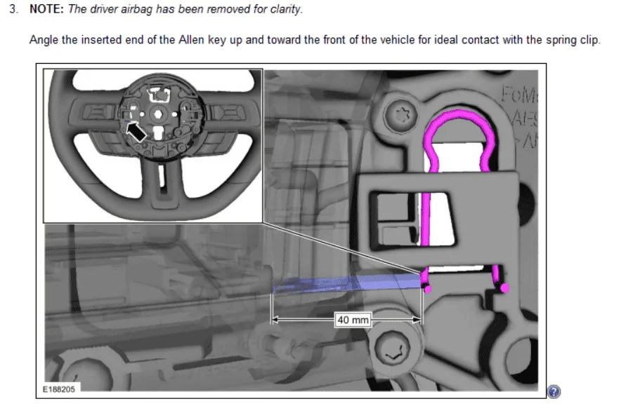

Here is the directions for removing the steering wheel, SRS Airbag ETC. "Always make sure you disconnect the battery first"

2019 GT Premium A10 PP1 Whipple Stage 2
Here are the pictures if you cannot open word doc
