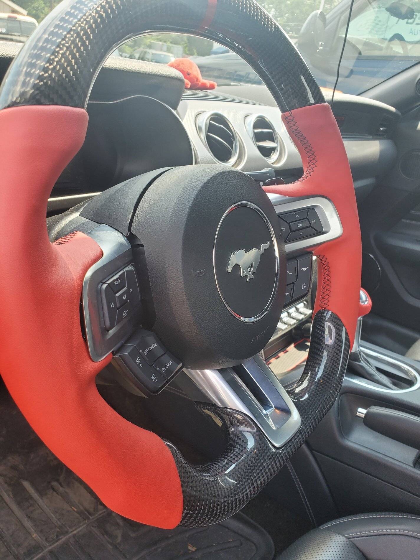

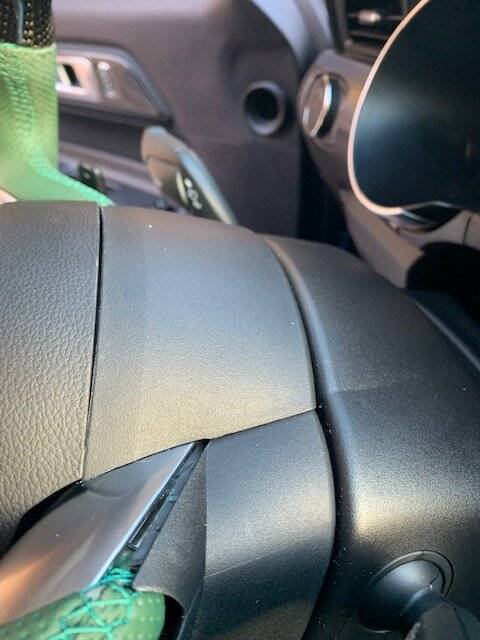

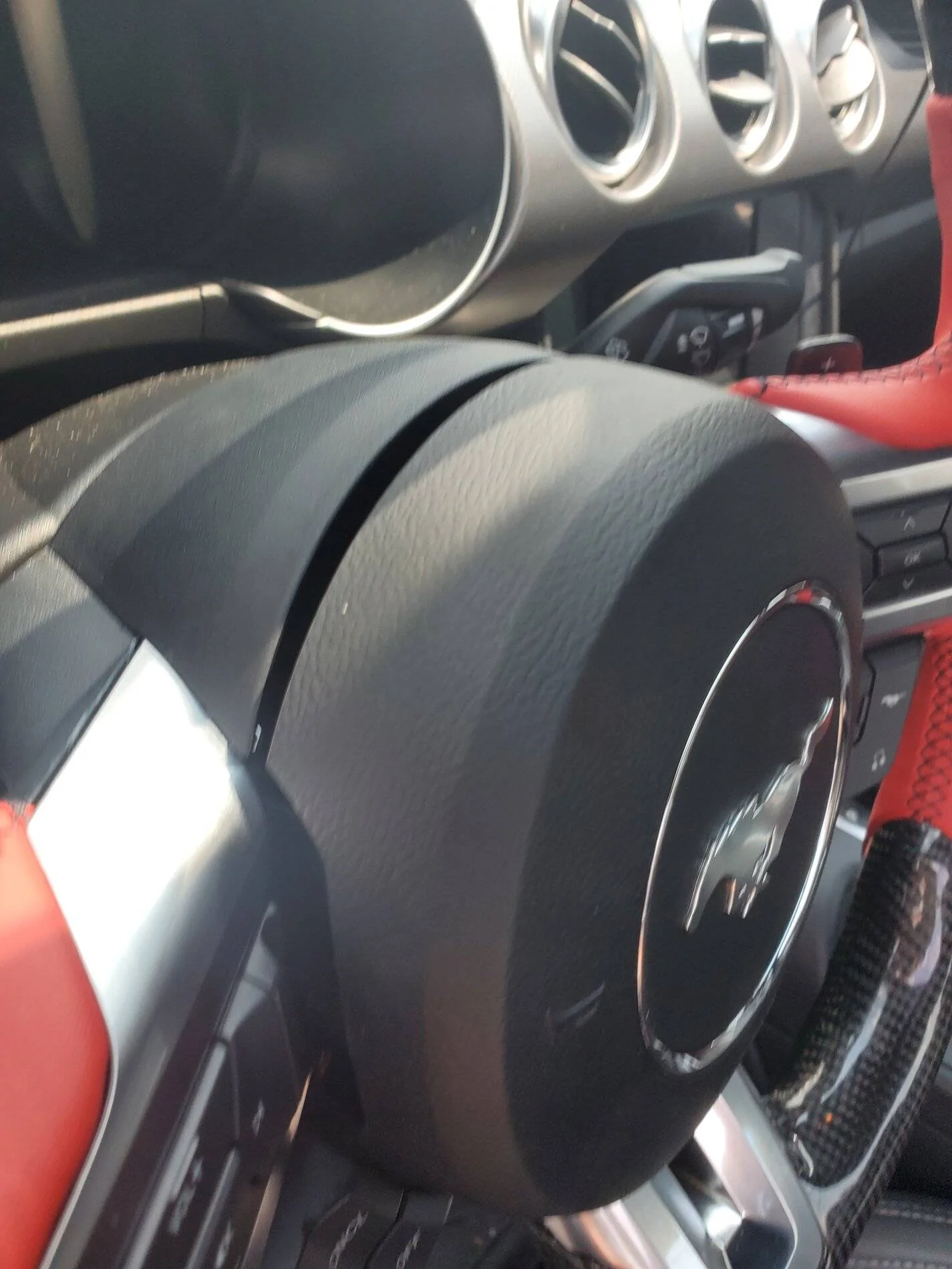

The wheel is a complete bust. Went to go pick the car up from the shop and they showed me that it doesn't fit flush at all with the OEM parts. The center portion with the airbag and horn was the most concerning as it didn't snap into place properly or sit flush with the wheel. The technicians stated that the wheel seemed warped and poorly made and that they tried for a good bit to make it all work. They also stated that for an older model, steering wheels like these have a good chance of actually fitting, but for a newer model, it's not a good idea due to how they are made.

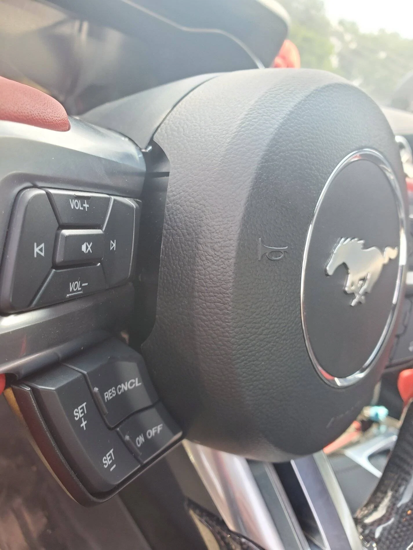

I bought a wheel from here as well, it wasn’t the heated option but had the same fitment issues. The airbag would click into place just didn’t sit flush on the wheel, I figured I had bent something and chalked it up as a learning experience. But now I’m not so sure. I can deal with a trimming or adjusting a part to fit, but it’s another level with airbag safety. I’ve emailed as well, hopefully the correct this one way or another.

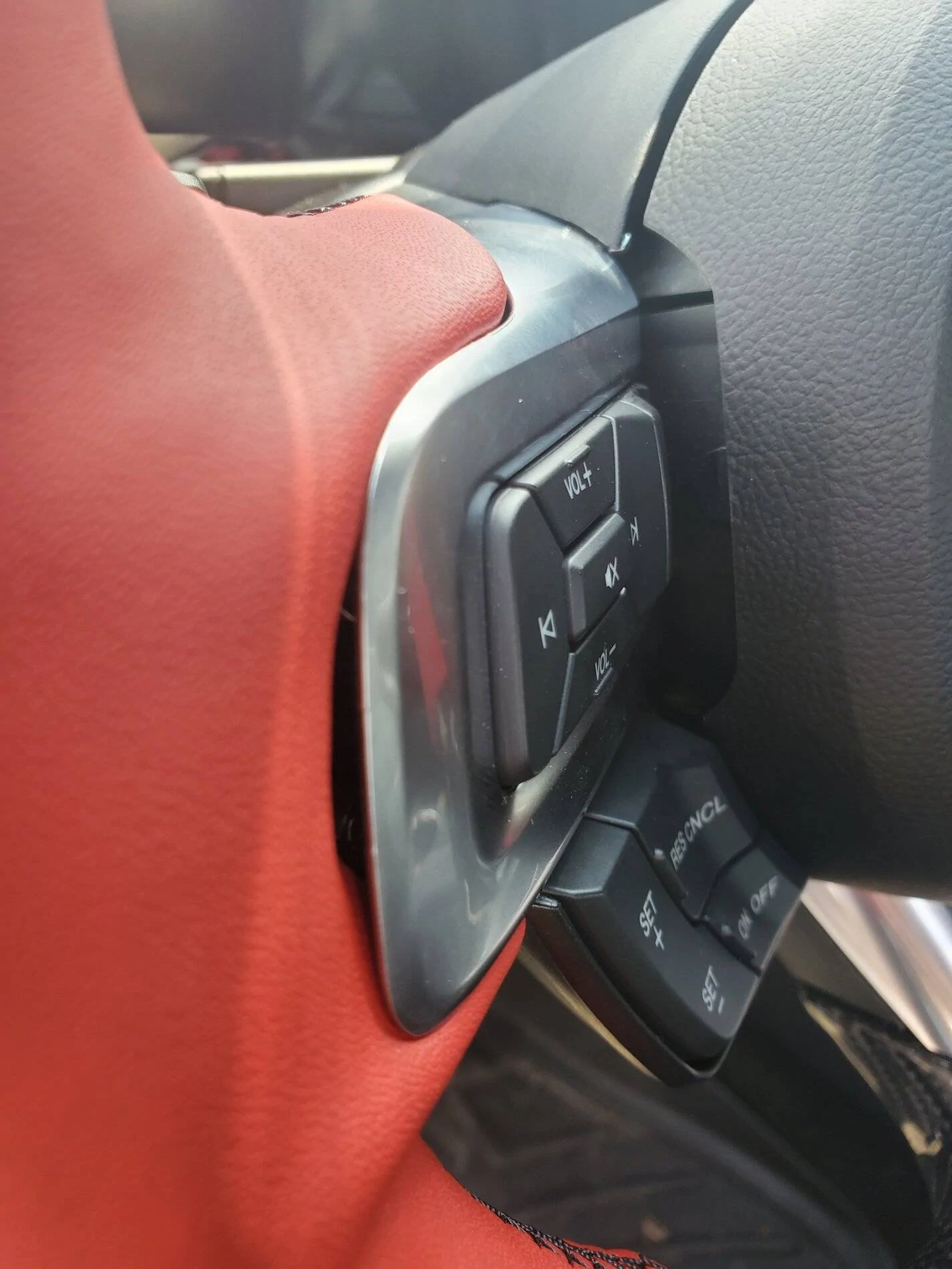

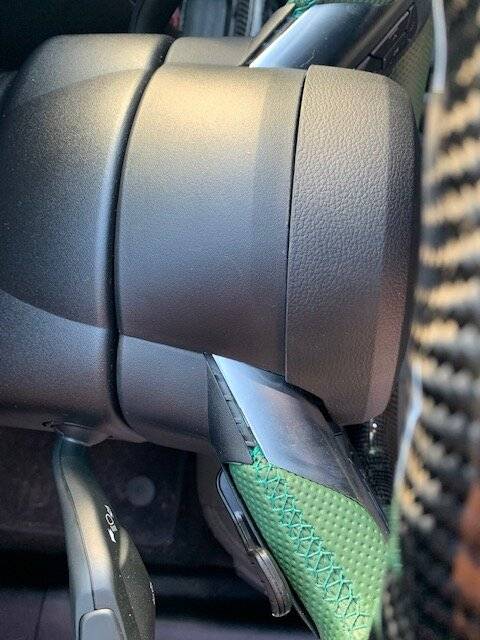

Are you having trouble getting you paddles to sit flush as well? Mine has this annoying click now and no matter how hard i tried can't get them to line up like factory wheel.

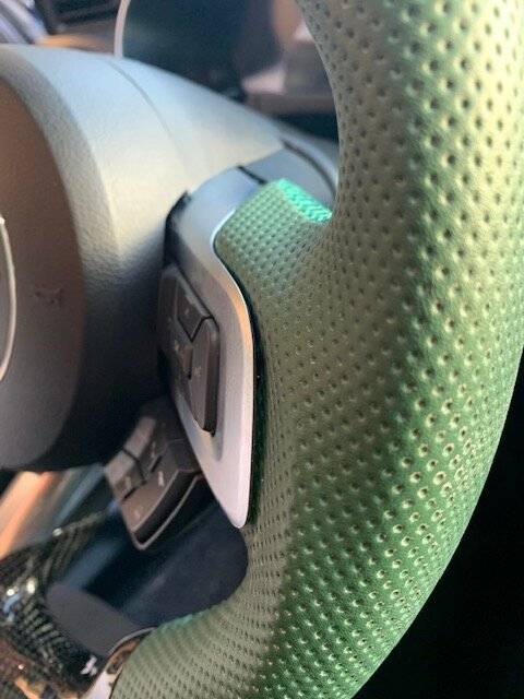

I didn't notice the issue when I initially checked, however, looking back at the photos I took, it doesn't seem like the paddles were flush. Just huge gaps everywhere between the OEM parts and the wheel.
Side note: that green color is so nice! Would've looked great if the wheel actually fit
