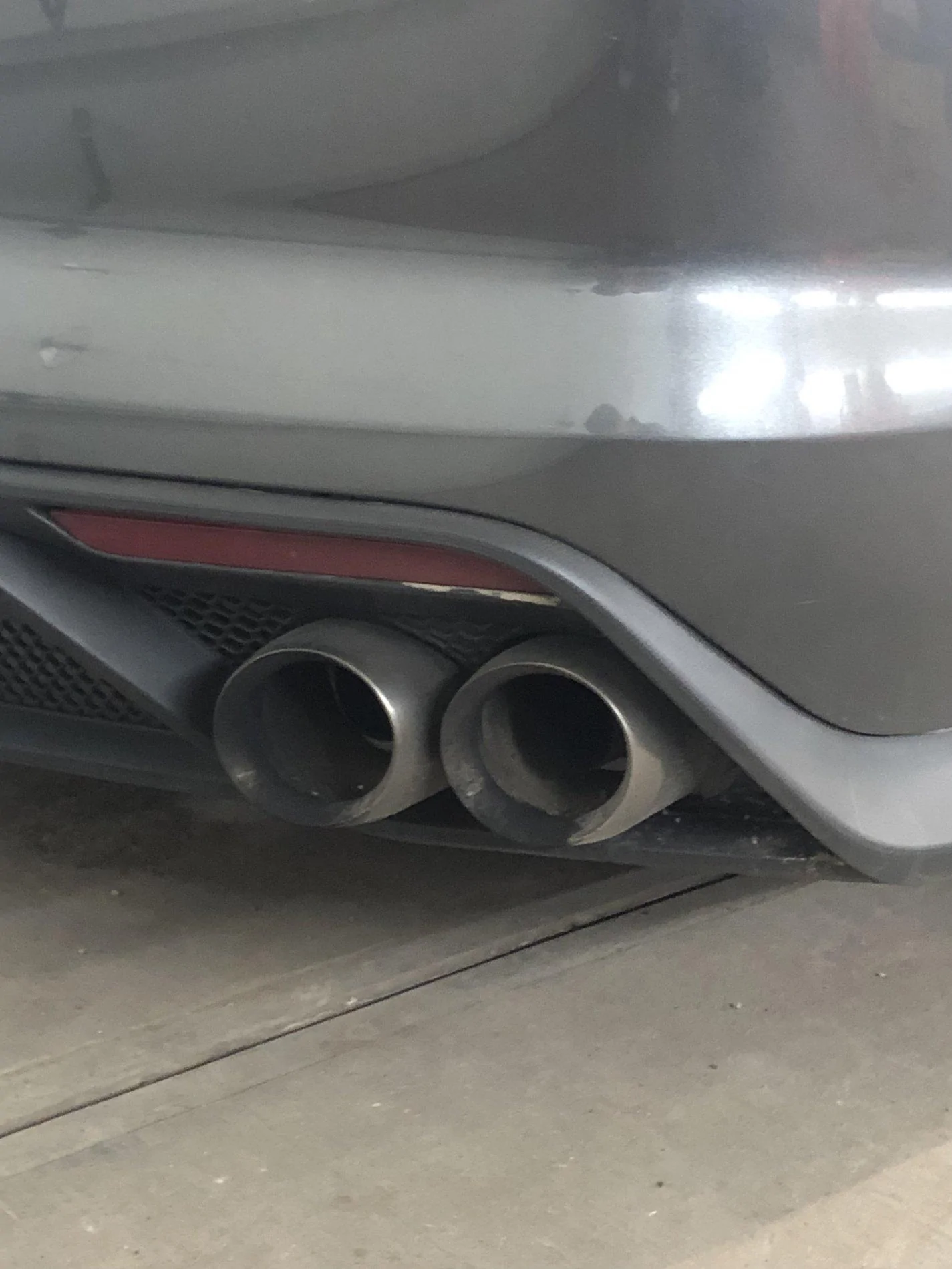

Hi All,
My mustang came with a GT350 exhaust that I hate the sound of behind the hellion kit. Thinking of going the rough axel backs. But just before I clicked order, I noted I have dual tips each side and I can not find a roush option...
Any idea on what to do

Cut the tip on your new mufflers and either run it like that or get a shop to weld a Y from it to the two tips on the valence.

If you want to go single tip, you're going to have to replace the lower valence. Those "tips" are attached to it, not the exhaust.
You could order the 18+ roush exhaust. I'm pretty certain there were not changes on mounting points between 15-17 and 18+. You will still need to modify either the exhaust by cutting off the tips, cut off the faux exhaust tips on the valence, or get a new valence. Personally, I'd cut off the faux tips. Never have cared for that look.
