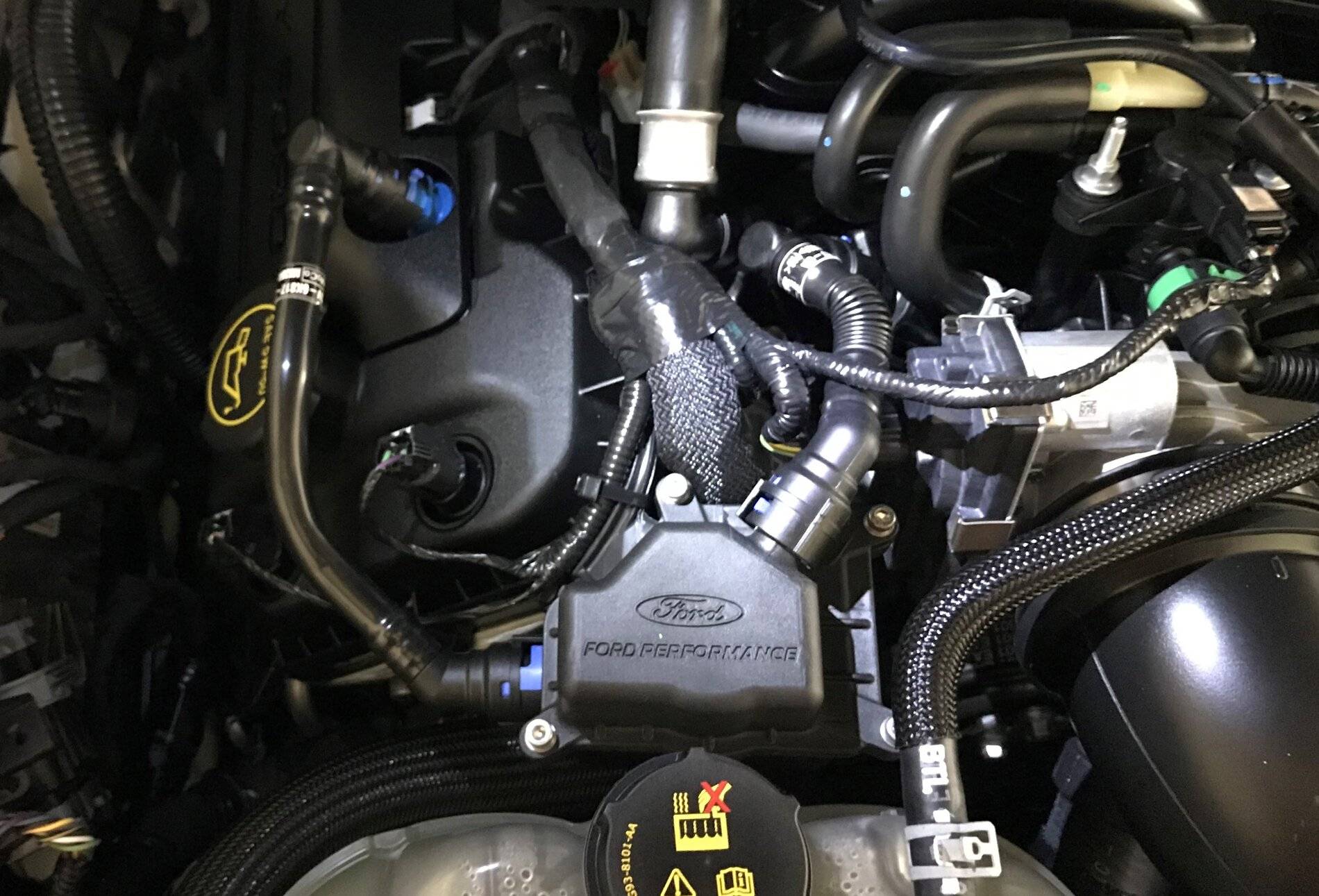

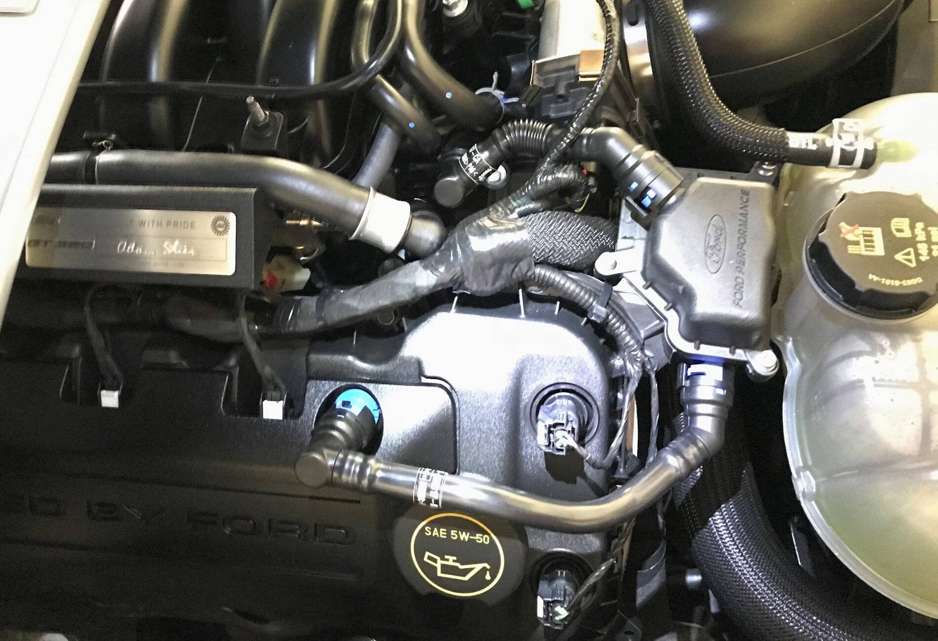

I just installed the Ford Performance Oil Separator - passenger side - on a 2020 HEP. I can guarantee that short hose is not designed for this setup. You can make it fit, but it takes some effort.
Pictures ?

Didn't think about during install (should have) but here are a couple after install.
Which hose do you believe is an issue, the 1 from the valve cover or the one to the intake?
Sorry, just reread your post. The small hose going to the intake is corrugated for this exact reason, to be able to bend sharply, so it’s totally normal for it to feel “wrong “

Yes - the intake/corrugated. I know it's supposed to be flex fit, but it is almost to the point that you can damage the part trying to get it to fit. Just wanted others to know when they're working on it.
