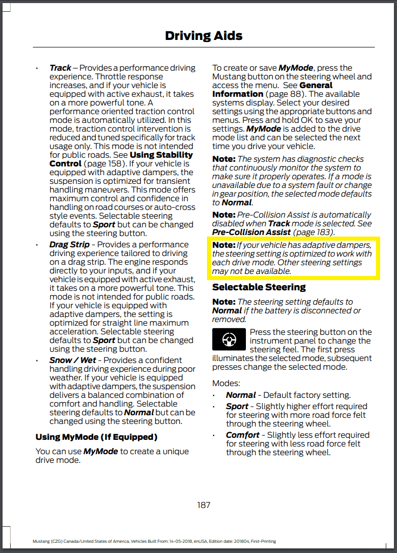

My understanding is those without MagneRide can mix and match drive and steering modes, but for some reason springing for that option means you're locked into certain steering modes most of the time. AFAIK I can only change the steering mode when my drive mode is in Normal. (Which it never is so my steering mode switch is essentially worthless. Grr.)

It is a Magneride thing. Cars without it can mix any steering mode to any drive mode.

Yeah, so my '19 GT/PP/401A/MagRide car does disable the Steering Mode selection on any mode other than Standard (i.e., Sport+, Track, Drag even Ice/Snow). I mean, it rarely leaves sport for me, even when I'm standard mode, about the only time is like a longer-ish highway drive, when I'm running in standard mode anyway (for the softer suspension) and I flip it comfort to loosen up the steering input.

Thank you for all the great info. It seems to be working as intended. I guess we can only have full reign of mode options with comfort mode if we have MagneRide.
