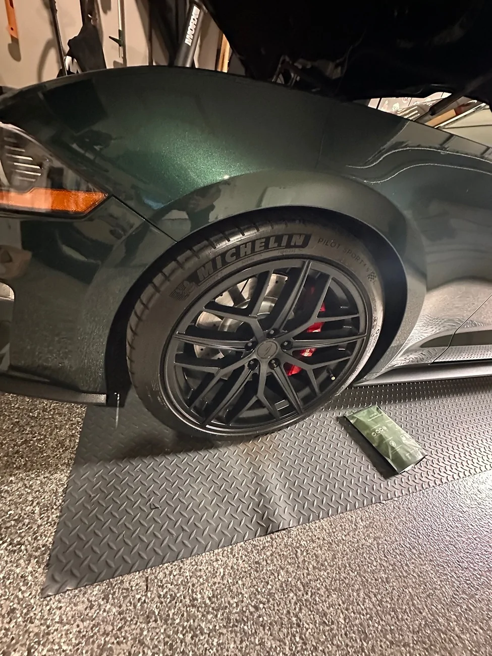

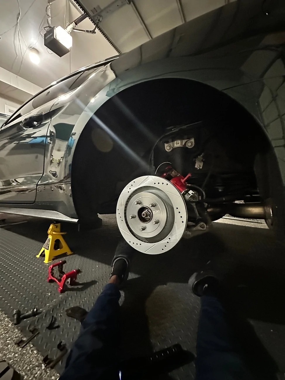

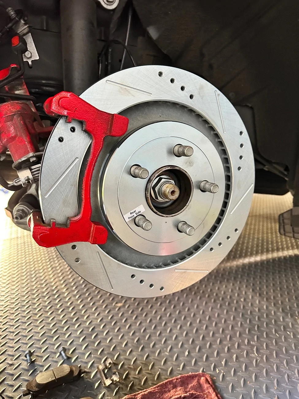

I want to go with the drilled and slotted rotor look on my upcoming brake job.
Just for the look, I know this won't increase my braking performance.
Who would you recommend as a source for the four rotors and pads?
