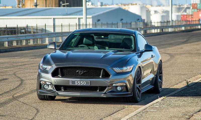

Fair enough. imo +15 offset is way too low
This is me on 20x9.5+30 with a 275/35 (front). With -2.2 camber the top tucks, but you have camber plates so you can play with the camber settings to get the desired look.
I'm not sure exactly how low I am, but even with +30 offset it rubs being this low. I do often drive hard though
+15 offset will sit more than 1/2" further out, will poke for sure

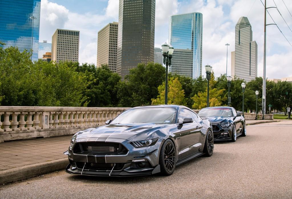

He might need a pic of your setup to determine whether there is poke. Subjectivity and all that.
I think your setup is dope btw, but too aggressive for me in the front. How badly does it rub?
Heres mine with 10.5 +25 up front just for reference, It doesn't rub at all.
So 10.75 +35 should be just fine especially with 275 and having the camber plates on coilovers also so you can dial it in a bit more negative. BmacIL is right might need small 5mm so clear inside, just have to wait and see. Look forward to pics bro, goodluck!
