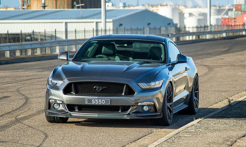

Fair enough. imo +15 offset is way too low
This is me on 20x9.5+30 with a 275/35 (front). With -2.2 camber the top tucks, but you have camber plates so you can play with the camber settings to get the desired look.
I'm not sure exactly how low I am, but even with +30 offset it rubs being this low. I do often drive hard though
+15 offset will sit more than 1/2" further out, will poke for sure
