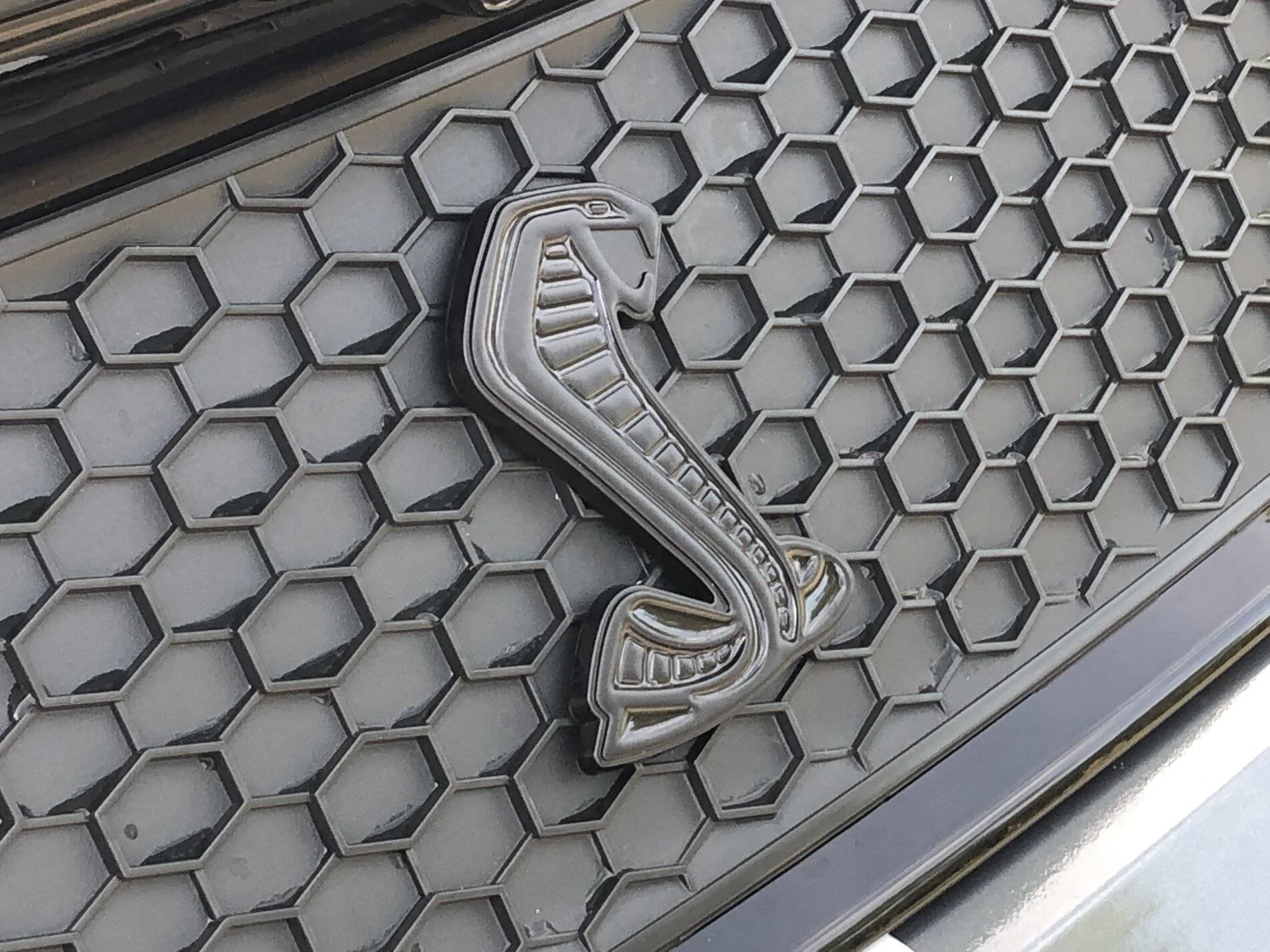

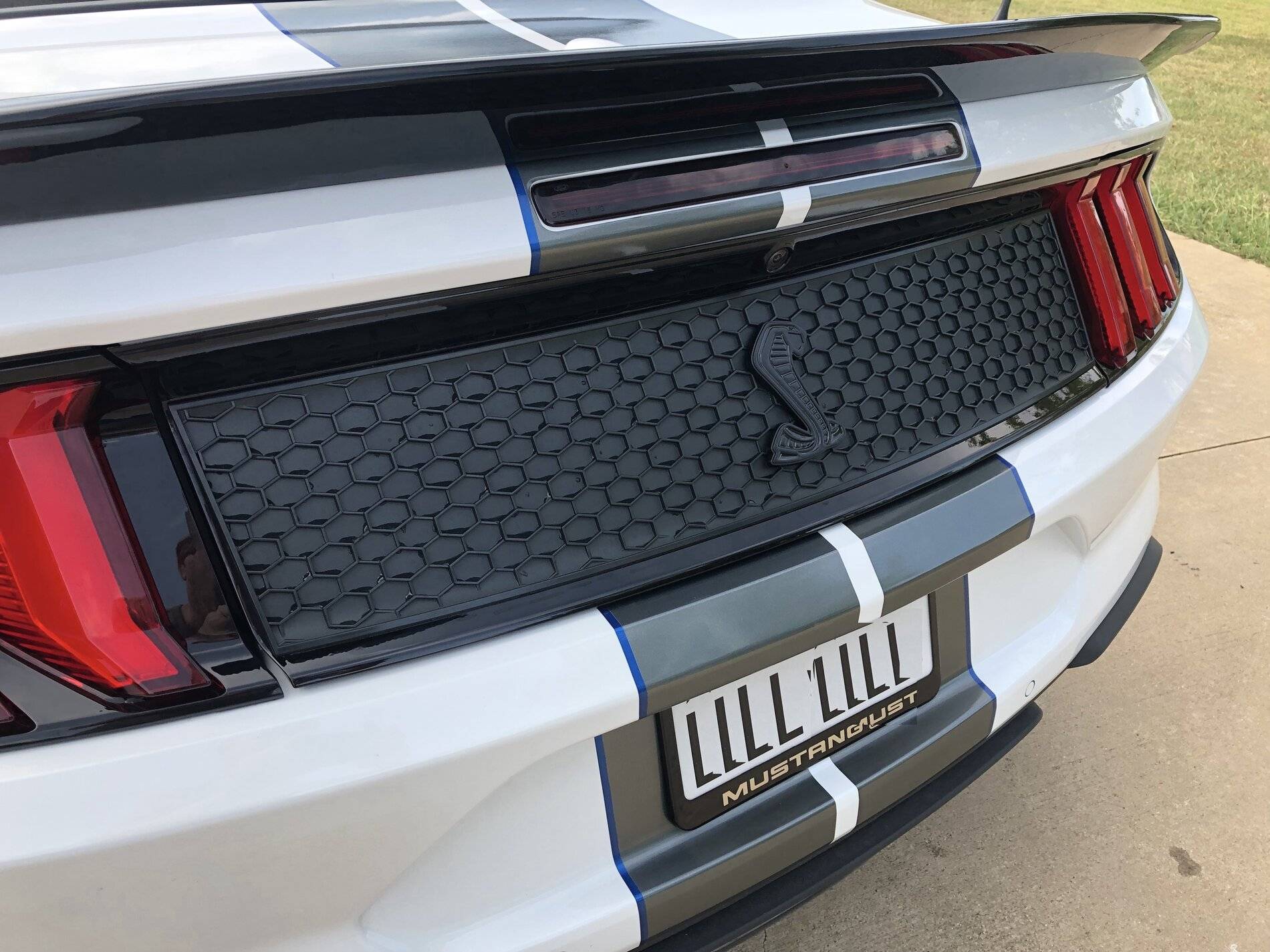

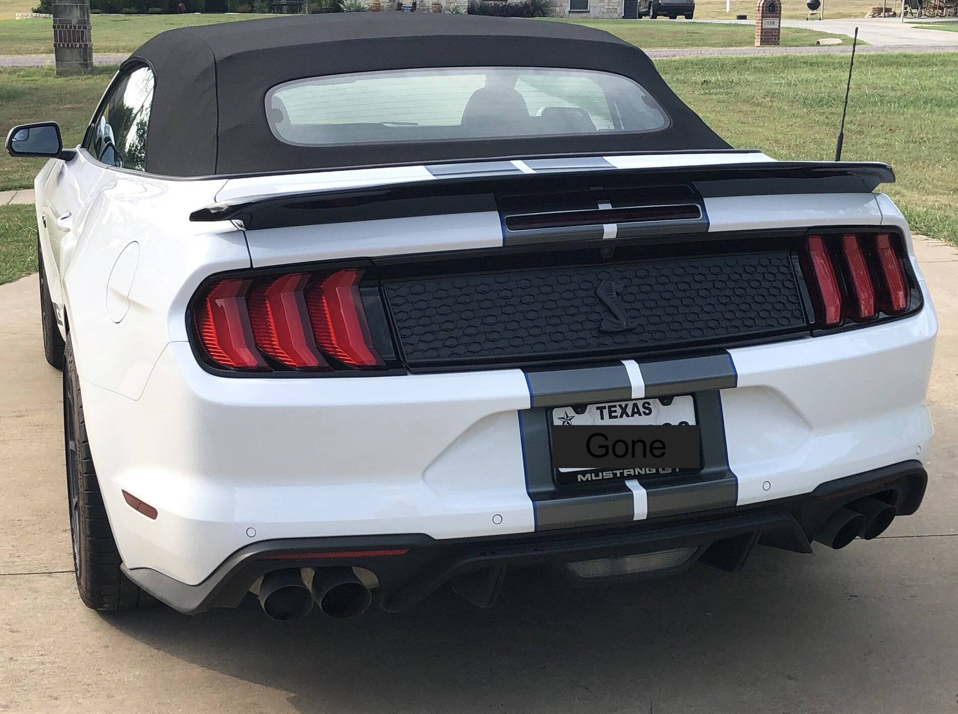

Just finished my rear decklid project.
- (1) 4.5" Cobra emblem from Asia (they come in ABS and metal - I found a metal one)
- (2) Stainless M5 10mm flathead Phillips screws
- (1) Drake honeycomb panel
- Used emblem adhesive backing with holes as my drill template from front of honeycomb panel (small countersink of drill holes with larger bit from back so panel sit flush)
