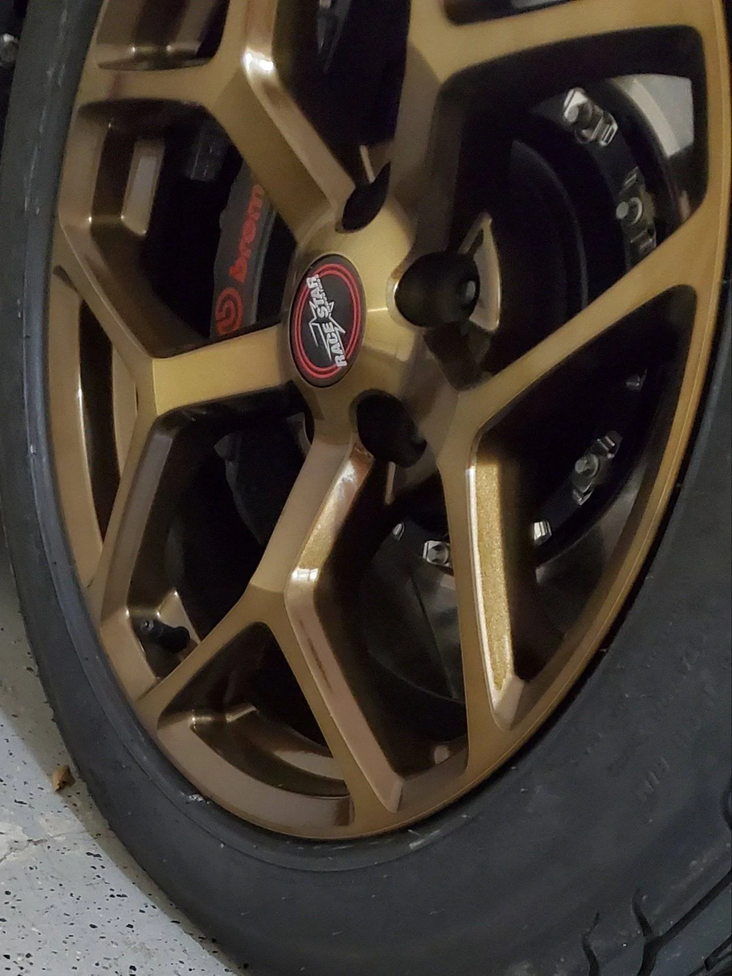

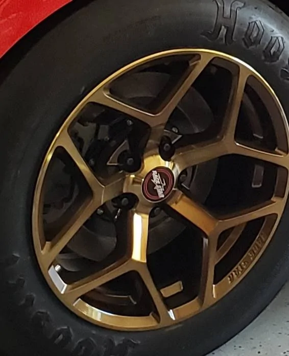

Race star drag pack on my car with conical style lugs....
I just put on a set of the 18x10.5 racestar recluse in the rear and used my acorn style lug nuts... seem to work just fine

My Recluse Race Stars use the conical style.
