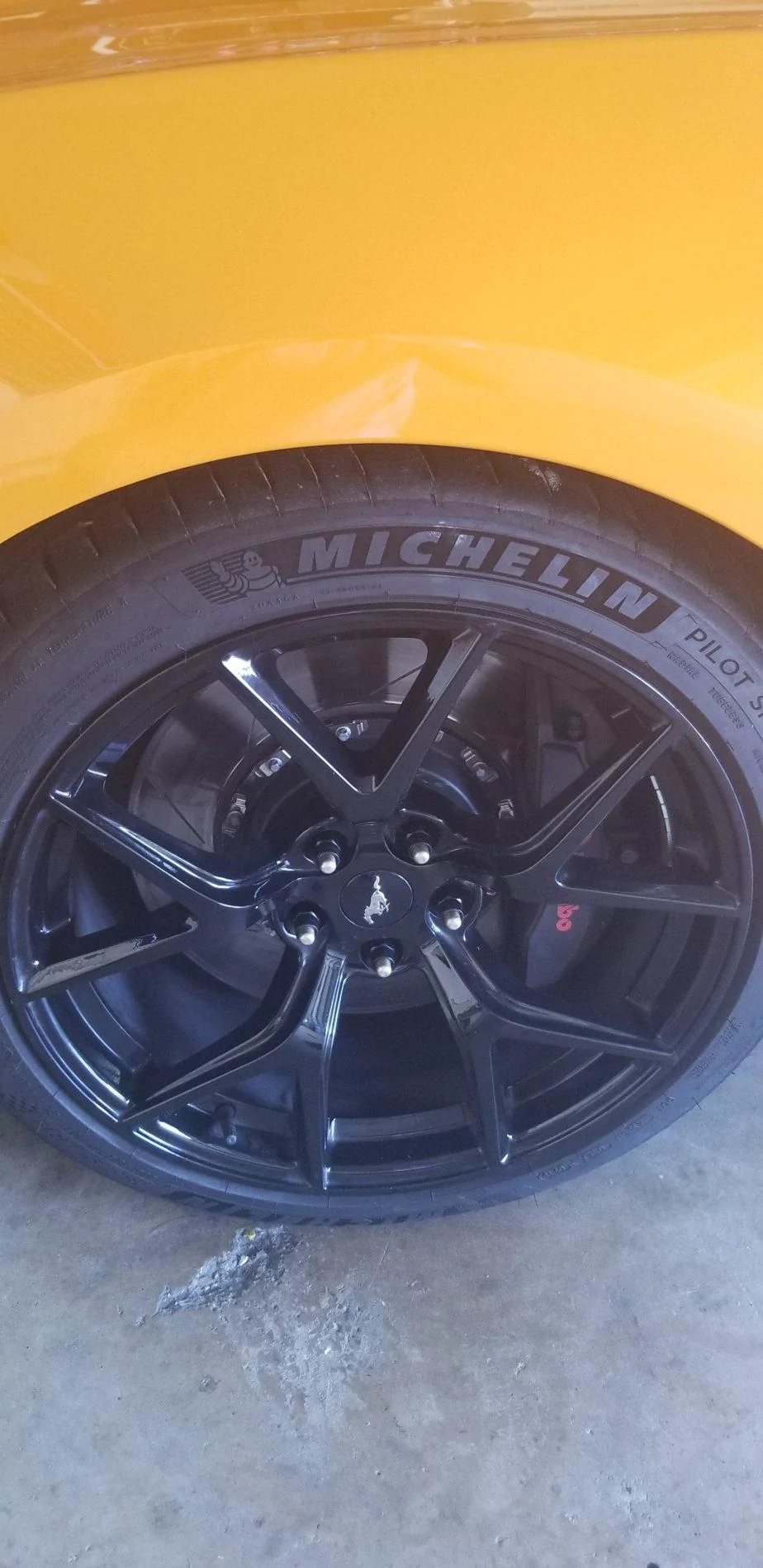

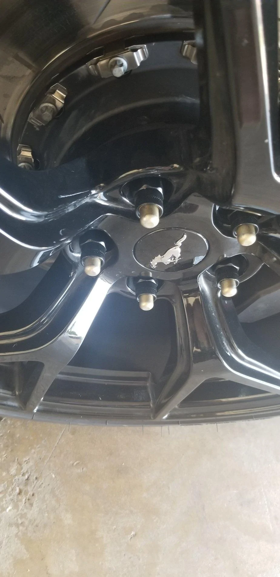

Picked up the monster lugs. They look ok, the smooth part of the extended lug sticks out on my daily wheels.
What torque specs do I follow. Monster Lug package says 90, but I've always used 150. Dunno if torque is dependant on the lug or the stud.
Also, my 19 mm impact socket barely fits the SVE lug holes. Gotta be careful insterting it or it will ruin the finish of the wheel. The 19mm key that came with the lugs is thin wall and fits much better.
