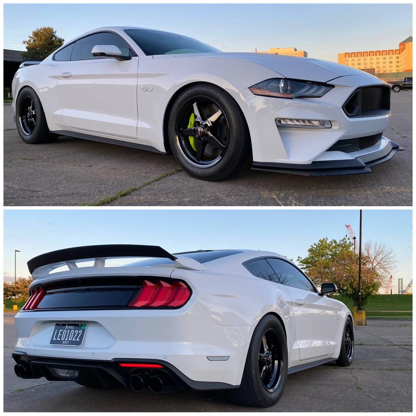

That may be too much. I’m on BMR drag springs. 1.2”fr and .5”rear. And drag pack sizes like you state but 18x4 in front. Everyday wheels 19/10fr-11r for stree with 325.

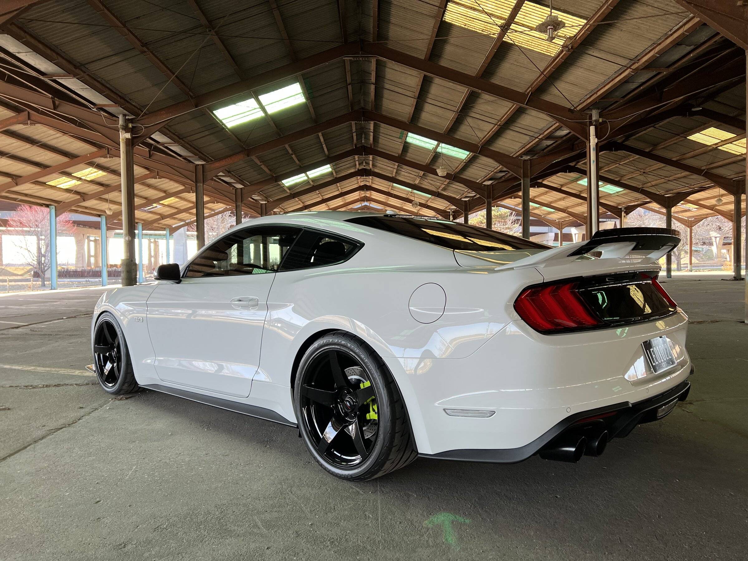

You‘ve got it looking right my friend! Nicely done.
