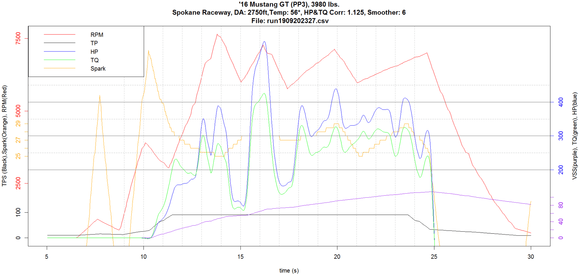

I've built a program that uses an OBDII scanner to determine HP & TQ based on acceleration. It accounts for air resistance, which makes a huge difference in 4th gear, but I'm not at all confident in my guesses of Cd = .355 and more importantly Frontal Area, which I used 25 ft^2.
I think the Cd is in the ball park, but the Frontal area might be on the low side (originally I used 26 ft^2). A fox body LX Hatch is 0.36 & 21-22 ft^2. A Crown Vic is in the neighborhood of 26 ft^2. So, I put the S550 dead in between them. I think the S550 might be just as big, though. They're both big damn cars when you're looking from the inside of a Fox. Anyways, look how close I am... I really wish I could put the cherry on top of this one:

To the other guys, the only math I see in this thread is taking 3% of a proposed Cd for the S197 that I haven't been able to confirm from an official source. There's absolutely nothing regarding frontal area. Trying to do a top-speed run is a ludicrous approach as there are too many variables to account for (wind speed, altitude, air temps, humidity, rolling resistance, actual output from the engine, etc...) to get anything approaching accuracy or precision. I can and have done all that math in the graph above, but it's meant to measure power, not take it as an input. Frankly, I have more faith in ball-parking Cd & Frontal Area as we already have than trying to calculate it in this manner.
