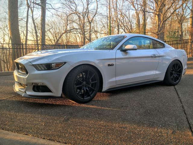

That is correct. The included springs are still progressive. Linear springs in my opinion perform better on this car. In addition the Steeda springs dropped the car another 1/2 which provides a more aggressive stance.
Here is a pic.
What size tires are you running on the M350's??
