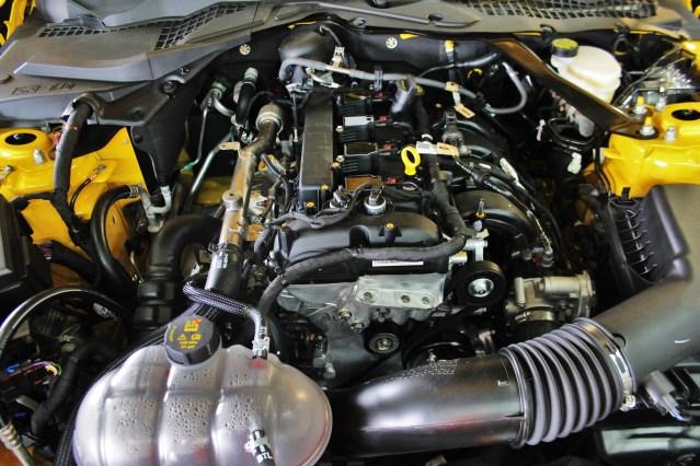

I can do more than just show one installed pic :) I finally made the time to get the fittings in correctly.
Here they are as I originally installed them. At the time, they certainly felt tight despite a lot of thread showing. However, after driving the car home I could wiggle both of them back and forth. I think they were still sealed to the can, but loose = bad.
I couldn't get the hoses off easily with the can in place since the fittings were so loose, so I removed the can from the mount which gave me a little more leverage. I removed one of the fittings and put a bit of Teflon tape around the outer thread, screwed it back in hand tight, and then gave it a couple of revolutions with a wrench. Big difference:
Here is the can back in the car with everything tightened down:
And finally, here is the end of the hose that attaches to the intake manifold. This is of course the easier of the two ends to find, but I'm not about to get back under the car to find the other one again :D Still, I hope this helps someone as I couldn't find this one at first either:
I'll also note that while I had the can off, I opened it up and it had an oily film inside already after driving the car with it on (and loose fittings) for 90 miles. Thanks again for the good price :)

Looks great! The tape should not be necessary. Being it is already installed, I would not worry about it. Nice job with everything and thanks for posting up your shots. Let us know what kind of fluid accumulates after a few hundred miles.
Thanks!
-John
