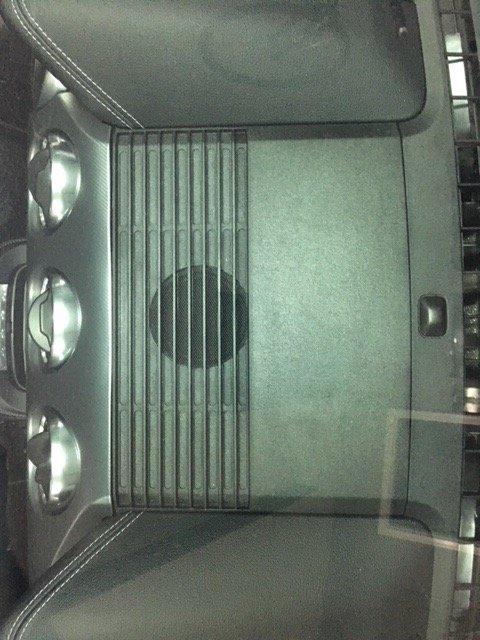

Does anyone know how to safely remove this trim piece?

For clarification, talking about the vented piece with the speaker, center of the dashboard. Mine is rattling and I must tape the ever-loving shit out of the bottom of it.

1 would imagine that you would need to remove the brushed aluminum dash accent that the vents protrude out of first ... pic a warm day . Use plastic upholstery prying tool .

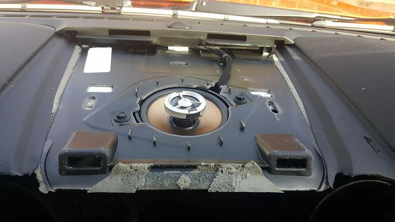

To go 1 minute on this video.
[ame]
Then pull up and back on the grille.
20161216_114942 by chefjpd, on Flickr
You might want to replace the crappy factory speaker while you are in there.

I removed mine to add a gps module to my head unit. It seems sketchy, but you just have to give it a good pull.

i've done this 3 times and every single time i end up slicing my hand open on the plastic or something :lol: you really have to give it some beans and usually end up smashing your hand against the windscreen :doh:

It's a good idea to put some foam in-between your hand and the windshield. I've witness someone cracking their windshield taking that off. It doesn't come off easy.

Alright got the first 2 pieces off (dash applique). The big piece sounded like it broke eight thousand times while popping out those clips, working on this car makes my anxiety shoot up. Just have to remove the main offender now...I'm recovering from a sinus infection so I still feel a little loopy and uncoordinated so we'll see how this goes.

Polk db351 worked well for me.
+1 on that. The install is a little bit of a pita on non PP cars because we can't under mount it the way chef did. I ended up grinding down the grill a bit.

I haven't looked at mine, but I expected that the metal clips into which the 7mm screws go would have been on the edges of the opening as opposed to the speaker. Isn't the OE speaker screwed onto the plastic? rather than the screws being threaded through the plastic and into the speaker(?)
