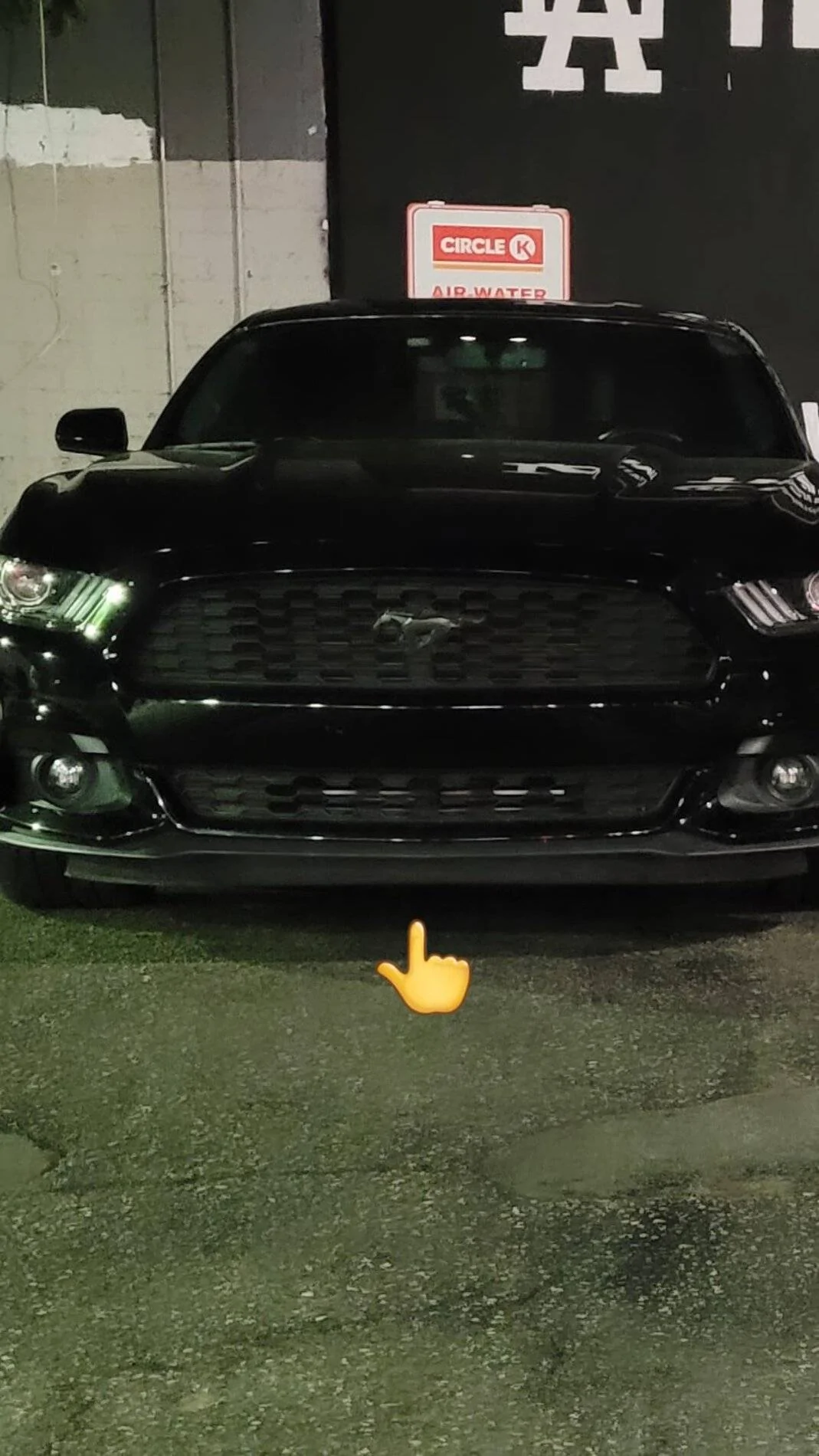

Does anyone know what this is??

It rubs on everything and no other Mustang I've seen seems to have it. Is it something that I can just pop off myself?

It’s a air/debris deflector thing. I can’t remember the actual name. It’s rubber or hard plastic. Most cars have them now.

You think I should take it off?

It’s for aero, I think it said (on a Ford generated video) that the GT’s and EB’s have a different shape and it gets dropped on pp1 upwards as they use the airflow to direct at the brakes.

Might as well remove it as it is already destroyed. But I do believe that the front under tray attaches to it. So you should bolt a new one on

its an air deflector and standard for all non PP cars (improves MPG). PP cars get the recessed air ways for the brakes.
