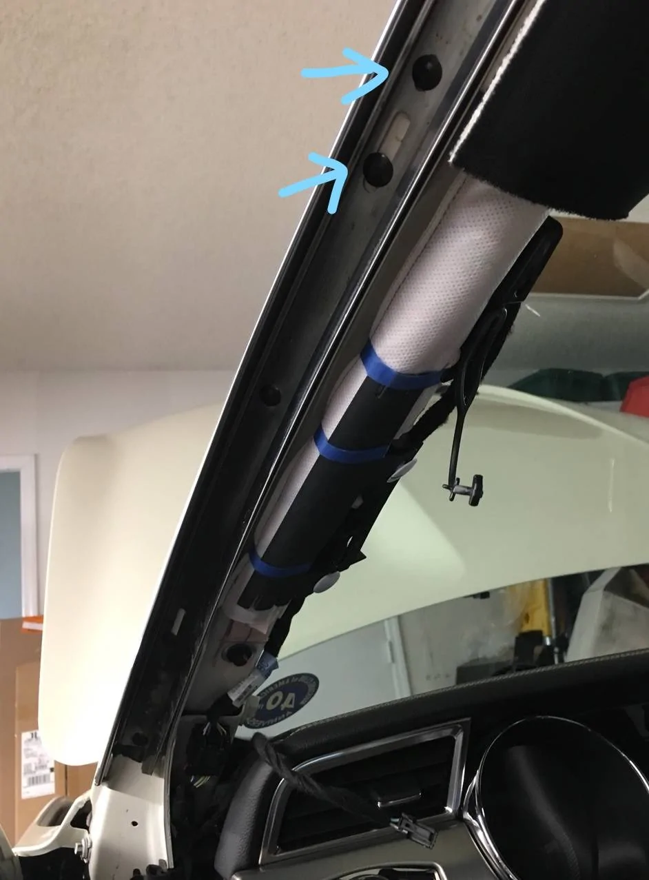

Just asking, but do you think the buzz/rattle is above your head? I would bet anything it's the side curtain airbag harness/canister if so.
I had this on both sides of my '20, on the passenger side I removed all the interior trim to lower the headliner a bit (including the seatbelt) and I stuffed fuzzy furniture wafers, double stacked, up in between the side curtain airbag canister and its harness. That was a lot of work.
Then my driver side had the same noise, and I thought what if I just used a trim removal pry tool or two to pry down the headliner enough to insert those wafers?
Well I did that - pulled back the rubber trim, inserted plastic trim removal tools, gently moved/inserted more till I had enough space to get in there, was able to eliminate the noise without ripping it all apart.
This definitely solved my rattle/buzz that I had for the past two years.
Are those pins I drew arrows on known to be loose or not pushed in all the way? Maybe this is causing the buzzing I hear on the freeways on driver side.
I do not know that sorry!

Where did you find a step by step on how to properly remove the weatherstrip and side curtain areas? Basically the exposed areas in the pic. I'm assuming everything can be safely removed and put back snug, including the weatherstrip?
That I can't answer as well, I was able to apply all my fixes and get at those areas without removing the weather stripping. I don't think it's at all necessary tho I read some here who did remove it.
